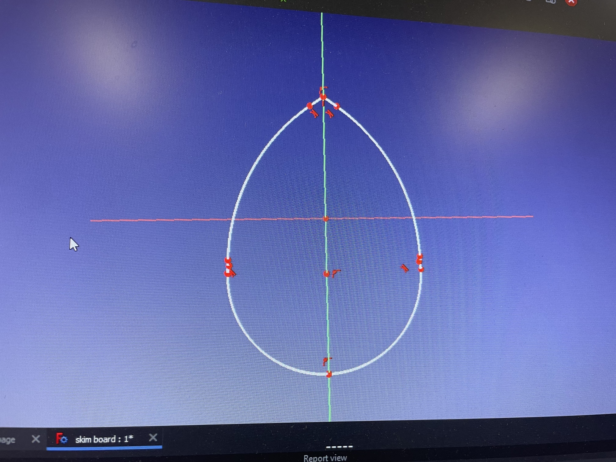

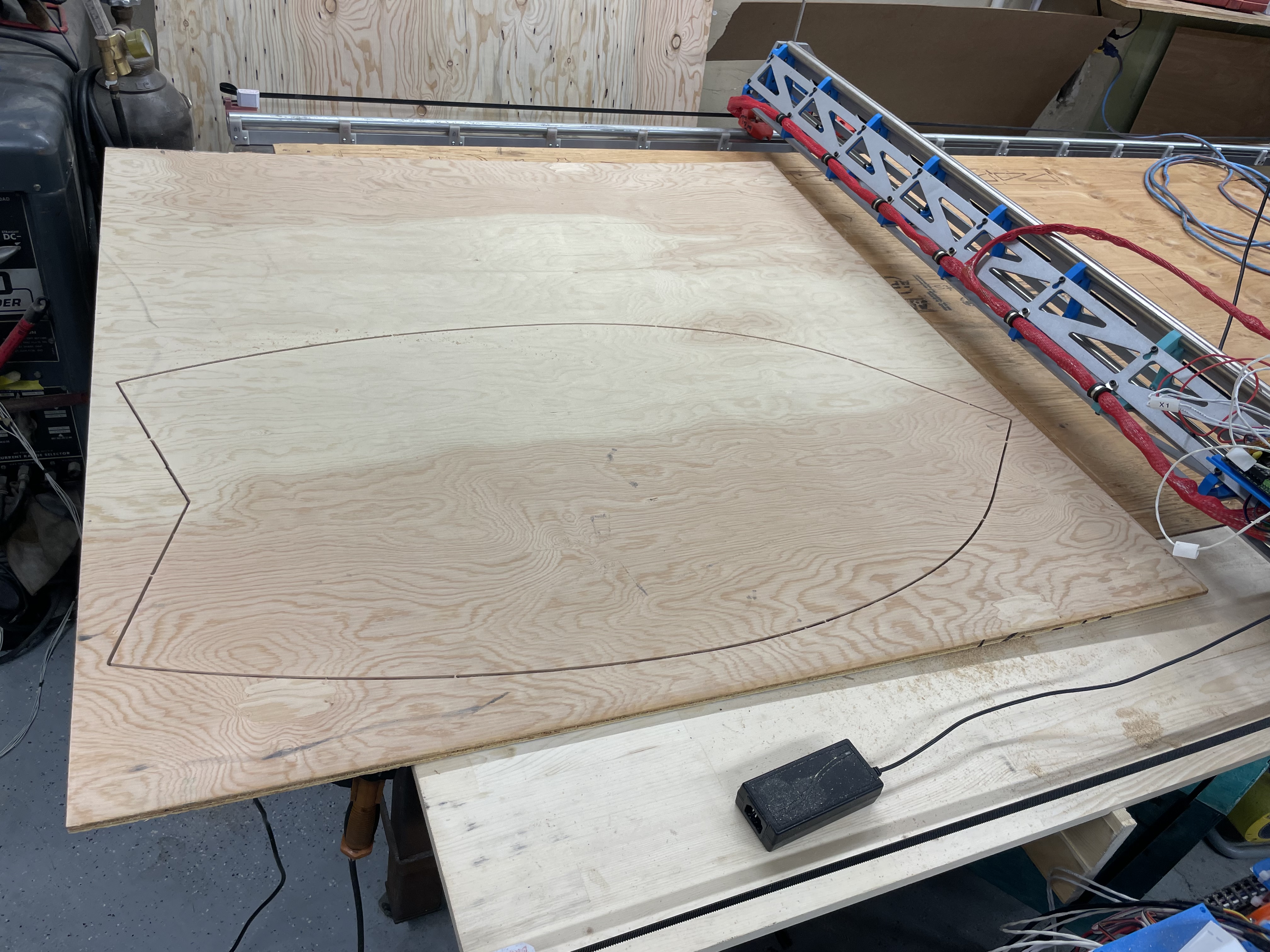

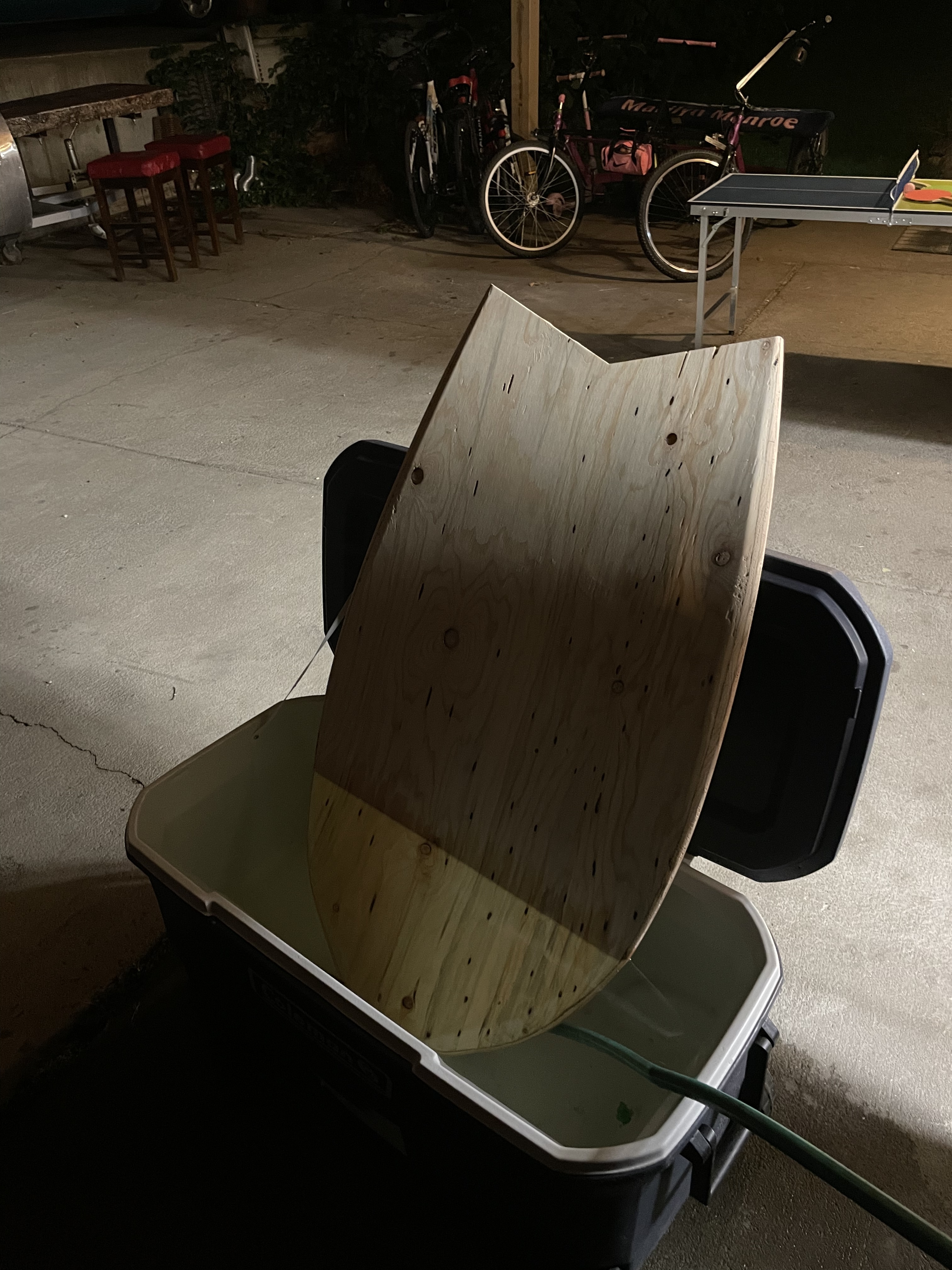

I am going to try and use the lr3 and make a simple skim board for my nieces Bday. i have picked up some good one side 1/2 plywood. They didnt have good both sides. its actually pretty decent. So here is my plan as of now lol
Choose one of the designs i have made or alter one if someone has advice. I have only made Fish wake surf boards before out of EPS and Epoxy.
I was going to soak the nose and add some rake to it as well as the tail ( i know the from is needed but i am not sure of the tail if it should be as well.
The niece is 5’2" and about 100 lbs so i was going to go somewhere around 4’ and some wehre between 30-40 " wide.
this is a ratio as each design has different lengths to width.
I was going to paint it in acrylic white, then epoxy coat it, i have some nice light weight fiberglass i could add a layer to top possibly.
Any ways i know there is some surf dudes on here and a whole bunch of brilliant minds so just bouncing some ideas. I am going to be hopefully cutting it in a couple hours. also i was wondering about machining some designs in but that would take the stregth away. also thought about doing some minor cross thatching for some grip on the top.

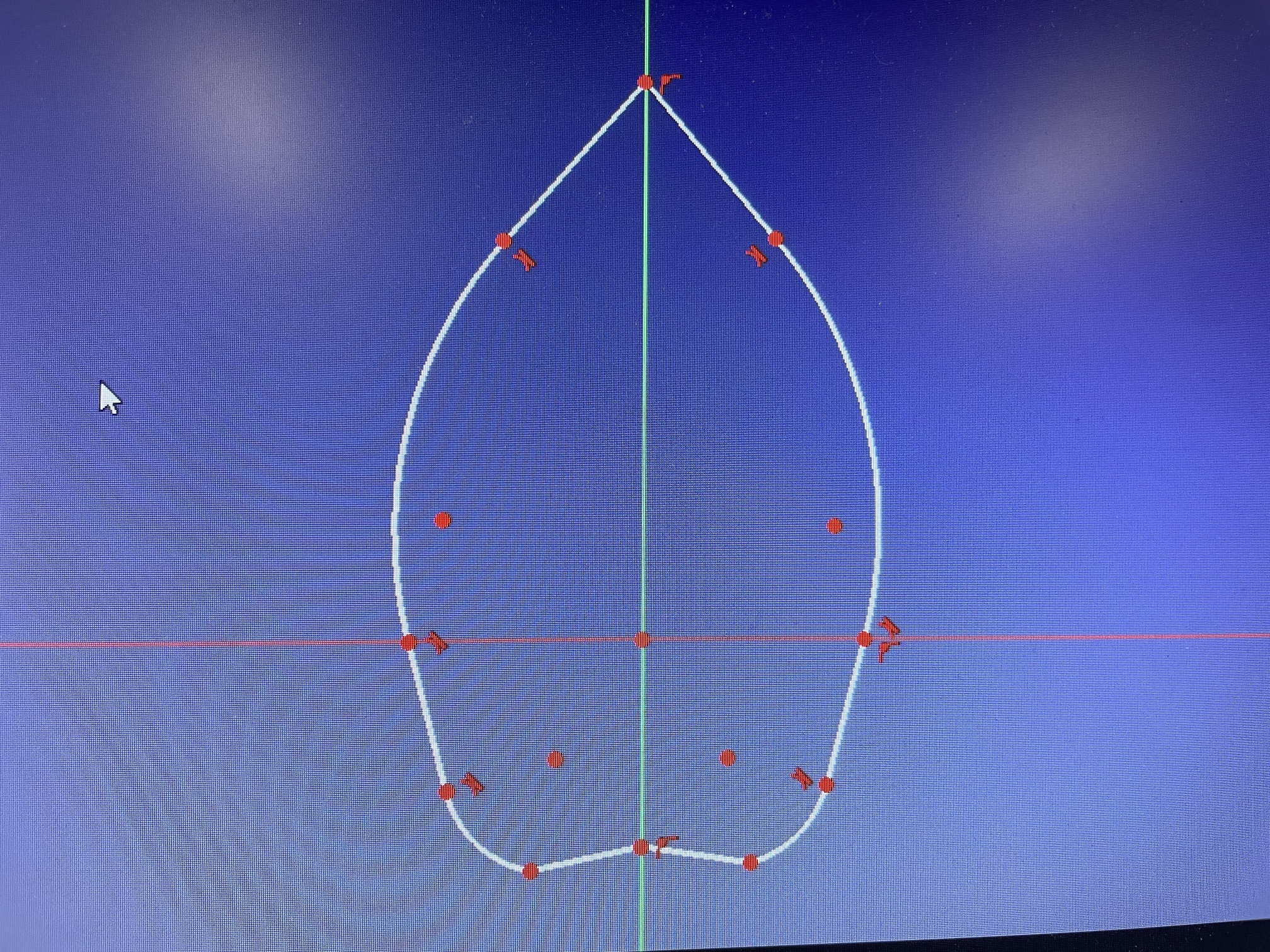

skim fish 2 -Body.dxf (5.0 KB)
skim fish-Body.dxf (5.0 KB)
skim board-BodySketch.dxf (8.4 KB)
Plan would be to use it to skim surf and also wake surf.
Skim fish 2
Skim
Skim fish

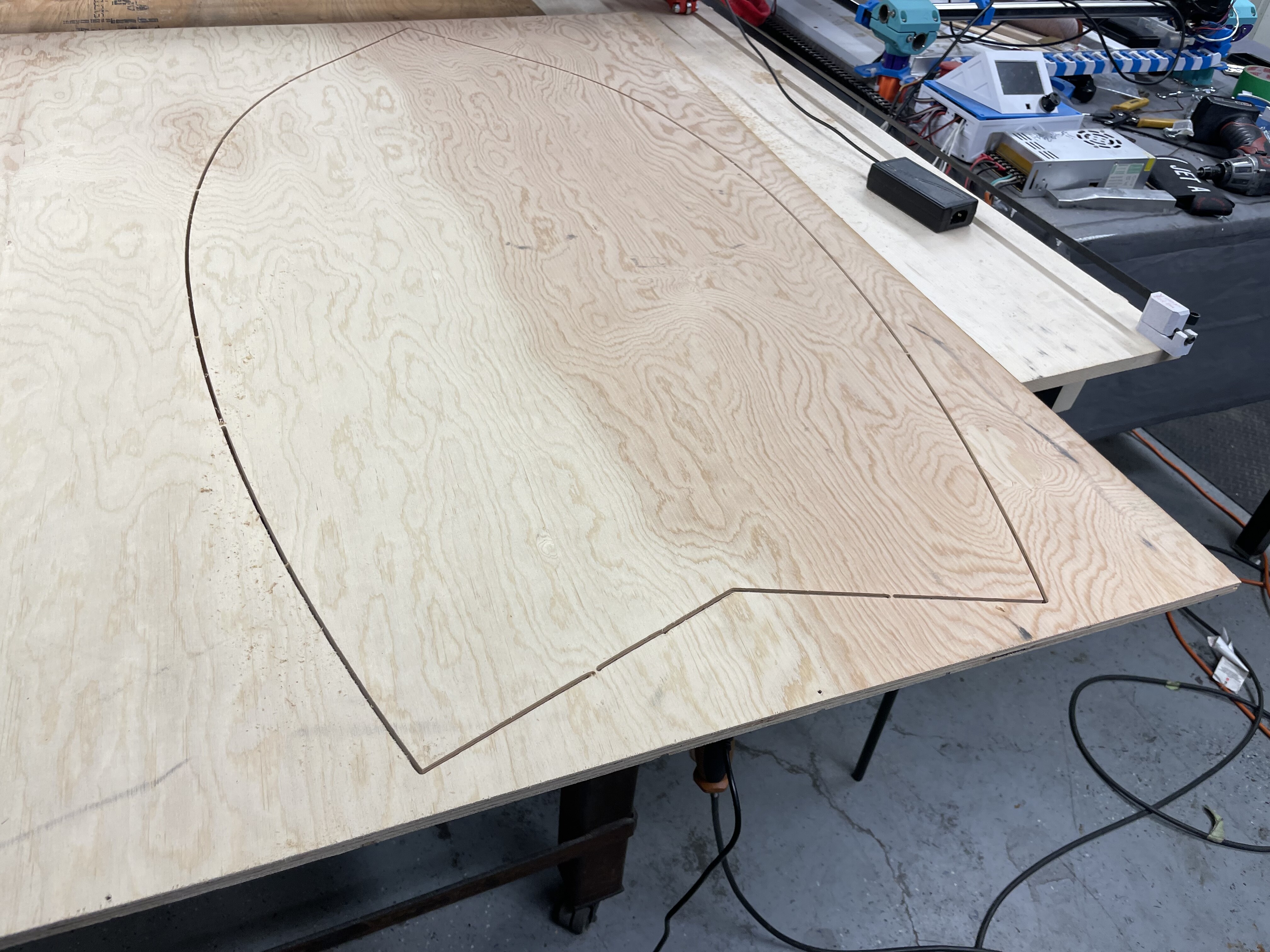

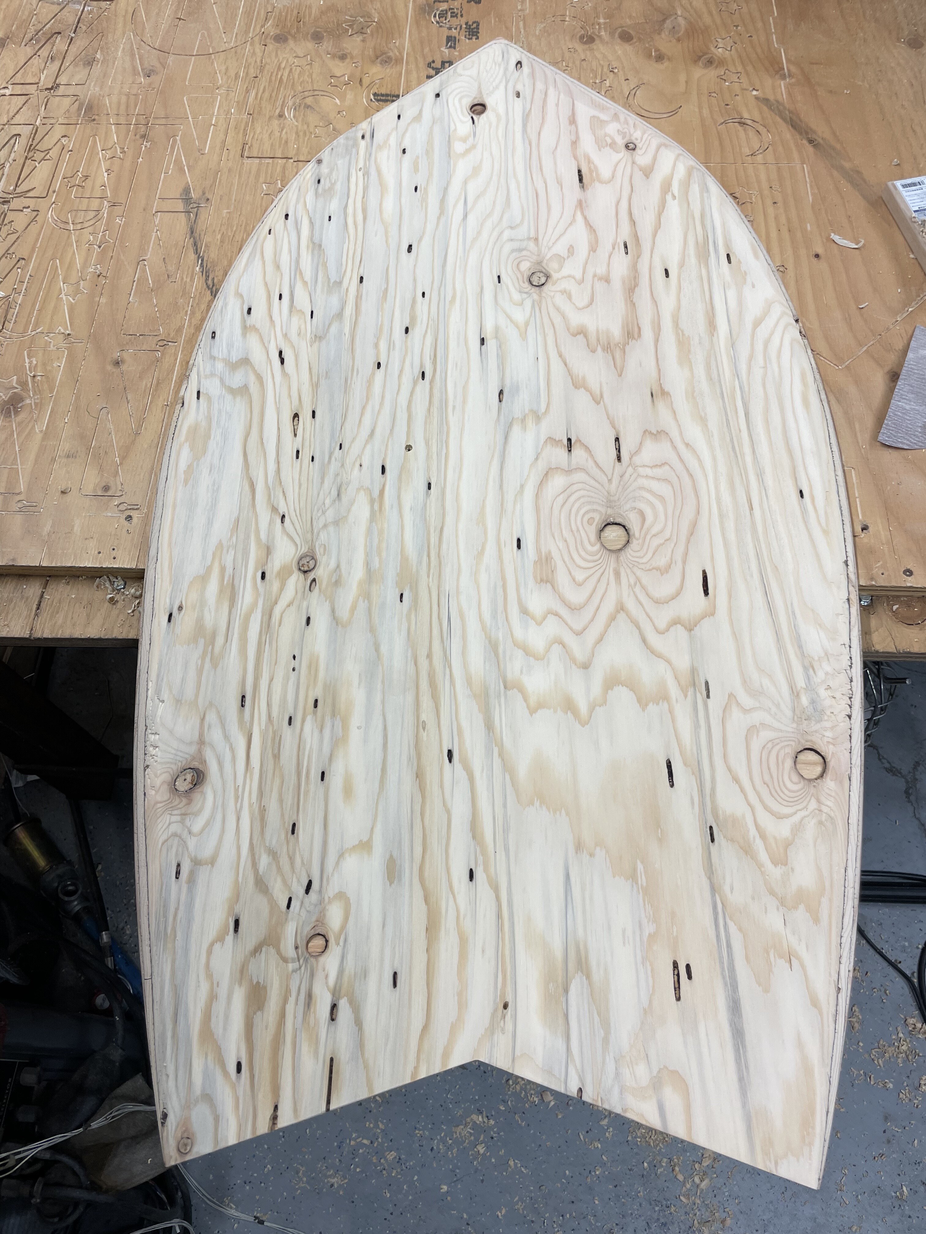

Well that’s pretty cool to hear I had a couple issues with my feeds and speeds but I got the fish cut out. So much fun!!!
I have not had the pleasure to surf a actual natural wave before :(.
One day I will for sure, I guess the whole skim thing is in the shallows so you have to really watch and be careful !!
So much nicer to just be able to g28 and carry on at the start after a mistake etc.
Neat natural color
Nice edge I think

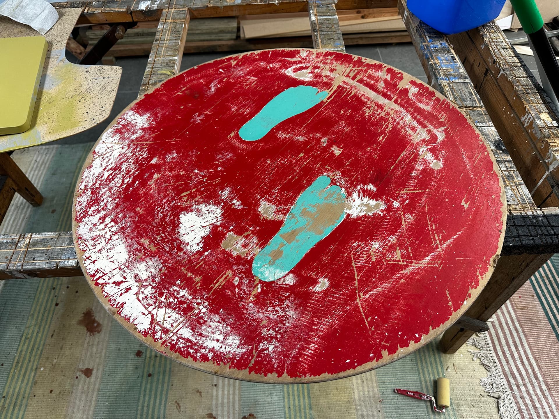

Here’s mine from sometime in the early 1960’s. Those are my cousin’s feet. 30" diameter (before Australia went metric) and 3/8" ply. The production ones were 28" and the difference in performance from the extra area on this was astonishing! This thing did a lot of miles!
Thanks for the memories! :smiley:
Now I have to put everything back in the storage cupboard - and I’ll hang this on the shed wall.
Oh man that’s sooo cool is it like a bit of a bowl ?
It’s hard to see in the pic looks like it was so much fun.
So freaking cool!

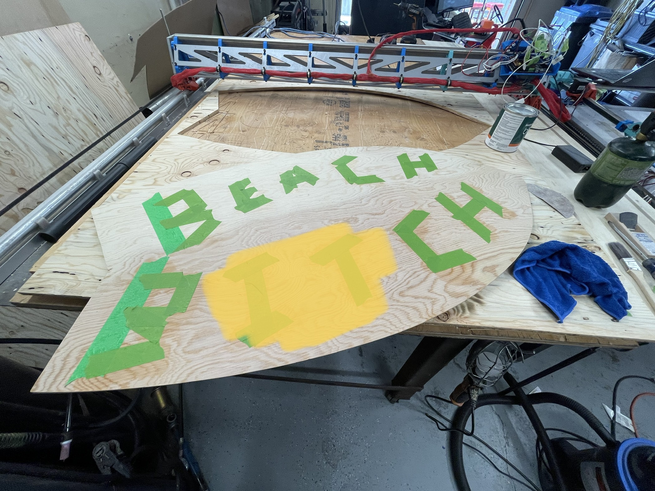

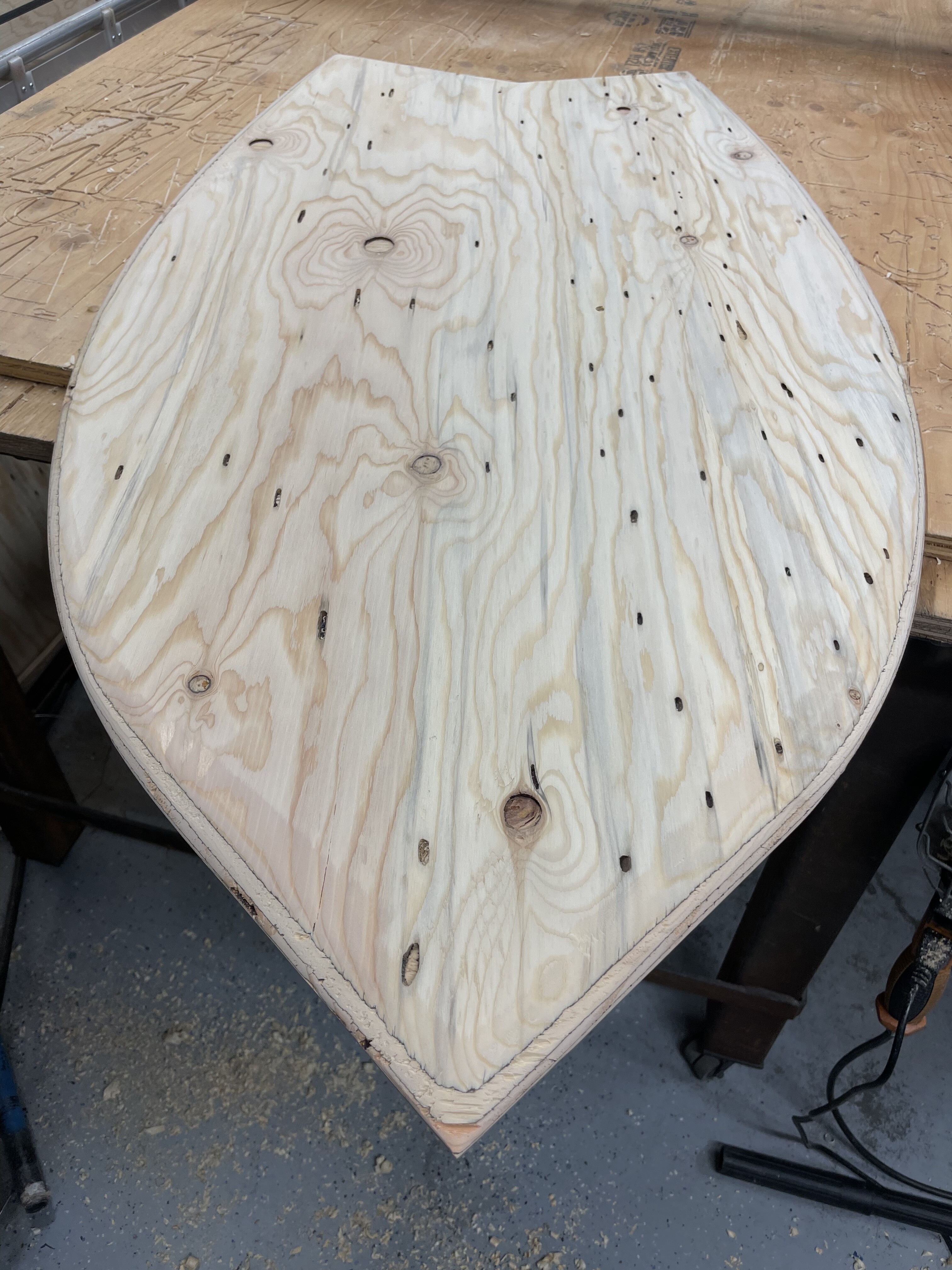

Had to pull out the Japanese plane aka Mitsubishi zero lol.

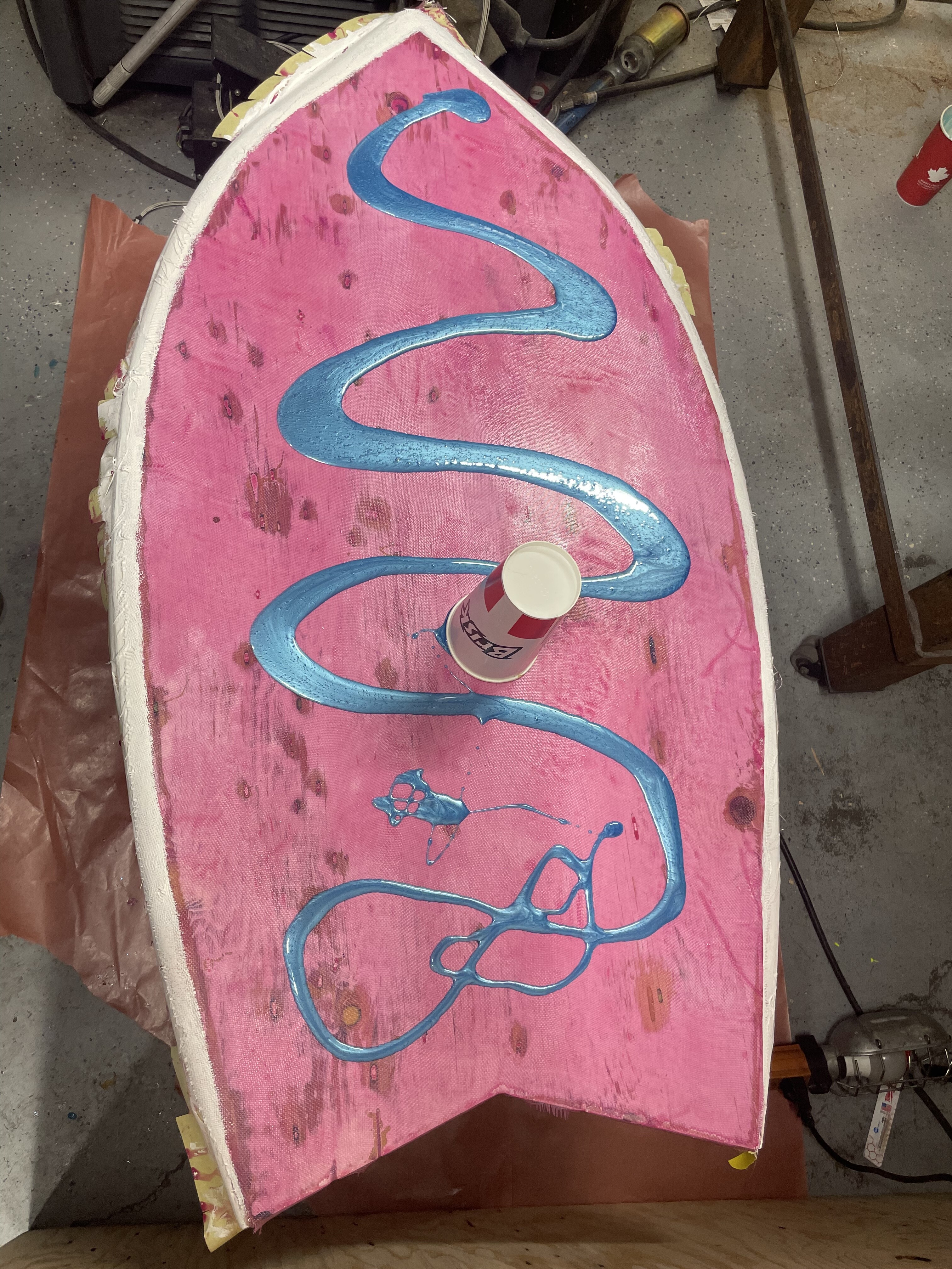

Did some rail shaping and soaked it and have it being intricately clamped.
I am wondering if I should add a layer of fibreglass cloth to the top. The bottom is so nice and flat I don’t want to mess with it just flood coat it. So indecisive
Also I hate the nose and I think I will blunt it off
No shape at all, just a flat disc. It was very fast in the thinnest water you could find, not at all steerable though, and no chance of a re-entry off a wave!

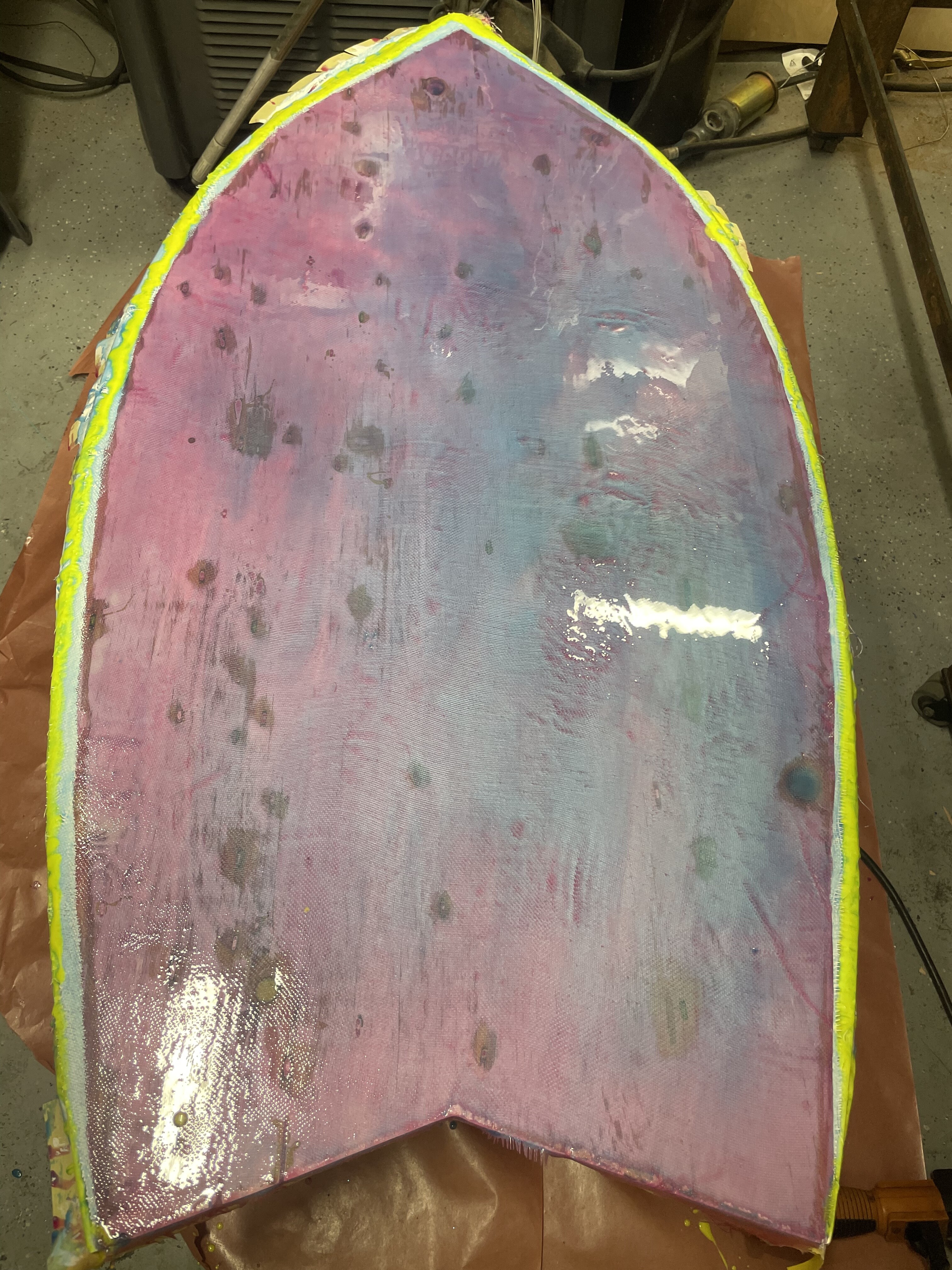

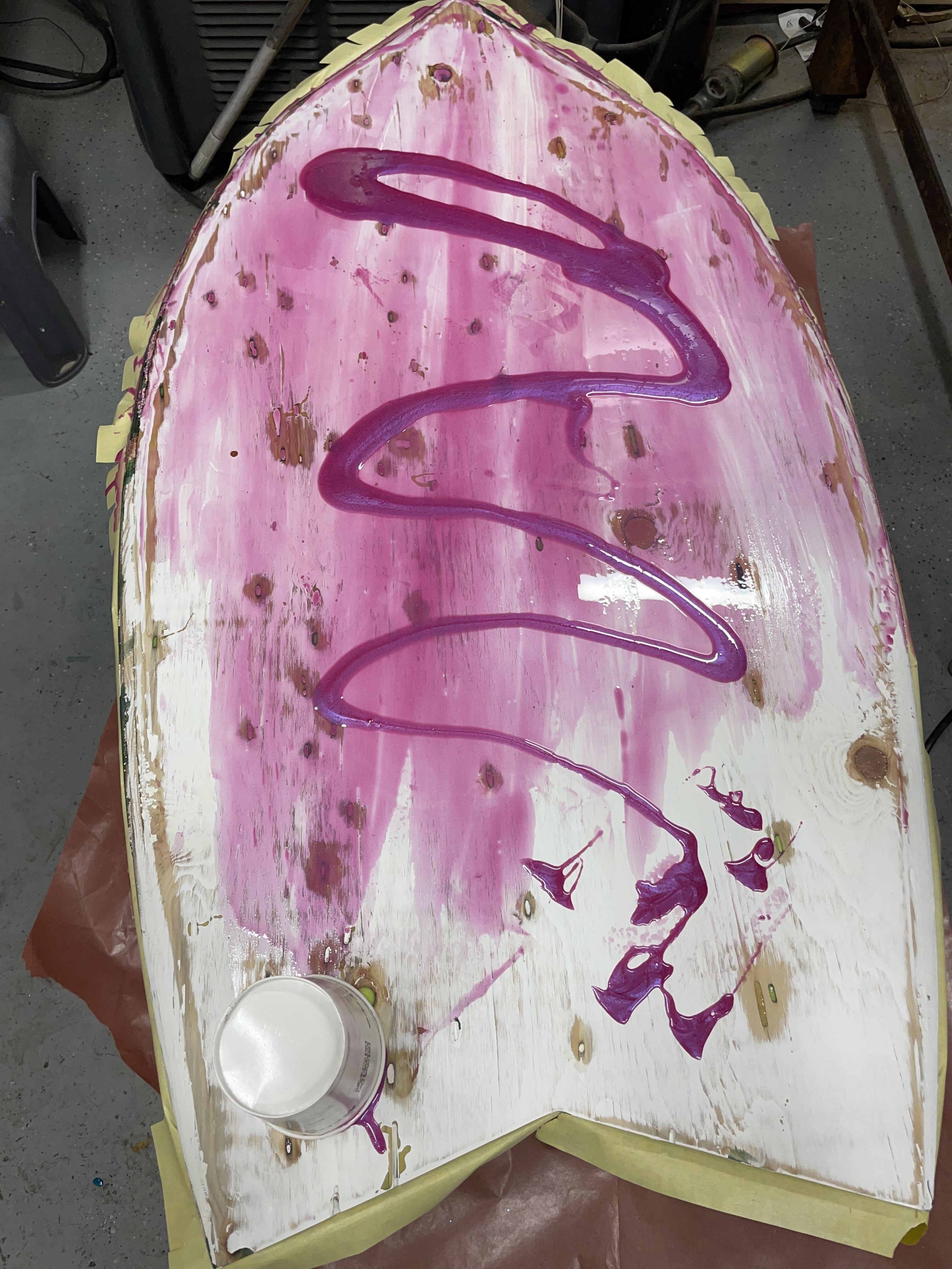

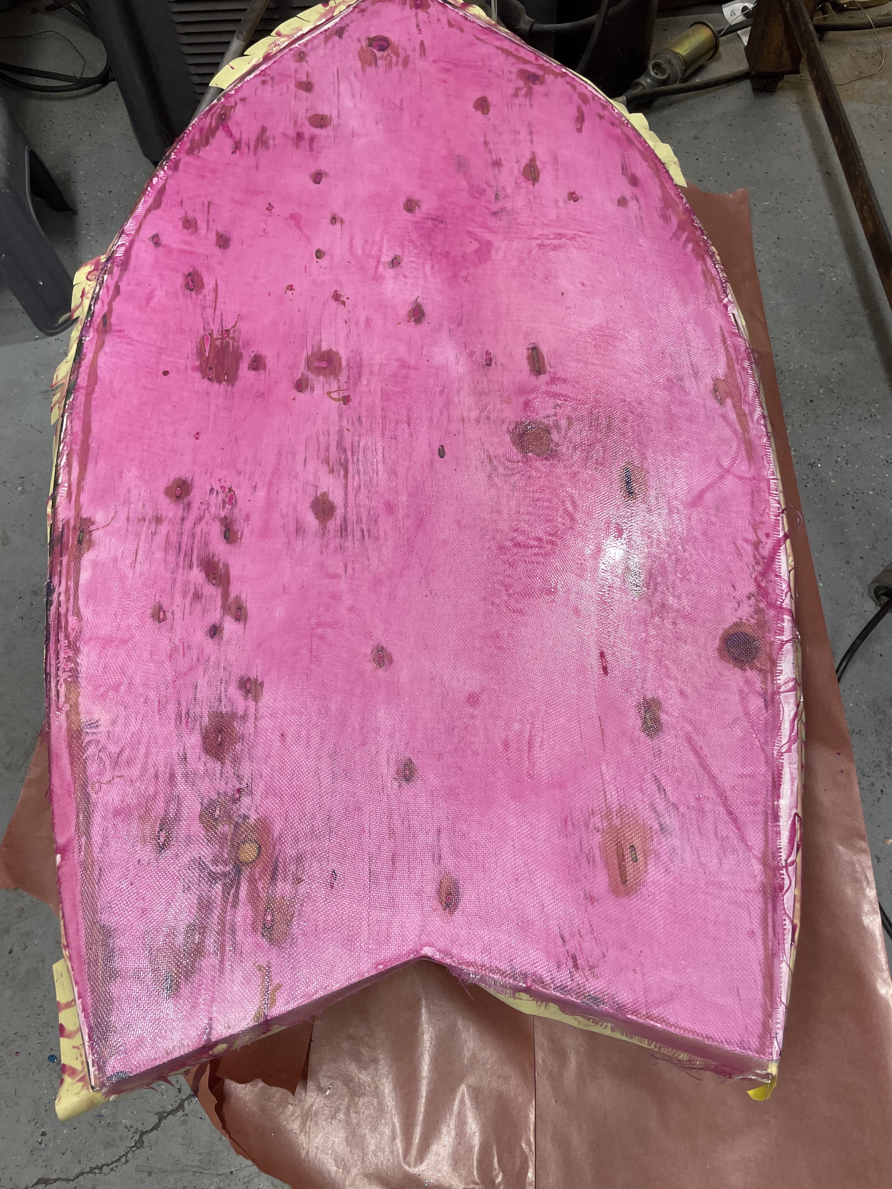

I added one sheet of cloth to the top.

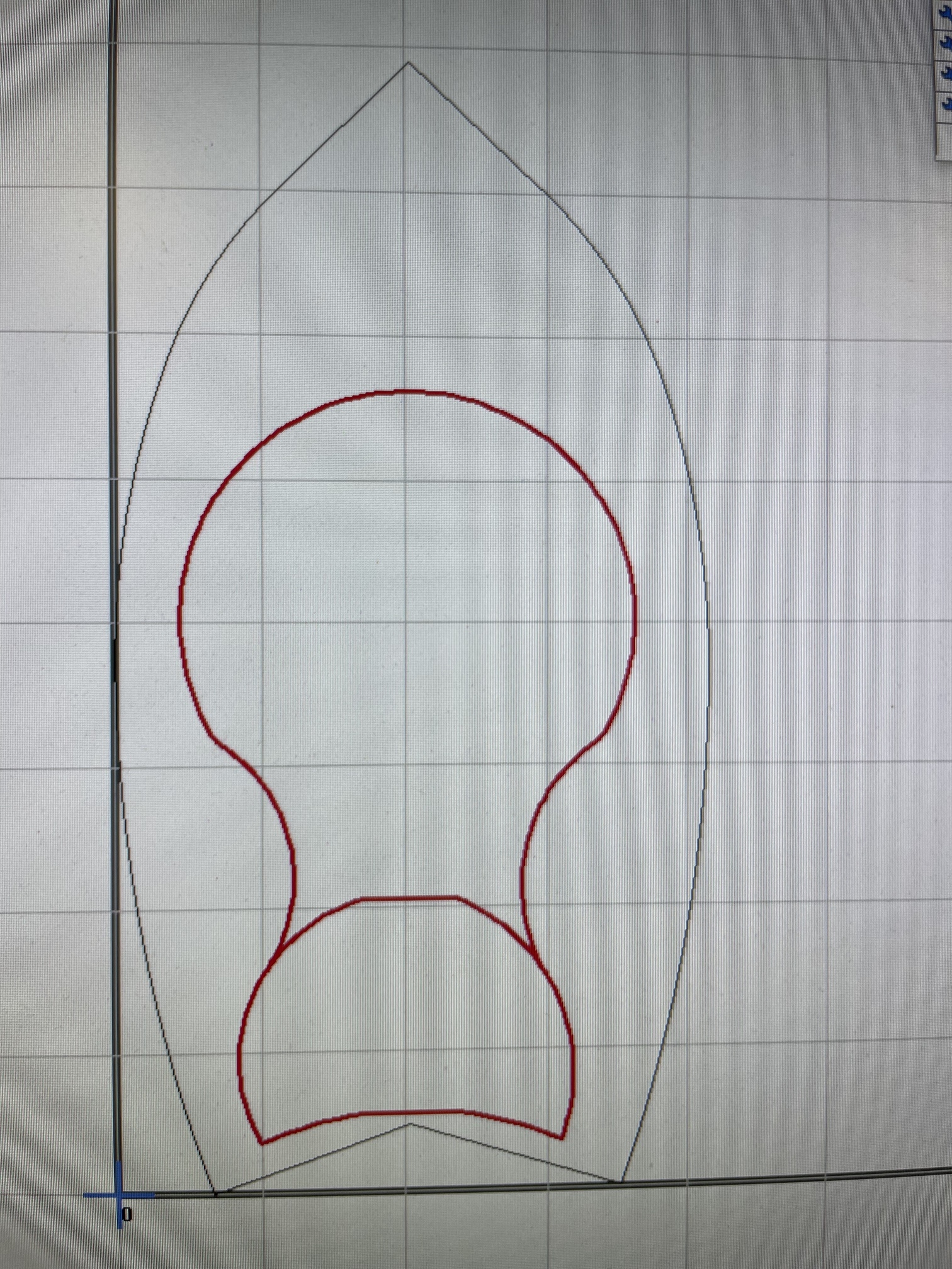

Tonight’s job will be attempting to Cnc some foam track pad for a grip top.
I wish I could figure out 2.5d carv so I could take this 6mm pleeted Eva marine foam and make a kind of tapered heel grip. This is the design I am going to try. I might just knock 3mm off the front section and leave the back full 6mm
Maybe do some cross cuts to step it up.
I’m no expert, but I’m pretty sure that would be dead simple in KiriMoto - just import the STL, hit “countour” and lie back and think of England! :wink:
