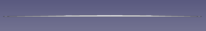

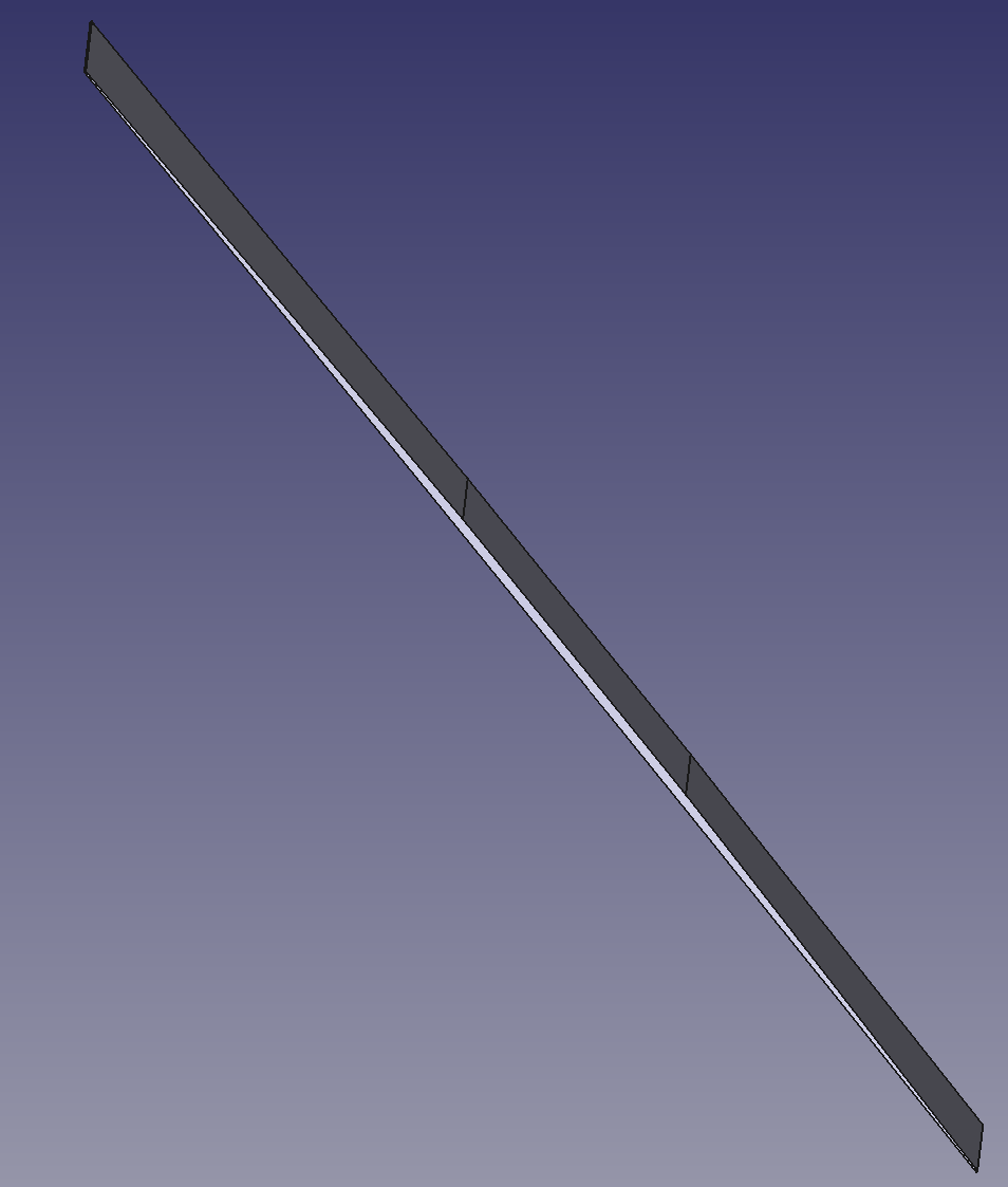

As you might know I use the LR4 mainly for ski building.
The typical workflow I use is:
  • cut out the core. I use a 6 mm endmill bit
  • glue the sidewalls to the cut out core
  • plane the core with sidewall to desired height. I use table planer for this.
  • core profiling

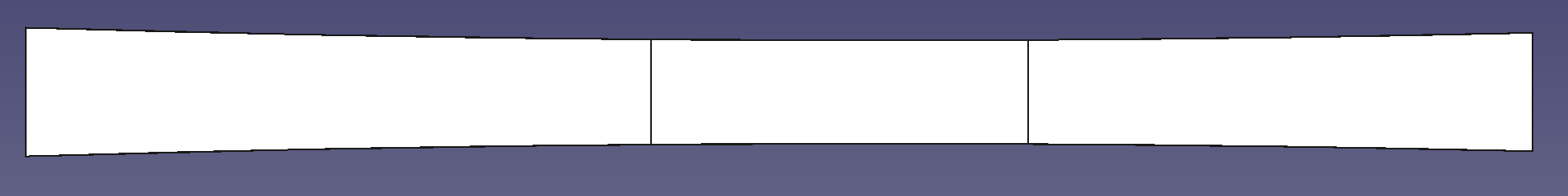

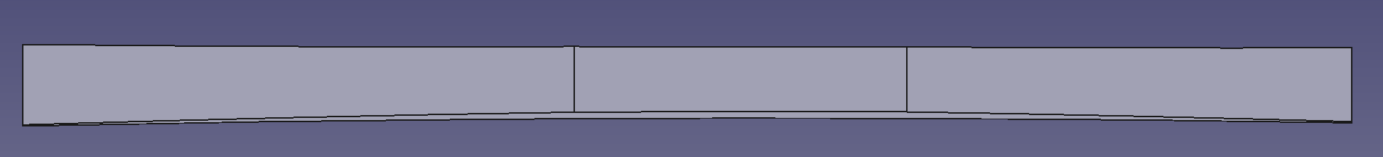

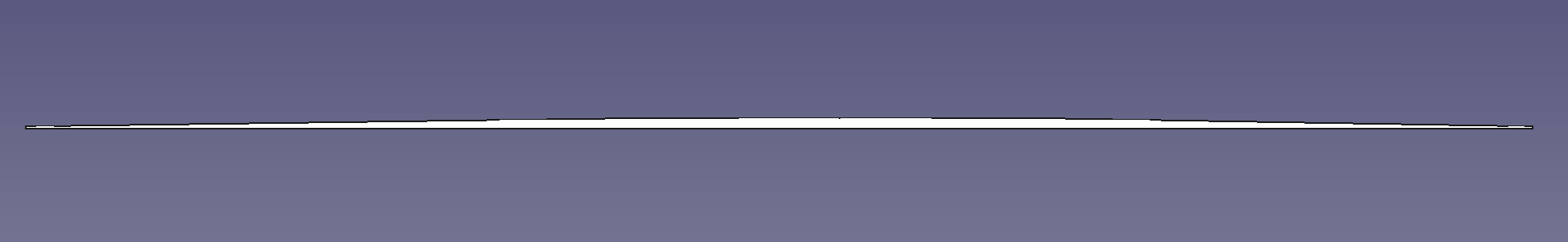

The core profiling is the tapering that goes from the center of the core to the tip and tail. I typically have a 40 cm region in the middle of the core at the maximum thickness (10 to 11 mm). the tapering then goes down to 2 mm to the tip and the tail. Right now to do this I use a hand planer mounted on a jig. I set the angle and I slide the planer until no material is removed anymore. With this method I have a straight tapering.
I would like to try with the LR4 for two reasons:
  • precision
  • possibility of doing convex/concave tapering
What bit should I use? The LR4 is my 1st CNC and I lack knowledge on this.
Here a few pictures of what the tapering looks like:
Thanks in advance
Best regards
Mike
