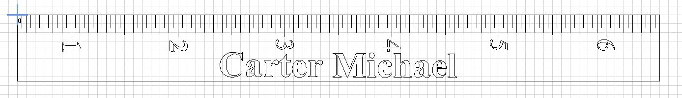

I’ve been drawing in Sketchup and exporting as a DXF to ESTLCam. I know it’s probably not the most efficient way but I know my way around Sketchup enough that I can make what I want pretty easy. The problem I’m having is that the size in Sketchup (drawn in MM) doesn’t import into ESTLCam at the same size. I found that I need to scale it by 91.75% to get it to match up with my grid in ESTLCam. My grid is set at 25.4 x 25.4 so I can look at things in inches. Does anyone know why that might be? It was through trial and error that I figured that out.
[attachment file=36476]
[attachment file=36477]

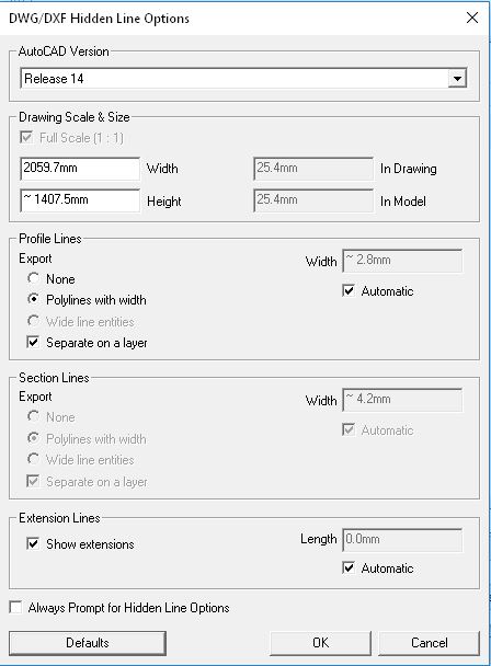

Yeah, it makes sense. I just can’t figure out why it won’t import at the right size. It’s not really a big deal for 1 drawing, but wil lget annoying if I can’t figure it out. I’ve linked to the DXF and attached a screenshot of the export options. The forum wouldn’t allow me to upload the DXF directly. It seems to be exporting at full size but importing slightly oversize.

What are your options in that drop down, release 14 is probably not the right one, which ones allow for the 1:1 checkbox to function?
Interestingly, none of the file versions allow that checkbox to function.
I got it though. I thought it was straightforward so I didn’t bother looking up how to export. Turns out I missed step 1 and that made the difference!
From their support page: https://help.sketchup.com/en/article/3000165
  1. To maintain your model’s scale in the exported file, in SketchUp Pro, select Camera > Parallel Projection. Then set your view to one of SketchUp’s standard views by selecting Camera > Standard Views and selecting an option from the submenu that appears. (See Viewing a Model for details about the model view options.)
