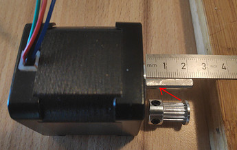

On the stepper motor i bought the shaft was too short for the GT2 10mm pulley to fit properly.
Just used a file to enlarge the flat area - now the pulleys seem to fit properly:
So far I have not assembled them with the rest - hope there wont be any more problems lurking somewhere :stuck_out_tongue:
That approach may help to reduce the size of spacers needed if I can not resolve it with my supplier otherwise. Thanks for the feedback.
