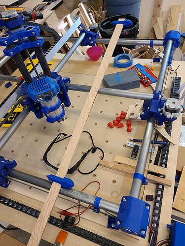

For large tables, I have found this difficult to do using a tape measure when I don’t have a helper. While there are various ways to do it, I wanted something that is quick, easy, adjustable and accurate. To that end, I found a yardstick-based trammel point design on Printables ( Printables ), and did a simple re-mix so that the pivots now have a pointer that has a spherical shape, 1/8" in my case.
By using a 1/8" ball nose router bit, and routing shallow dimples at the corners of what is supposed to be a rectangle, you can check the diagonals by yourself since the tip of the pivot forms a sort of kinematic connection to the routed dimple. And, since the beam can be a simple wooden yard stick, the fabrication is very low cost. Or, if you need a longer beam, it’s simple to fabricate. Of course, you could still use a nail and mark the corners with a smaller probe or with a pen. But, with no assistance, I don’t find those methods as accurate.
Some pics may help.
Overview of Story Trammel (ignore the clutter)
Shows the pivot and the dimple (circled). This was about 1mm deep.
The pivot point placed into the dimple. There is no detectable “slop”, which suggests the accuracy must be better than 0.1mm. Maybe a lot better.
I actually got lucky and after only 1 adjustment of the dual endstop, had a perfect fit on both diagonals. I think #Primo.new is ready to go…

But, the point of this effort is that for large machines (like a 4’x8" LR3) it’s not easy to measure the diagonals accurately. This device assists that process since it “locks into” the small dimple on one end. We don’t really care WHAT the diagonal length is… just that they are both the same.
Even on my Primo, which has about a 600mm x 600mm work area, if you use something close to that for the squareness test, the diagonals are about 850mm. Personally, I can’t see both ends at the same time to check the measurement.
Even with a helper, the measurement is only accurate to about half the smallest division of your measuring device… maybe 0.5mm at each end? Theoretically at least, if the dimple and the ball end of the trammel are pretty well matched, the accuracy of the placement can be MUCH better, likely better than 0.1mm.
