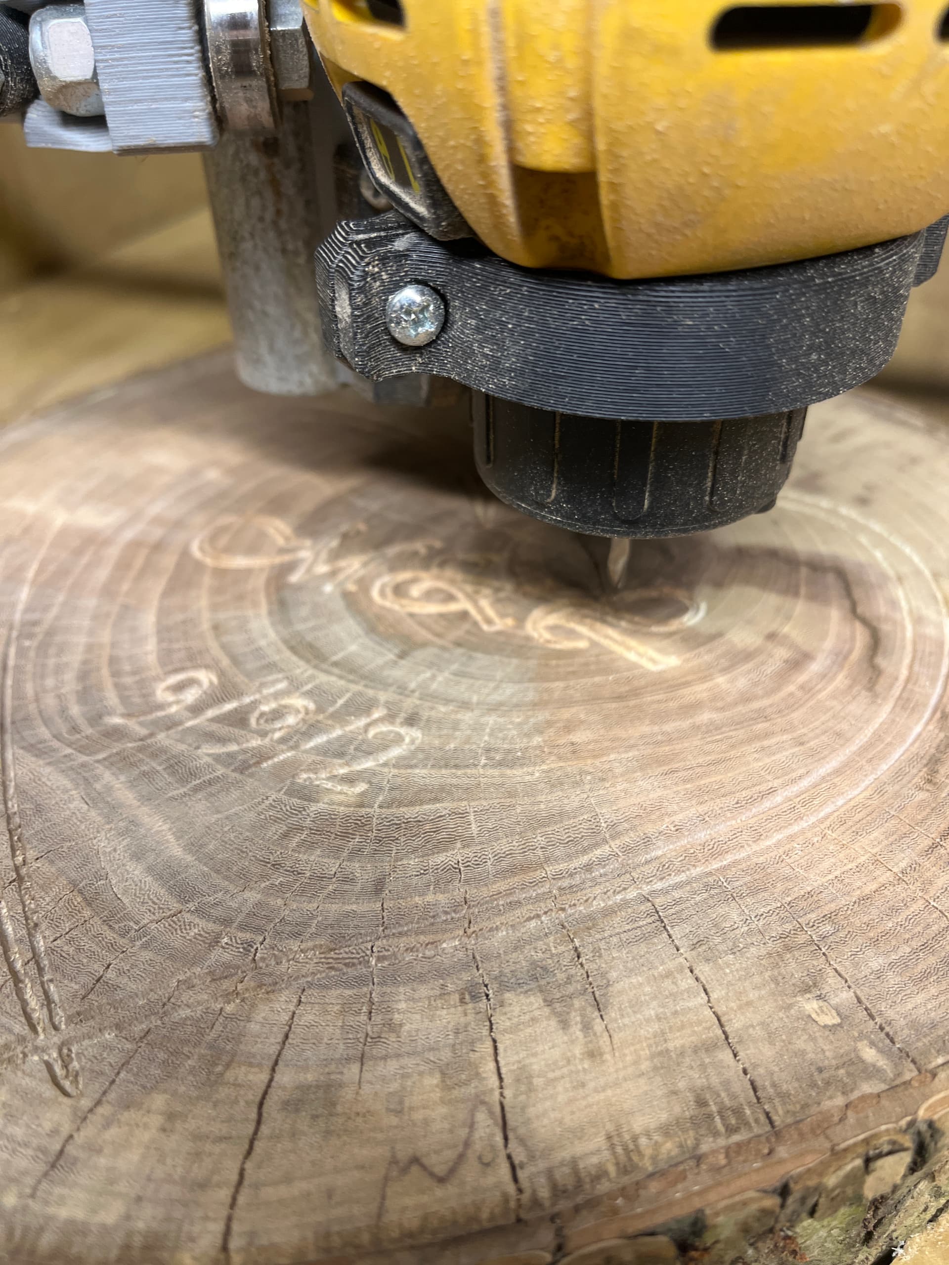

Has anyone ever ran into the problem with repetier stopping during a run? I was 18 seconds from finishing this carving and it just stopped for no reason?
All it had left was the last 2 in the date and it stopped
Did your computer go to sleep?
I use an SD card in the screen so I don’t have to worry about sleep or updates on the computer.
Yes, I had issues at first, then started to run off a usb stick plugged into the screen. Haven’t had issues since. The only other issue with random stoppages was i had left the micro sd card in my skr pro board. Took that out and all has good.
I have my the sleep mode turned off. I don’t have a screen. I’m hoping this is the only time I have this issue.
I had octoprint working great, then one day, octoprint on my 3d printer started screwing up, (Just what you said, it would stop printing whenever it wanted) then I remember Ryan saying, never have problems with sd card. Now I do that again.
For both cnc and 3d printer. (And I do I.T. for a living.) I wish my 3d printer didnt have a micro sd slot though!
I had a problem like that where I had somehow managed to only copy half the file. I am still not sure how I did that. But check your gcode.
