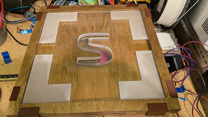

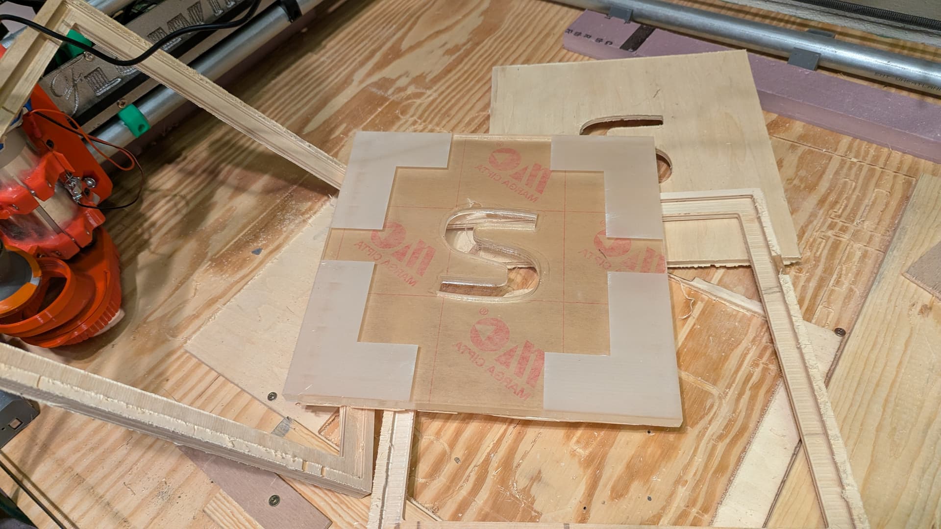

1/2" acrylic ~300x300 mm
1/2" maple plywood 24x28"
1/4" pine plywood 24x20"

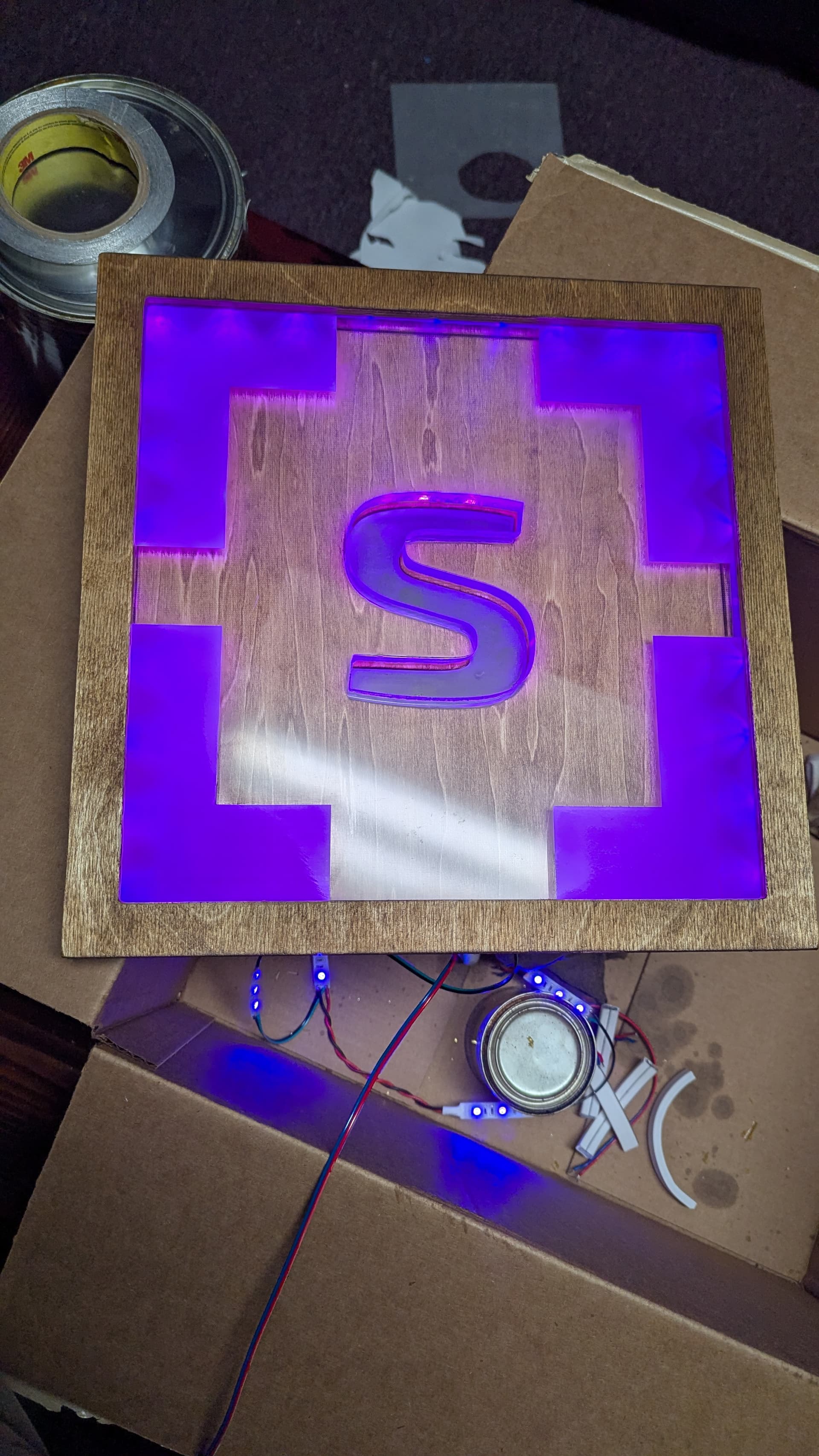

12v 3 color led strip wired to red and blue
12v white led neon
Logo svg
Laser Etched the brackets and cut the acrylic with the epilog

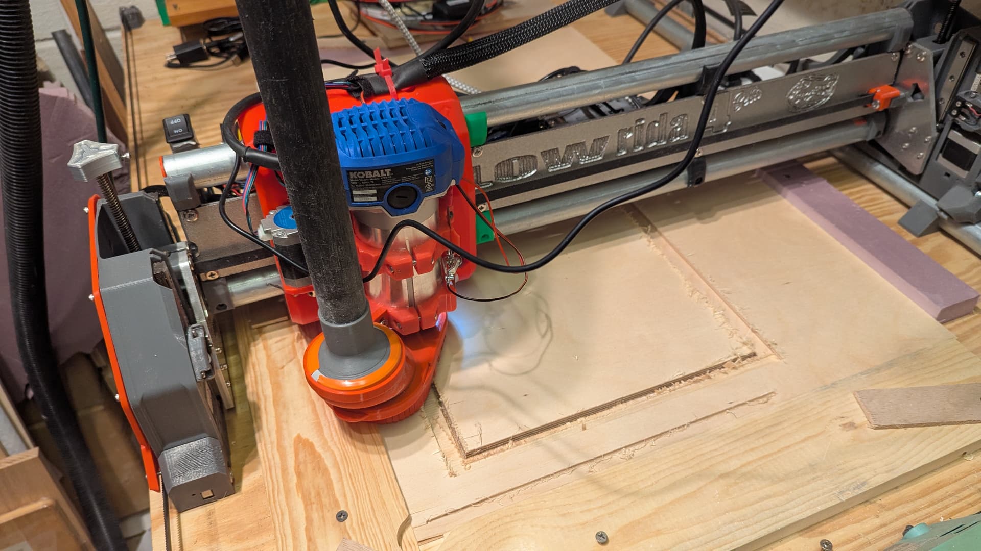

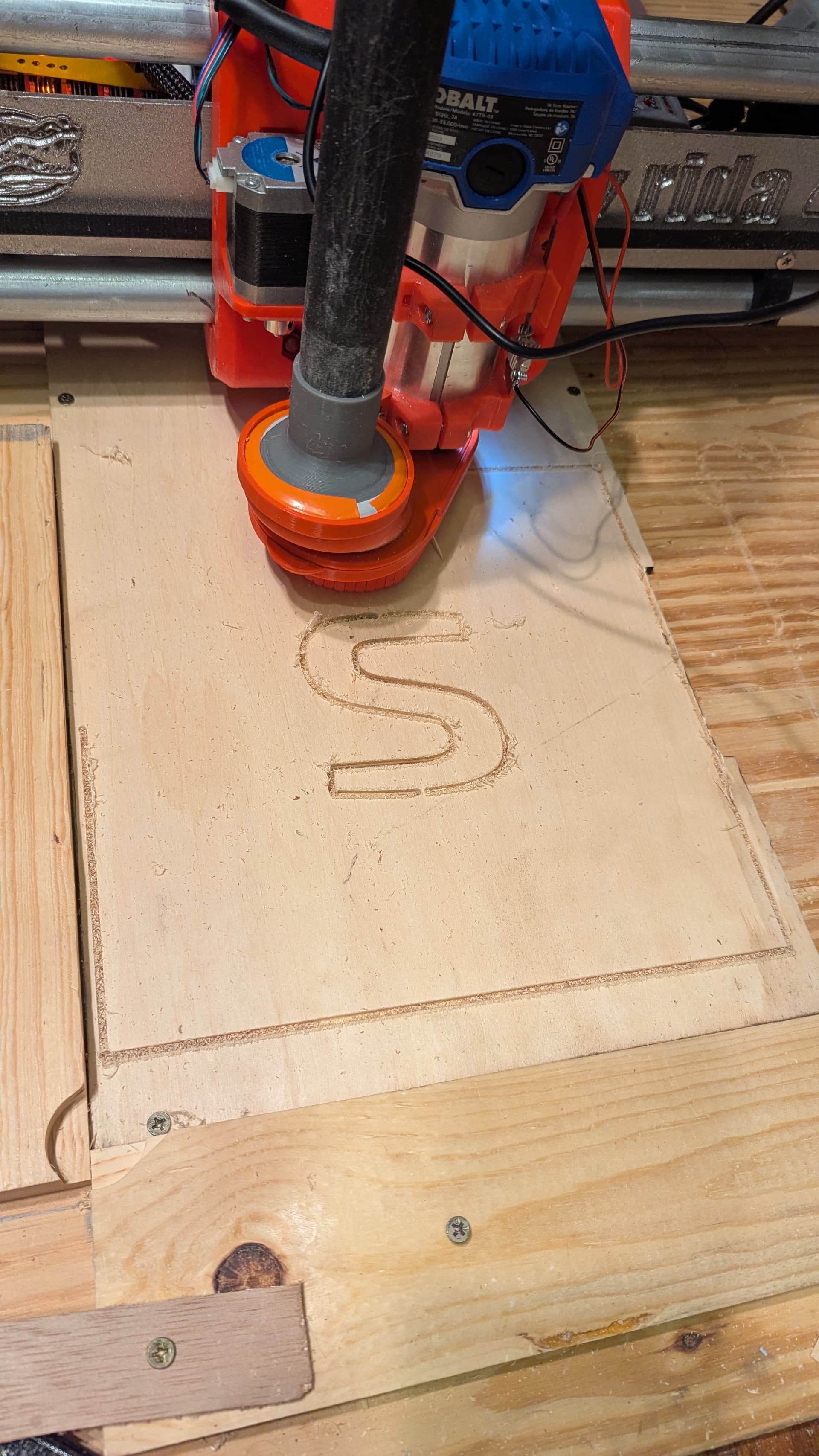

Cut front and back 1/2" frame with LR4
Cut backing insert with lr4
Sanded, stained, poly finish
Buffed acrylic cut residue with polishing compound

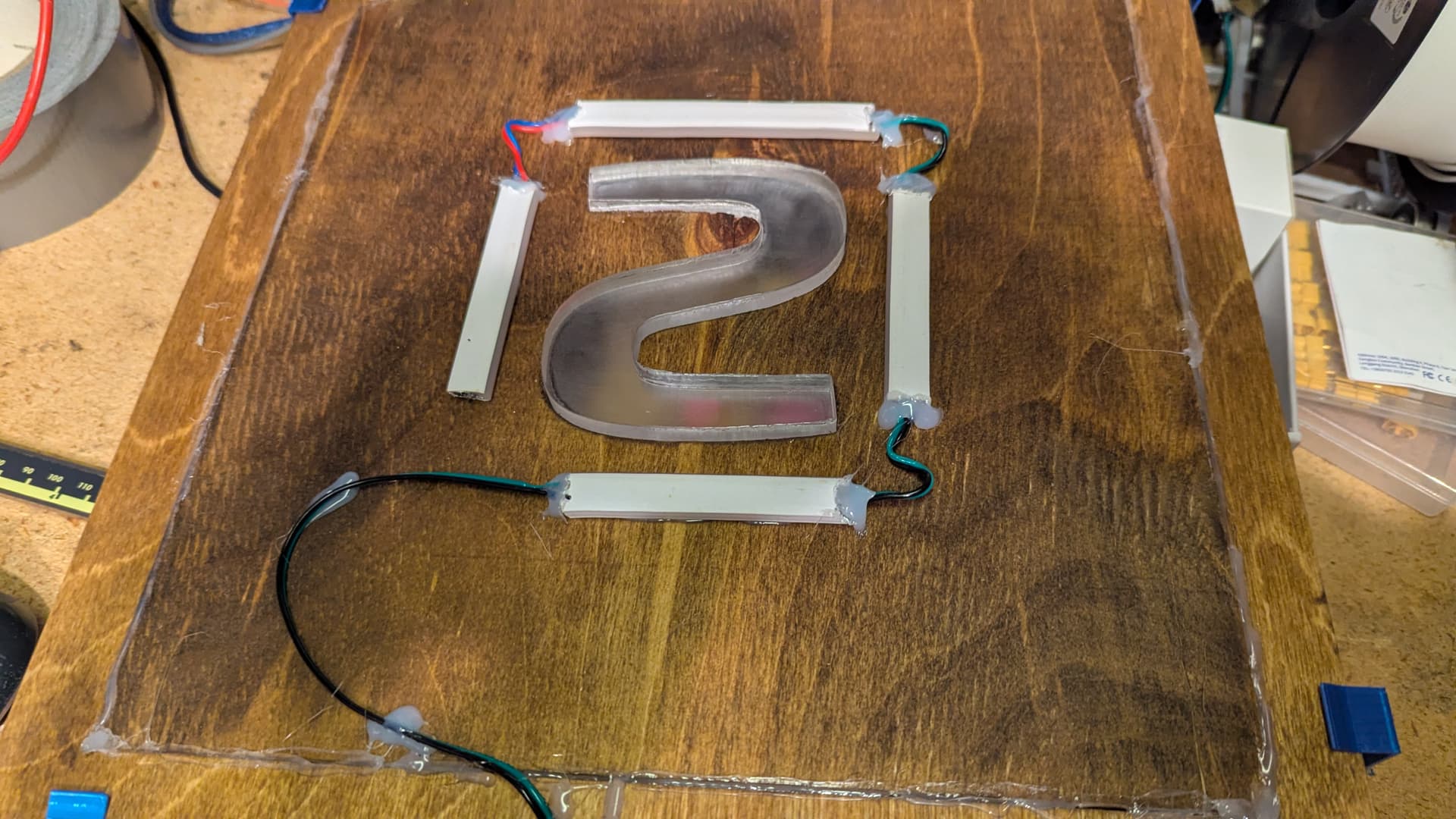

Aluminum tape holds led strip to acrylic

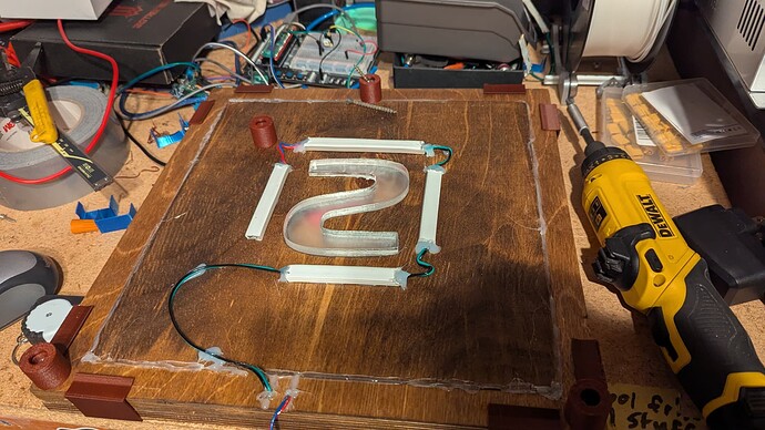

Hot glue holds white neon strips (edit: added back side photo)
Sanded s front face so it lights up with back white neon
-3d printed clips hold frame together and spacers from the wall and the hanging mount.
