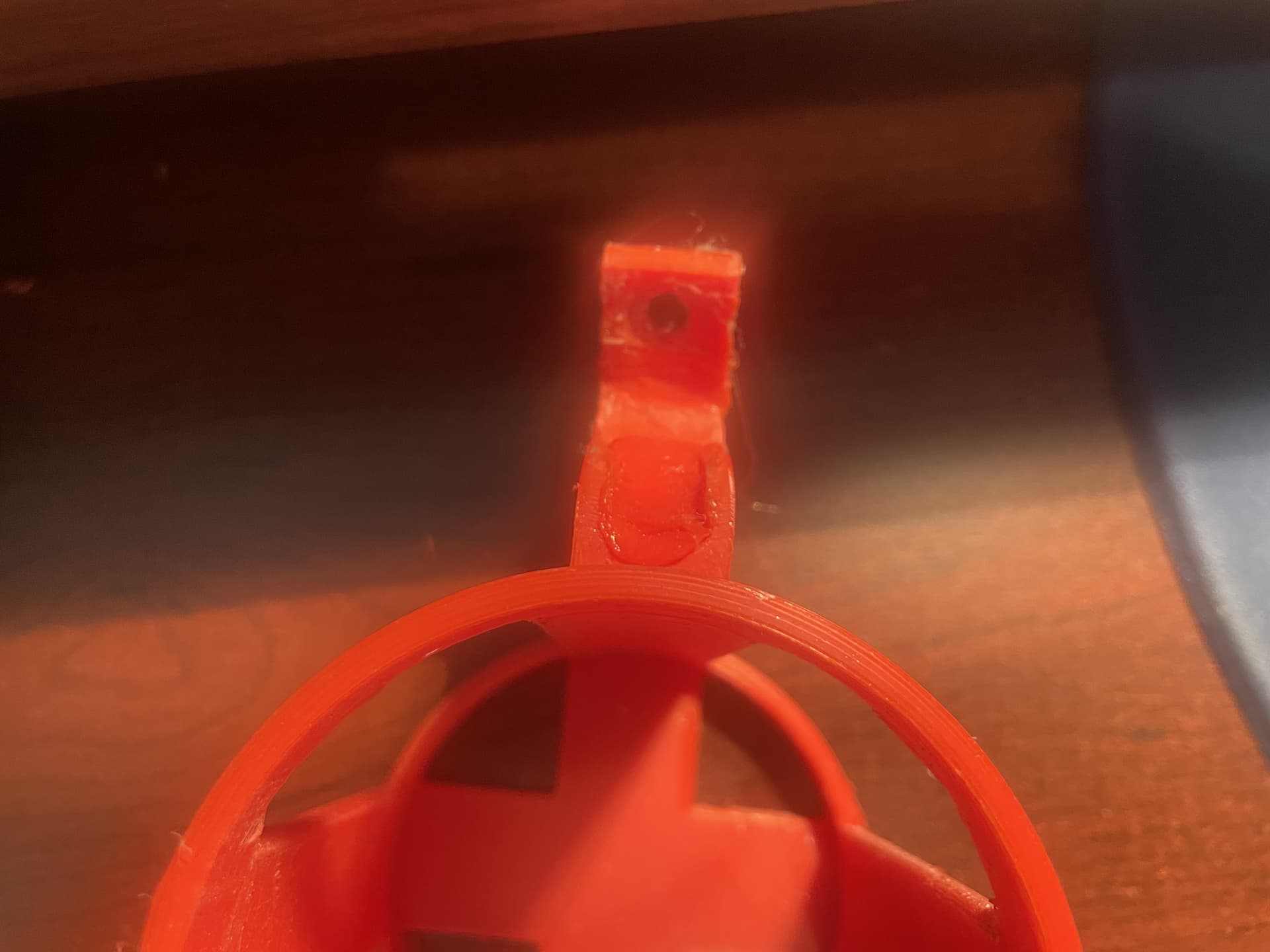

Not yet! The version I made had a couple of issues (flaws). I made a mistake in the design of the part that attaches to the brace, and it was interfering with inserting the top screw. I had to melt a channel using a soldering iron to be able to slide the screw into place.
I also didn’t adjust for the thickness of my struts, so the tabs with the screw holes were bending when tightened, and cracked in one place. Once again a quick touch up with a soldering iron repaired the crack, but I’m not satisfied with the original design enough to share it with the world yet.
I am, however, currently working on an updated version that will address these issues, and will post it on Printables when it is ready. I’m not sure how I will address the issue of different thickness struts yet, so I may have to figure out a semi-parametric model that can allow the user to enter their own thickness and have the model follow along.
