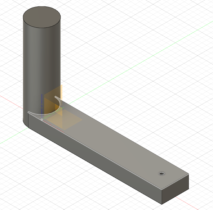

I also saw the perpendicular tool that somebody had put together for a DeWalt (along with the comment from @jeff3b). I can see now how to check for whether the Z axis is perpendicular.
To help I’ve designed a parametric version in Fusion 360 to check it out.
My version is 6mm and just screws in the collet. However you can change the parameters and use it in 1/4", 4mm or whatever. I left a small hole in the arm to put a panel pin or hot needle through at one end.
Hopefully you can access it here https://a360.co/32WOoWQ.
I’m currently printing a load of eccentric cams for clamping so will print this off later this afternoon and then check the Z axis.

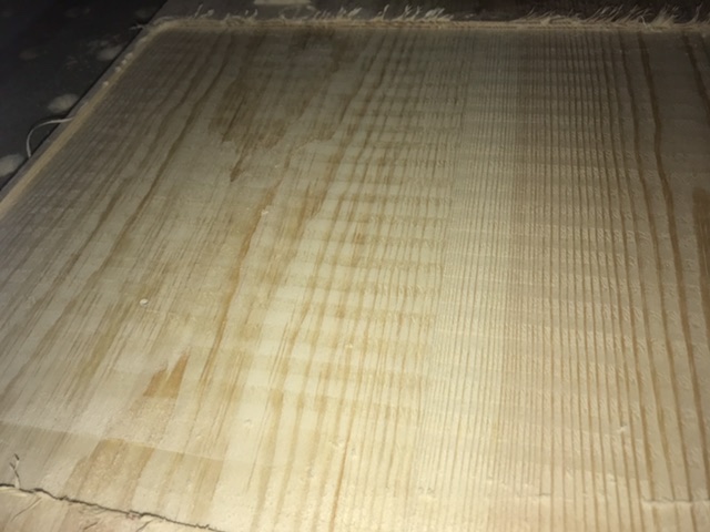

Here’s a picture of the marks on the wood. I can’t feel them with my fingers but they are there.
If you can’t feel them, I wouldn’t worry about it. You can also get funky lines like that depending on the direction the cutter is moving, kinda like the stripes you get when you mow the lawn.
I’ll do a light sand to see what happens to them.

+1 not being able to feel it is about as good as you can expect. It’s sandpaper from there if you want a cosmetic surface.
Was this passing in a single direction or cutting back and forth? It’s conceivable that climb milling vs. conventional milling could make a difference, although I’m not sure if that is a major effect you would see.
This is cutting back and forth.
