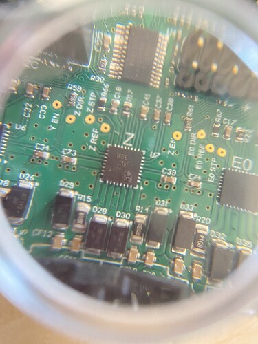

Hi All - We made great progress on our low rider, but we seem to have run into a problem.
It appears we shorted out the z control microchip on the Rambo board. It has a small blister on it which I’m assuming was caused by a short.
Since we have the parts from a never built lower rider 2, we are going to use that board (and SKR) to keep things going.
The question for the masses: we assume the board component failed b/c of a short. Is the best way to ensure we prevent that is to tape all connections to avoid the possibility of wires crossing or touching something metal?
We just don’t want to short out another board.
thanks.
Based on forum posts, it is extremely rare to lose only a driver on a Rambo board. I think this is only the third time I’ve read on the forum about a lost driver on a Rambo board in the last three years. Looking more widely at drivers in general, I read more about drivers being blown when they are energizing a motor and then the motor is disconnected than shorting. If it was a short that caused your issue, I’m surprised the fuse did not blow.
Assuming the possibility of a disconnect rather than a short, consider doing a continuity test on the wires while manipulating the wires with particular attention to the connections.
If all you’ve blown is one driver, you can still use the board in a serial/series configuration. This is a bit more problematic for a Lowrider with the dual Z axes, but, historically, it was common for the MPCNC machines.

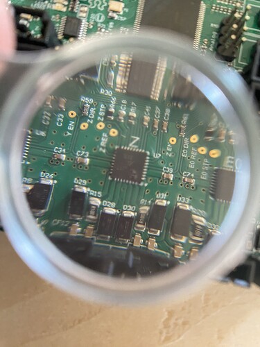

Hi Robert - thanks for the feedback.
I’ve included a picture of the board.
You could be right that this went when the motor was energizing and then was inadvertently disconnected. We have struggled with keeping the leads for the z axis that plug into the board to stay engaged.
