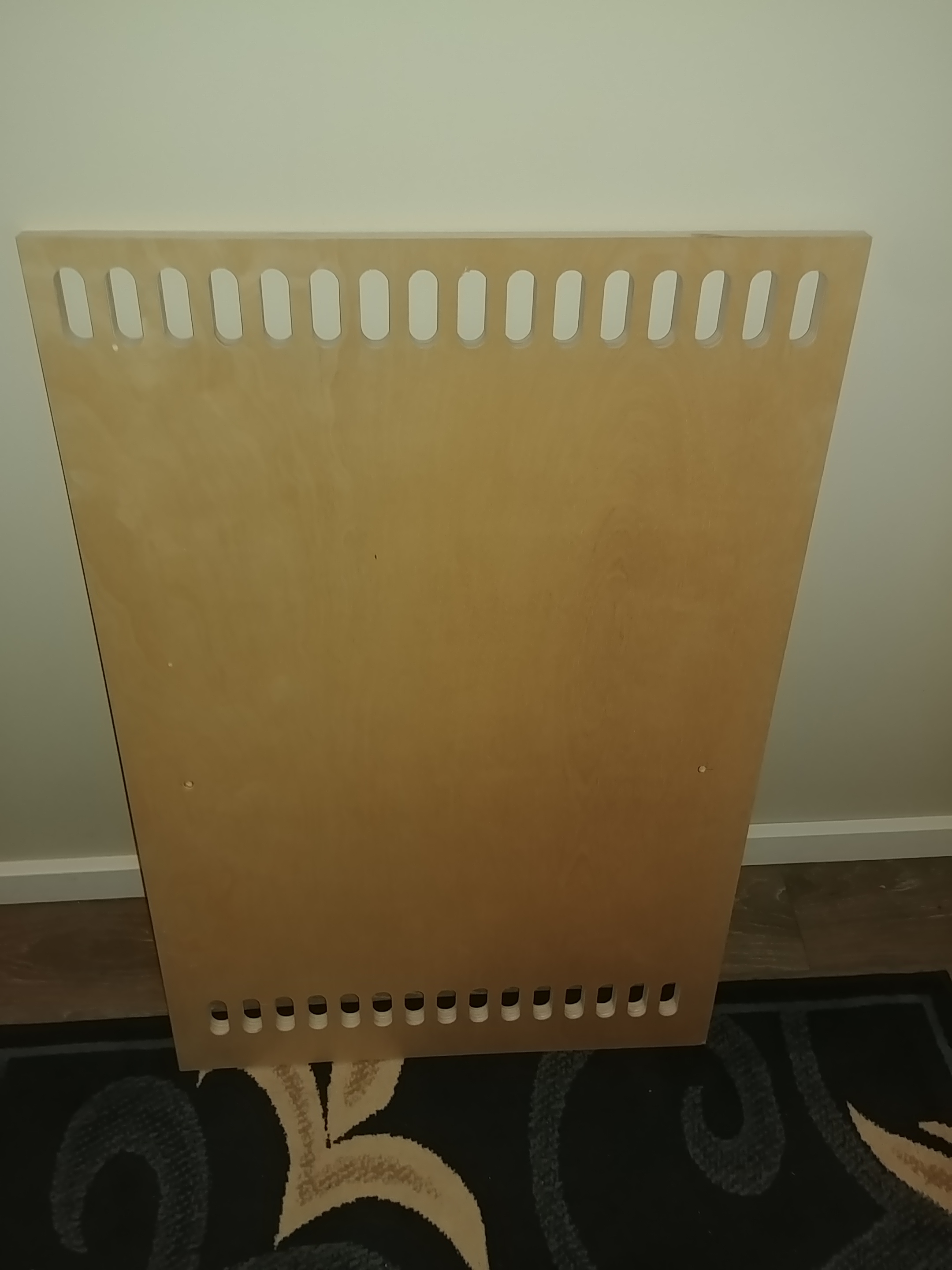

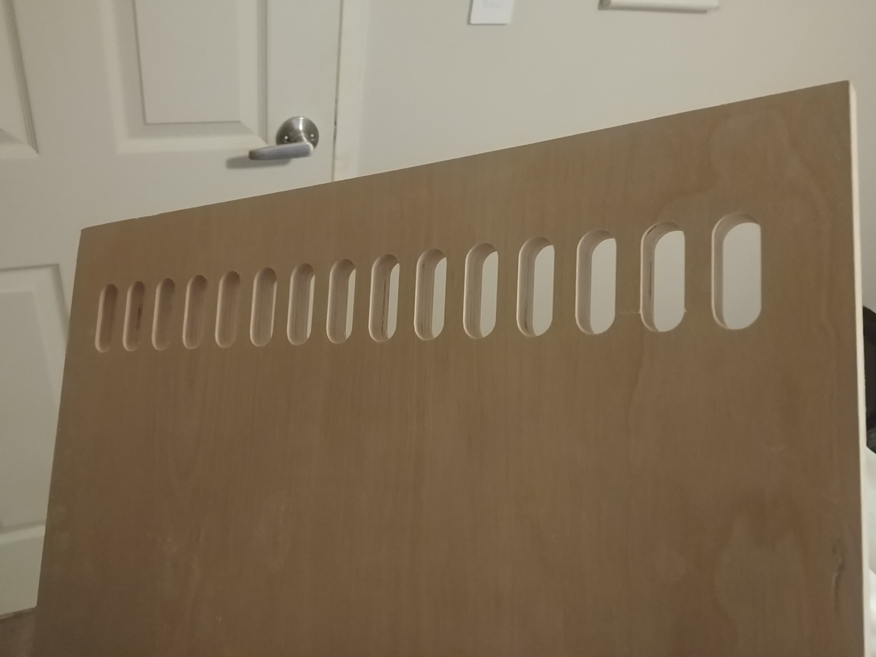

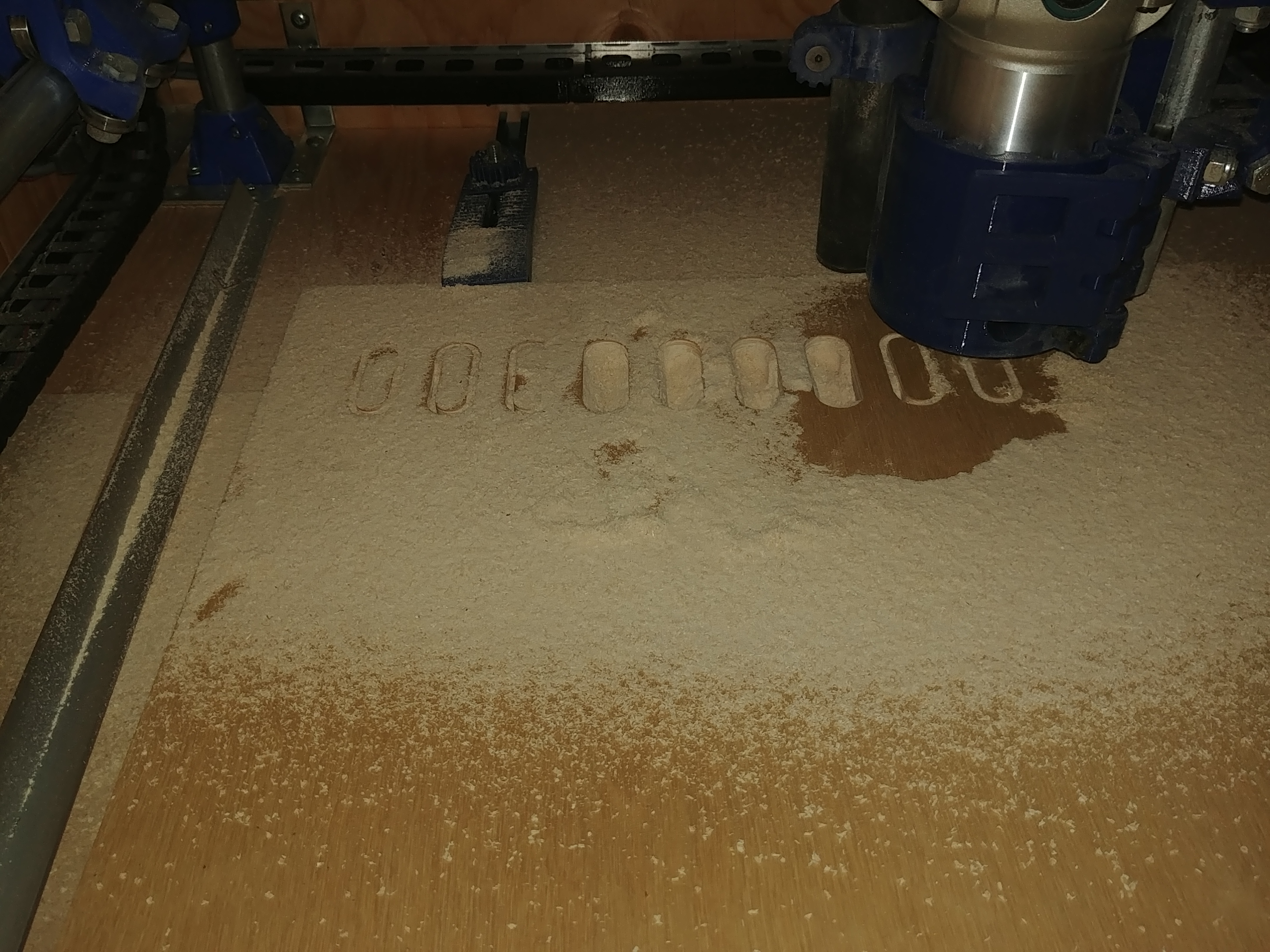

I got the last of the hardware I needed today: hidden spring hinges and door handles. I just need to mill the vent slots in the vacuum door and I can finish assembling everything.
First set of vent holes cut.
And second set:

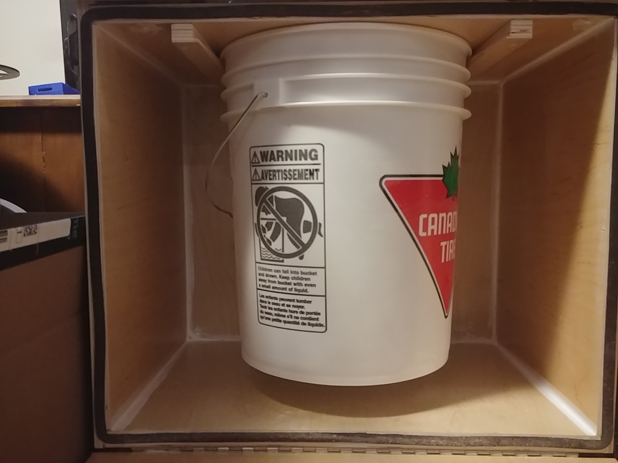

As an aside, the cyclone is super effective… Too effective. It sprayed the dust all over the inside of the sealed box for the bucket. I’m going to have to revisit the design a bit I think. :smiley:

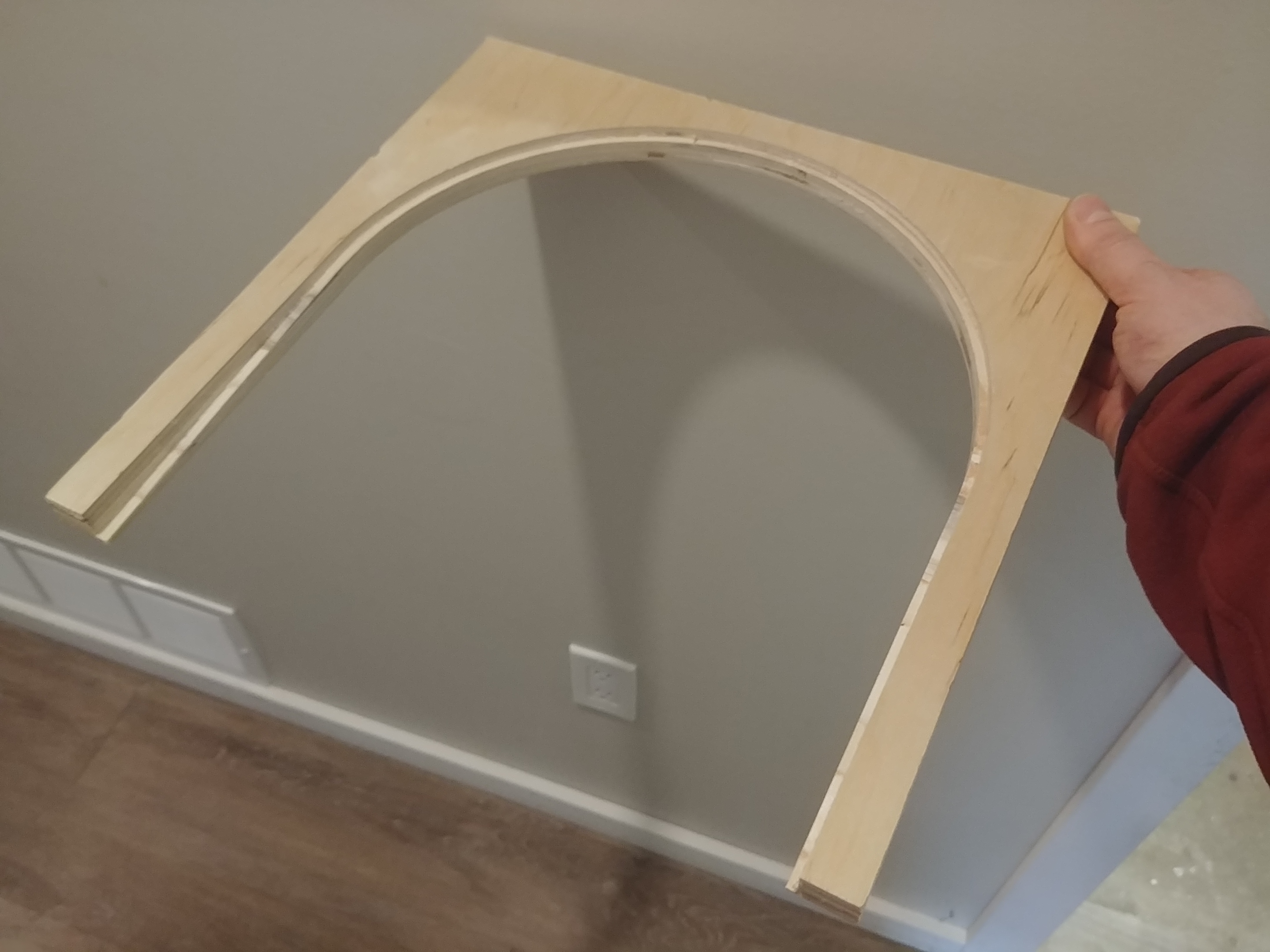

Added a bucket ring to under the cyclone, should help make a better seal for the bucket and throw less dust around inside the sealed compartment.
Your ring looks good, great way to keep it fairly easy to empty the bucket.
Drowning warning on a bucket? I’ve never thought of that… hmm hmm
It only takes something like 3" of water in the bucket for a toddler to fall in and drown because they can’t get back out. It doesn’t happen often, but in the US, we like to put warnings on EVERYTHING.

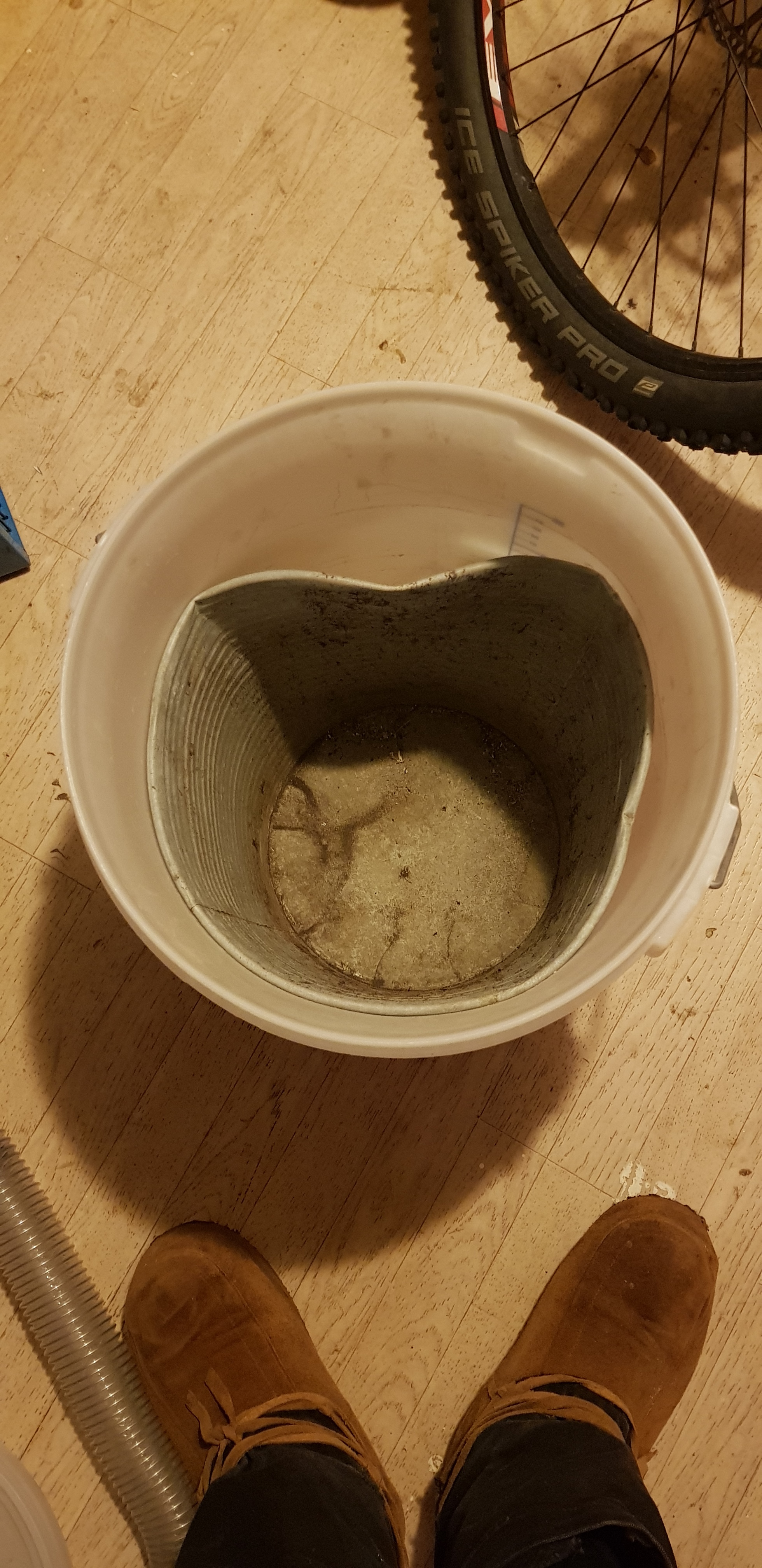

WELP! I finished the cyclone, it works like a charm - but the bucket is sucked thin/implodes! I’m going to make a couple of circles out of wooden fiber plates, to make a structure that enforce the sides of the bucket. Any other ideas??
Barry suggests a double bucket. The air pressure should be enough to keep them together.
Put a bucket inside a bucket they said. Should be enough they said. Well - I say it all depends on the buckets…
I tried with a big and heavy clay planter. It worked at last!
Well, I think it’s supposed to be two of the same bucket…
