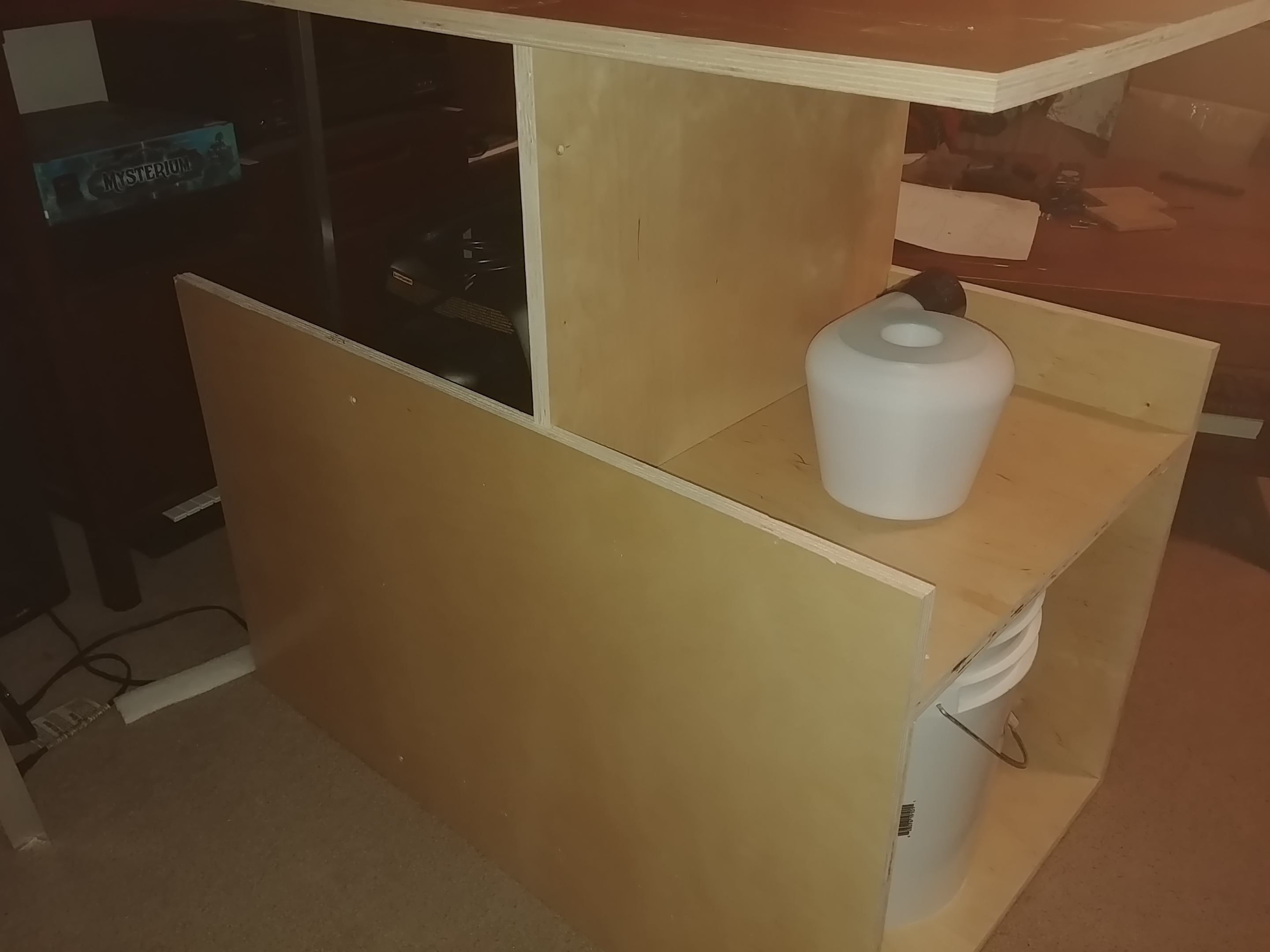

A quick mockup of the cabinet: doors on the two ends to access the dust bucket or maybe drawer, and the vacuum on the opposite end.
Few more pieces cut and dadoed. I don’t have enough left for the doors I don’t think. :frowning: I’ll have to find something else I guess. Most of the pieces I used all but a few inches of.
By the way, I’m doing this work using a circular saw and my makita router and clamping my t-square to the pieces. :smiley: Someday I’ll actually have a shop. Someday… I’m kind of on hold now for the bottom of the cyclone to finish printing.

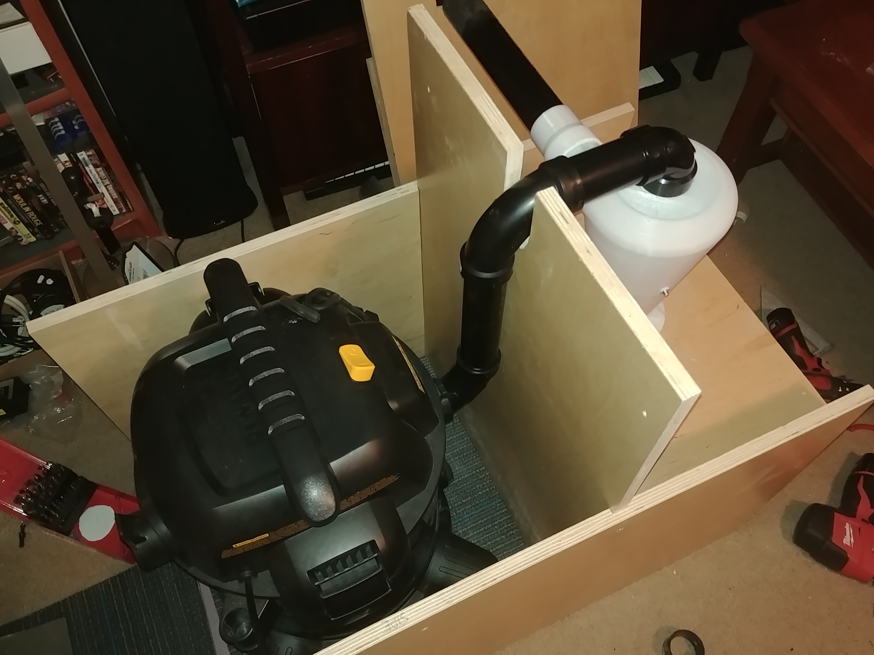

Vacuum enclosure side mostly compete. I’m hoping the combination of rubber-backed carpet tile, solid insulation and 3/4" plywood will cut at least 15-20dB on the vacuum. It was supposedly a 65dB design but it’s more like 75db at 4 feet distance.
Last pieces dadoed and doweled for alignment. And pipe cut to length for inside the cabinet. Just about ready to start assembling. The edges don’t line up perfectly though. Might have to take the sides out and cut another 1/8" off to clean it up.
Will you be able to take the entire top off when you’re done to clean it?
If not, how hard will it be to hook that hard pipe back up through your access door?
I might put the top on a hinge, I haven’t decided yet. And the pipe should just push straight into the vacuum. It’s a snug fit but it does seem to make a decent seal. The vacuum area has a shelf that slides in above the vacuum on an angle that I probably will leave loose so I can remove it in case of access problems.
Test taking the vac in and out a few times using just the side access area. Every time a hand, arm, or head goes somewhere there will be wood, go ,“bzzrt”. and try again. If it takes you more than 3 tries, make mods.
