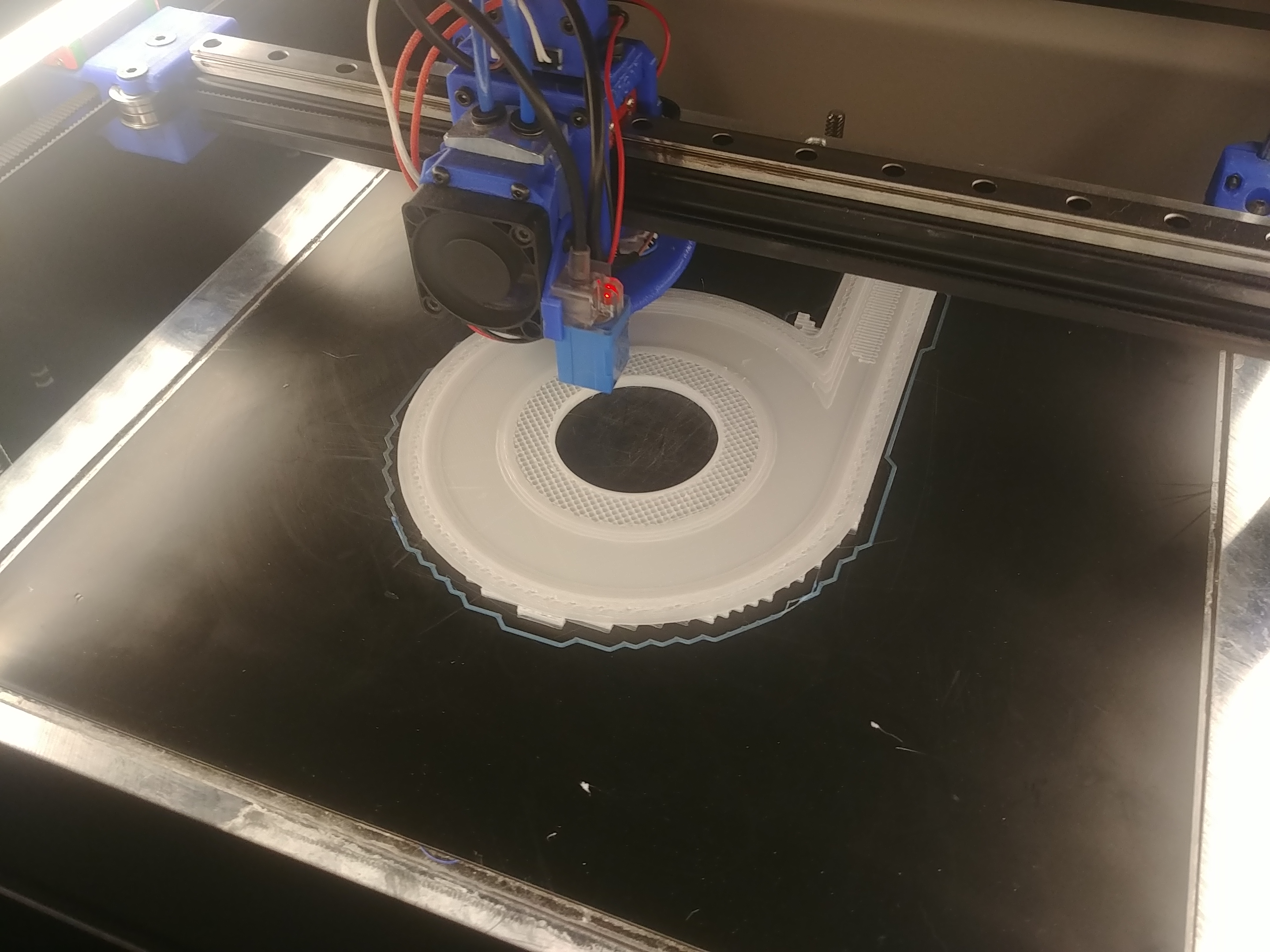

Started printing a proper cyclone. The last one worked okay with my small vacuum but the new DeWalt pulls too fast for it. Eta: 2 days. For half of it. :open_mouth: Edit: Now it says one day. Must have been calculating based on layer time and the first few layers were slow.
And since I’m sure someone’s going to say “why didn’t you just buy one” there doesn’t seem to be any local suppliers, so it’s either pay close to $100 CAD or wait 3-6 weeks for shipping from China. A roll of filament costs about $25CAD, so cheaper and faster than either other option.

My own mashup of a Hypercube 300 and BLV Cube, 300x3 dual extruder w 1/4" heated bed, flex steel build plate with pei, scratch built. :slight_smile:

12hrs in:
