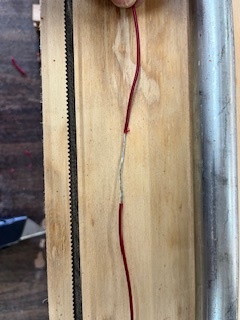

I started with 20 AWG wire, stripped off the sheathing every 2 to 3 feet.

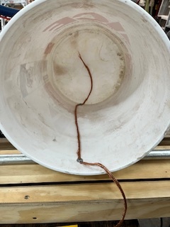

Next, having a roll of old antenna wire, I stripped a section off and removed the copper grounding.
I laid the copper inside the bucket and attached it to 2 bolts. 1 at the bottom and 1 towards the top.

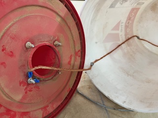

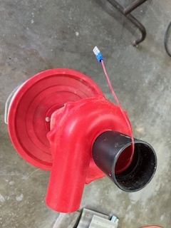

Then I connected it to the mounting bolts on the cyclone, along with another section of 20 AWG wire up to the hose section, and added a quick-release connection.
After getting the 25’ of stripped 20 AWG feed through the vacuum hose, I reassembled and tested with my OHM meter and connected it all to the outlet my LR3 is plugged into.

I had / have an anti-static hose. This is inside the cyclone and bucket.
The lesson I shouldn’t have had to learn: Insulators will store a charge even if you have a fat ground lead right next to them.
Speaking of which, the error in the pictures above is that an exposed ground lead running down a bucket will bleed some charge from a few tens of mm on either side of the lead, and will thus have an overall total lower charge. But on the opposite side the bucket and cyclone top will still be charged up.

Not real often here. We see it more the rare occasion that the humidity is lower. I do have my 2 1/2” dust collection hose grounded so I don’t ever see it on the actual LR4. And I have never been shocked by my trash can that’s inline just before the dust collector.
