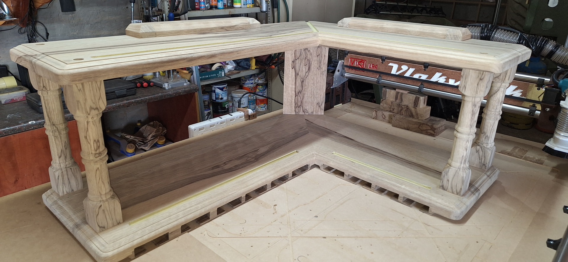

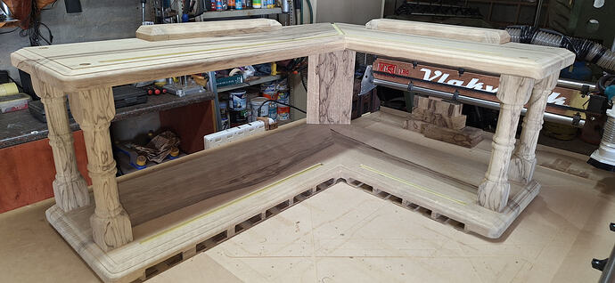

As we all know, walls are NEVER perpendicular and using the LR4 enables one to cut the 45 miter joint in a two step process. First cut 45 then do trial fit against the walls where it will go and measure actual deviation. Do a few calculations, change the vectors, place the pieces back on the table using the locating blocks and trim to exact required angle for a perfect fit.:wink:
Took a while but it is now ready for sealing. The masked channels you see are for LED channeling. Do not want to get sealer in there as its a very snug fit as possible with the accuracy of the LR4.

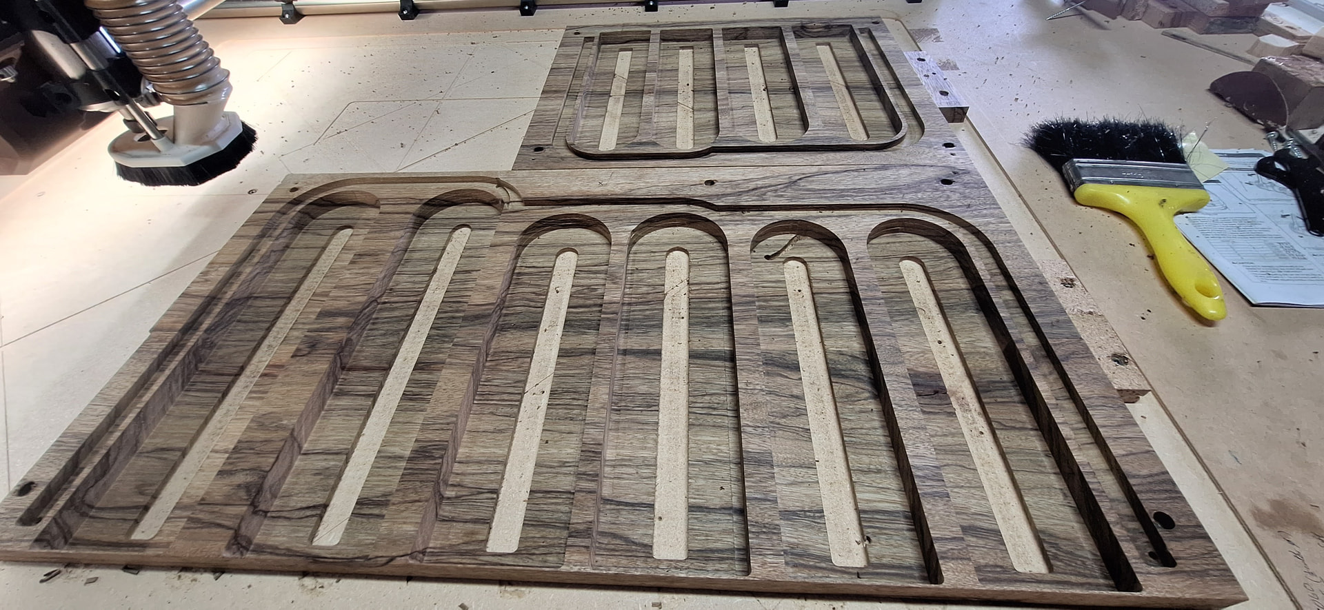

  1. Cutting out the shelf profile with correct miter angle
  1. Adjusting corner Radius

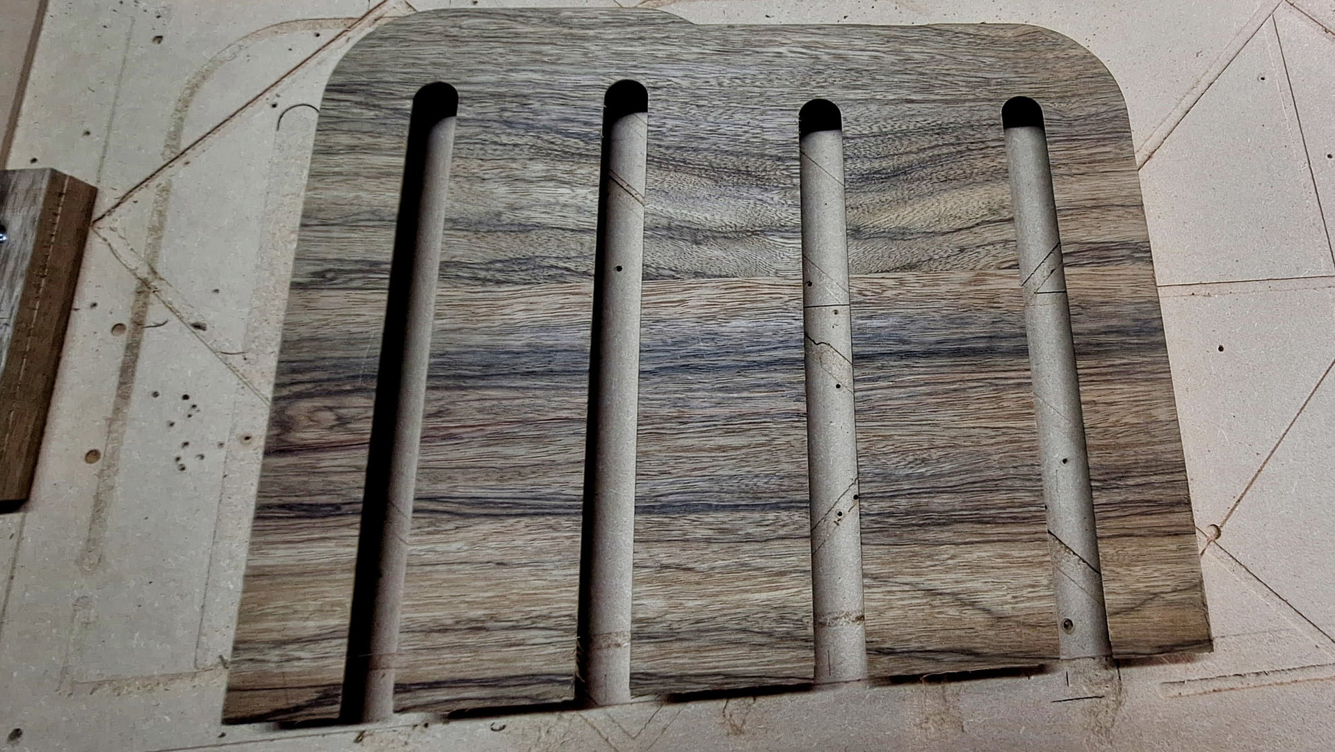

  1. Cutting out Wineglass holder pocket in underside of shelf

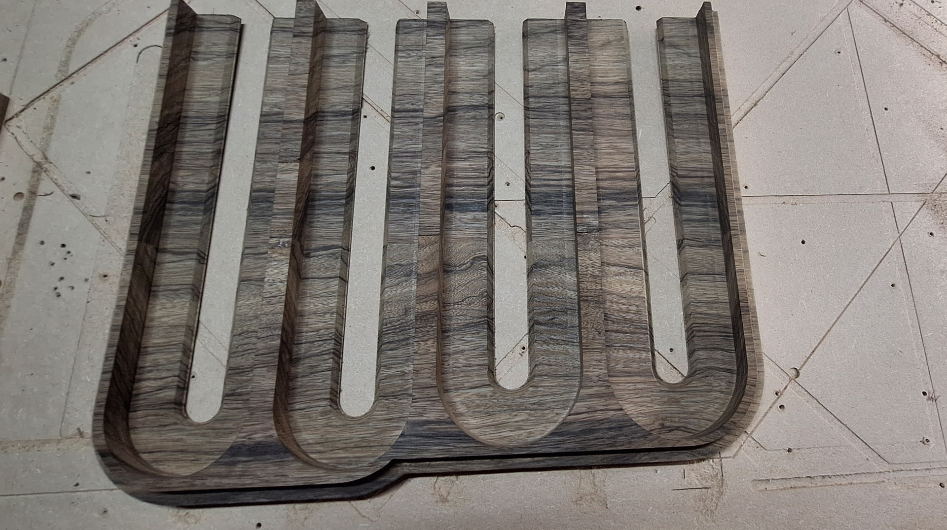

  1. Cutting out Wineglass inserts (Plug in inlay context) from new material.

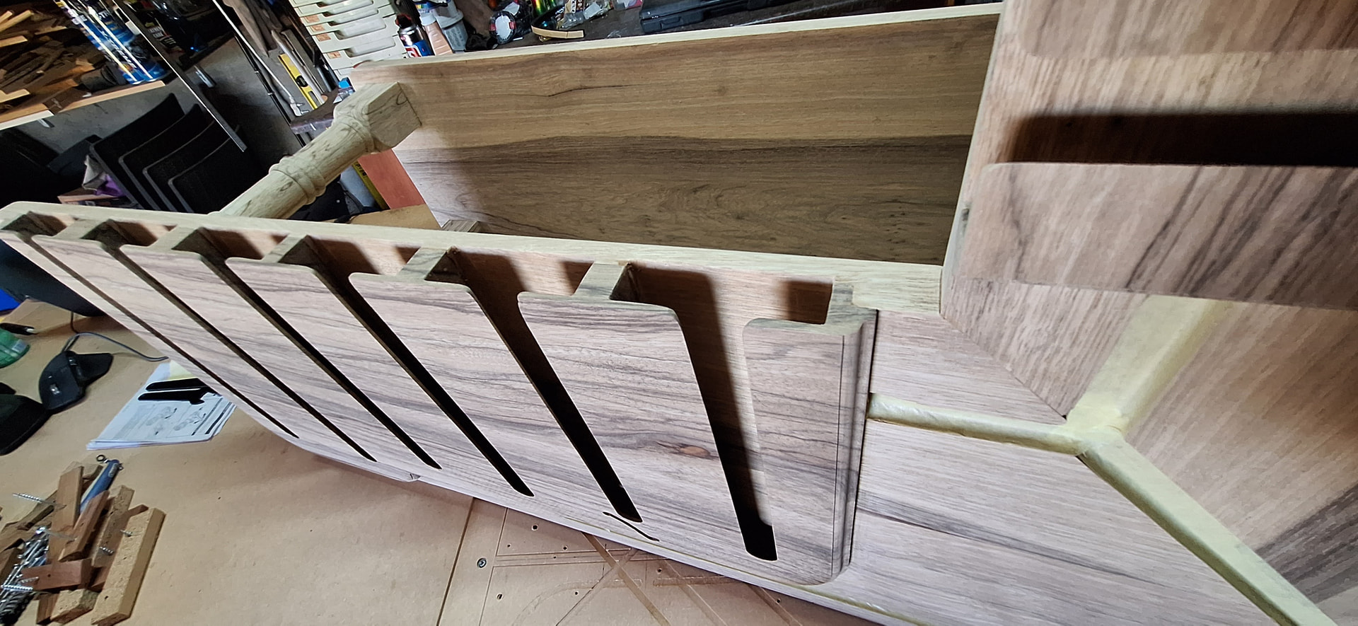

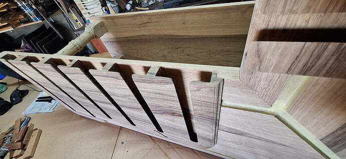

  1. Wineglass inserts in place under shelf

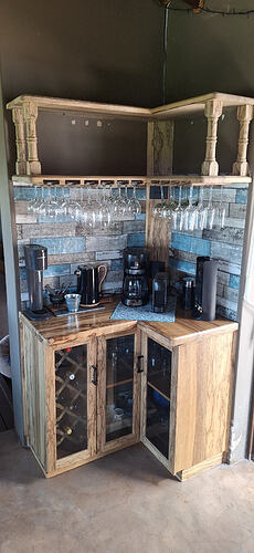

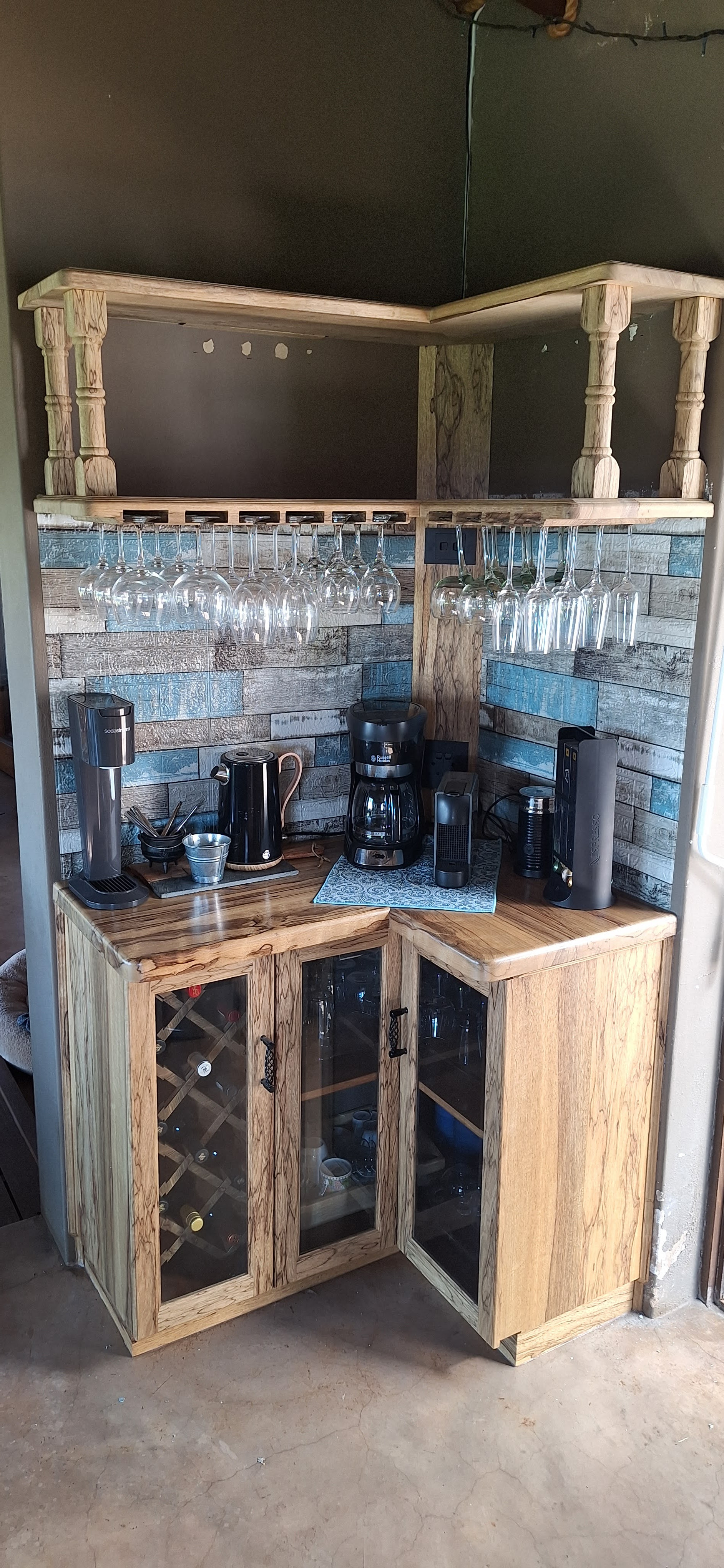

The bigger picture
