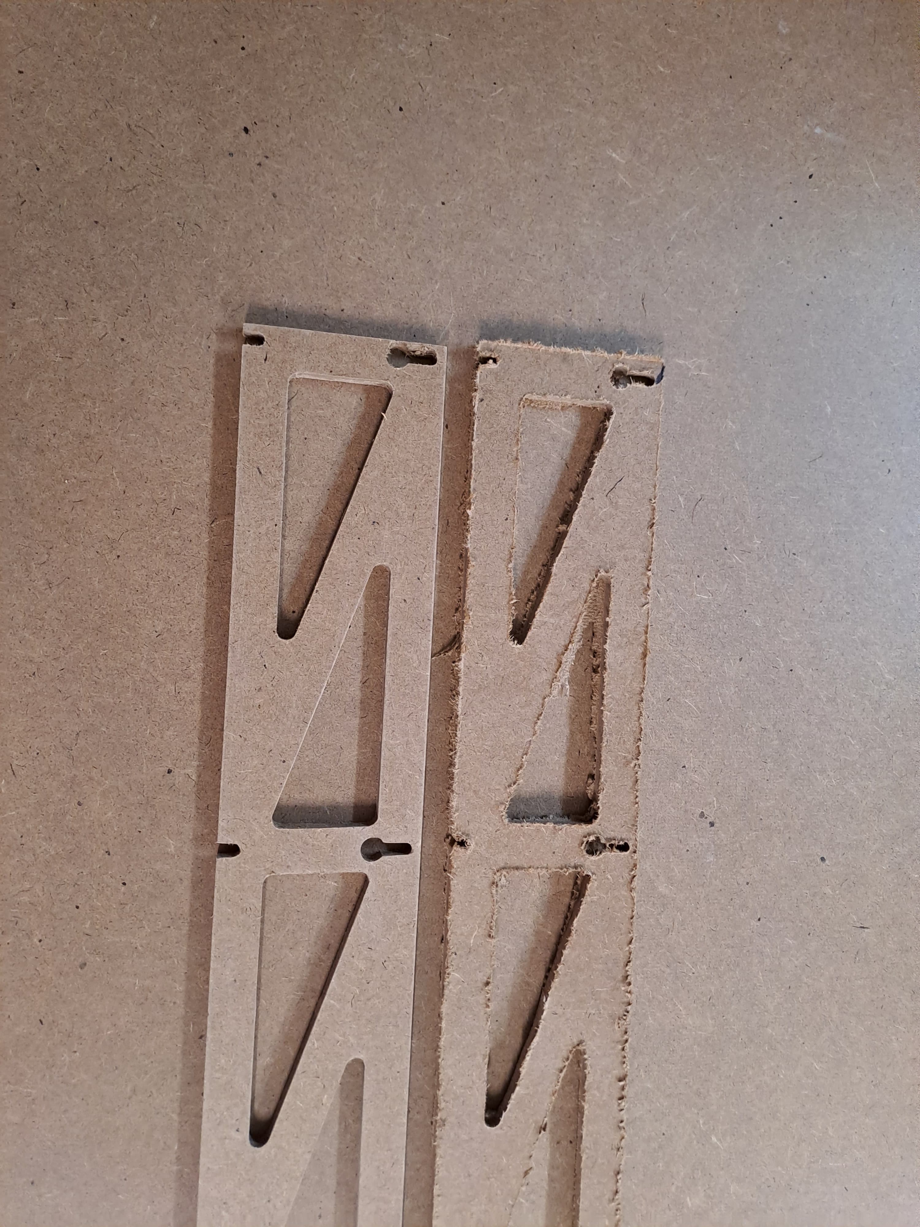

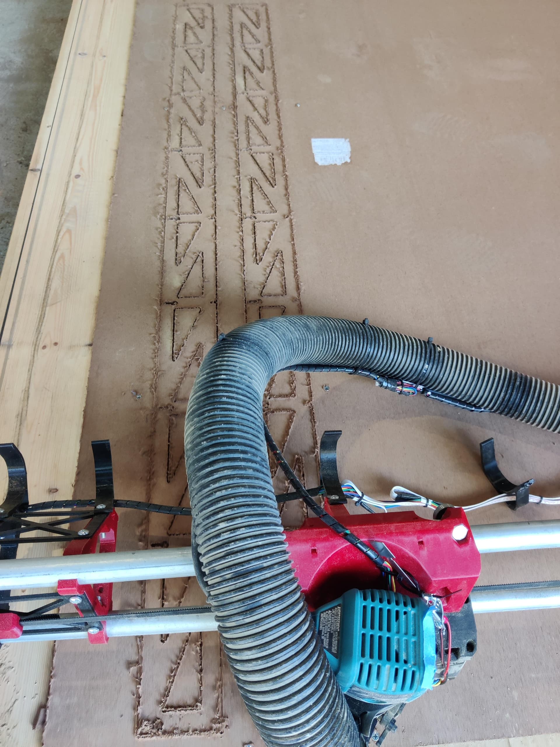

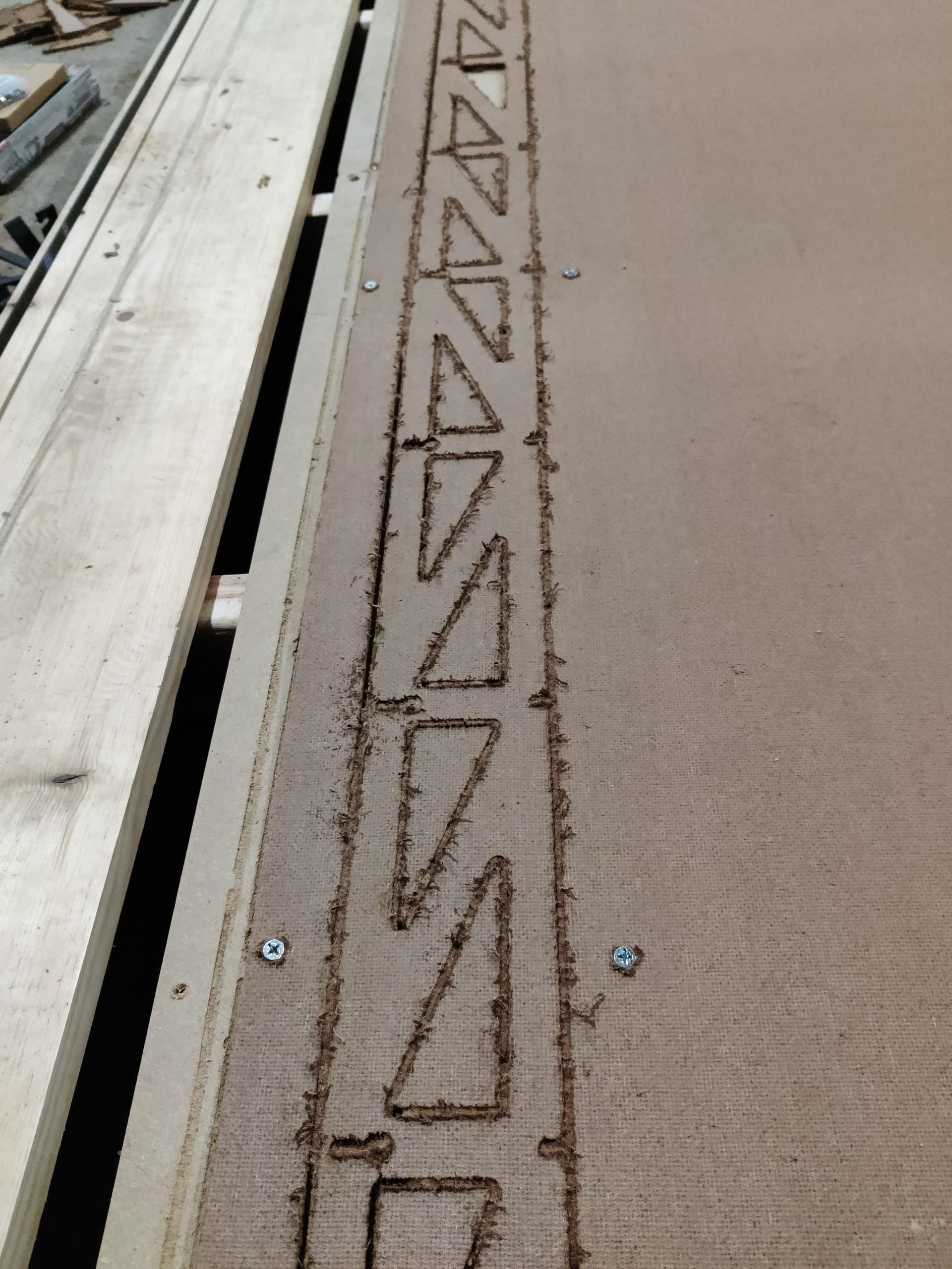

What combination of speeds, feeds, bit, depth of cut, etc. will give a clean cut in 1/8" hardboard? Mine is just tearing like crazy. This is with a 1/8" single O flute upcut bit, speed around 2 on the Makita, feed 762 mm/min, depth 1 mm. Does it matter which side I cut from?
The only way I got anything looking nice in hardboard was to use a downcut bit, and then it depended on if it was down tight to the spoilboard.

I had a lot of tear out too. However, just a little bit of sanding knocked that fuzz off.

I got some cheap 2 flute 1/8" straight cut bits and they seem to cut a little cleaner than the upcut. I think with some careful cleanup and installation these will be adequate. I think it’s better to reinstall the screws completely rather than using the keyholes – I damaged my last set of struts by bending them that way.
btw, flipping the hardboard to cut on the other side made no discernible difference in my small test.

New, sharp downcut or straight bit. Secured stock (double-sided tape or painters tape + super glue). A drum/belt/palm sander. And one of these:

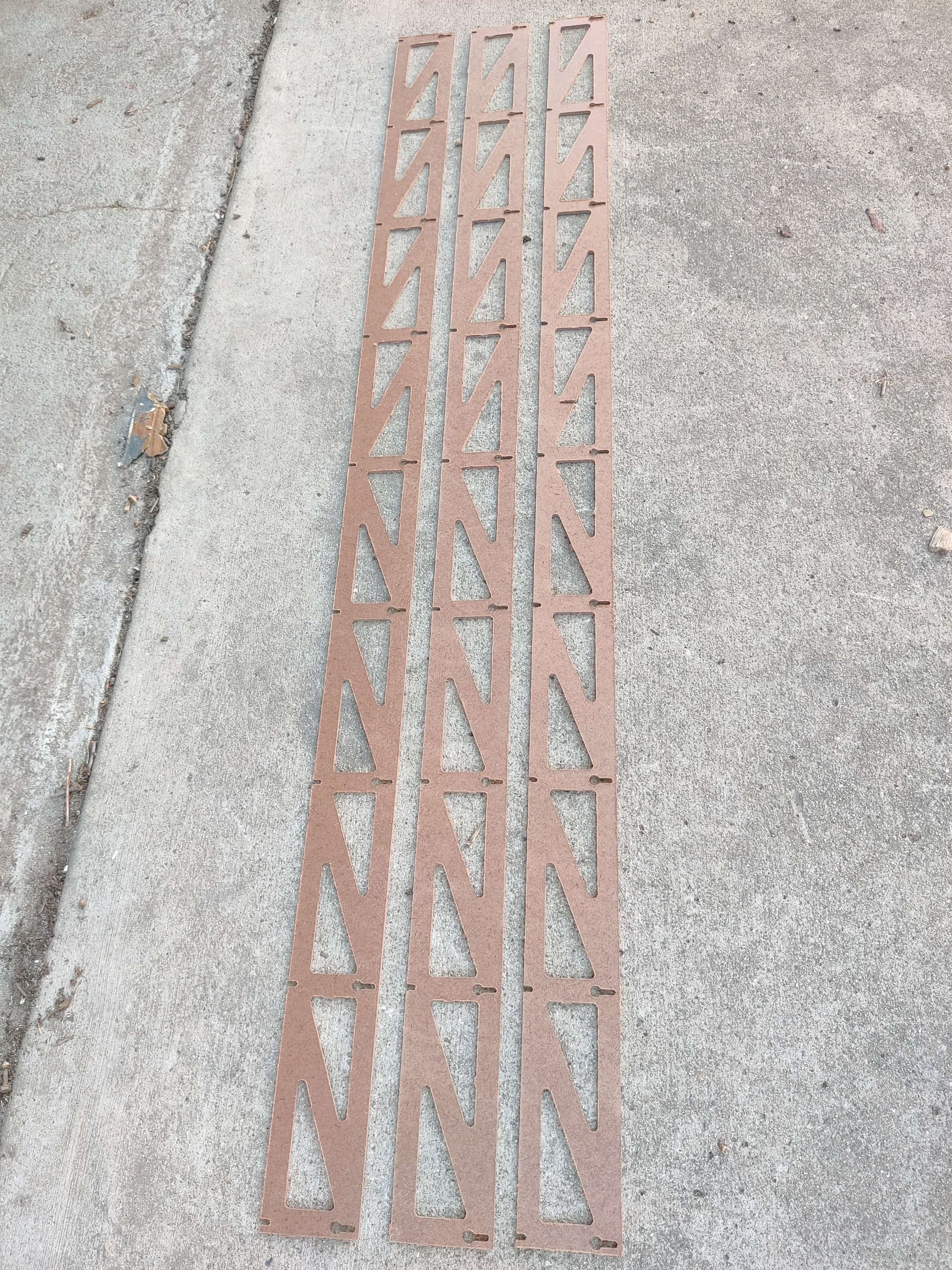

Got myself a random orbital sander, cleaned up the struts carefully and they’re looking pretty decent! Thanks everyone for your help.
I went the harboard route. Yours look to turn out great. Mine did look rough but 320 grit and it cleaned up pretty easy. Like @DougJoseph said, just knock the fuzz off. I used the 1/8" Single Flute Carbide Endmill and happy with the results.
