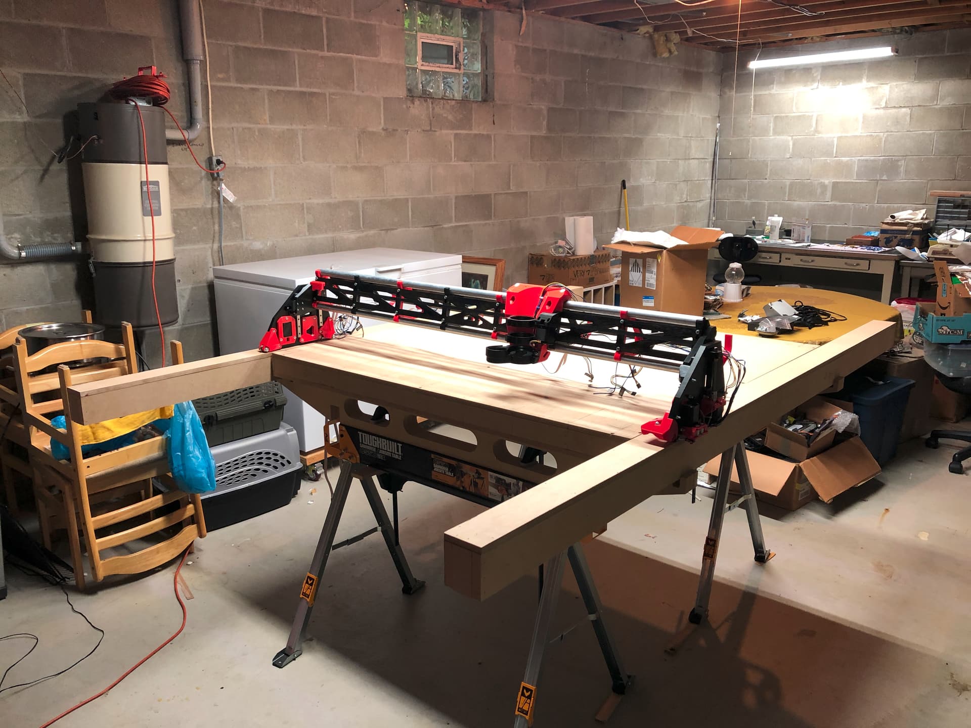

Success!
Zip tied sharpie was a little wonkily attached, so the cross looks a little trashy… but that was the pen moving, not the machine doing something wrong.

So two oddities i noticed… Maybe i just missed something in the documentation…
1.) If i auto home from anywhere past about half way down the table, it will fail and ask for reset. Is this something like i need to set bed size in Marlin and re-compile?
2.) When the above happens, if i hit the reset button on the TFT35, i’ll lose power to the Z stepper only on the one side. This causes the gantry to crash down… not a problem with just a sharpie, but definitely will be a problem if there’s a tool in there. Any idea what’s going on here?
1, yes. Or just drive it a bit closer before homing. I end all my jobs at 0,0 so I am never far from home.
  1. The bed size in default V1 firmware is defined as 600mm by 600mm. It will fail if you try to home it from outside of that range. Yes, you can redefinine it and recompile the firmware, but so long as you move to within this area, you should be able to home just fine.
  2. Actually all the motors lose power, but it probably only drops on the side that the router is on. You want to avoid this with anything under the tool, of course.
Like Ryan said, ending jobs at 0,0 probably takes care of this. In the Estlcam basics page, you’ll see this is set up to end the job above the origin point. I do have times when my origin point is outside of that range, like when cutting multiple copies of a job in various places on a sheet of wood, but I will drive the machine close to the origin using the LCD before homing it again. Een though in my case, my firmware will home the machine from anywhere that it can physically travel to, I still drive the machine closer, because the homing motion is much slower than my rapids motion.

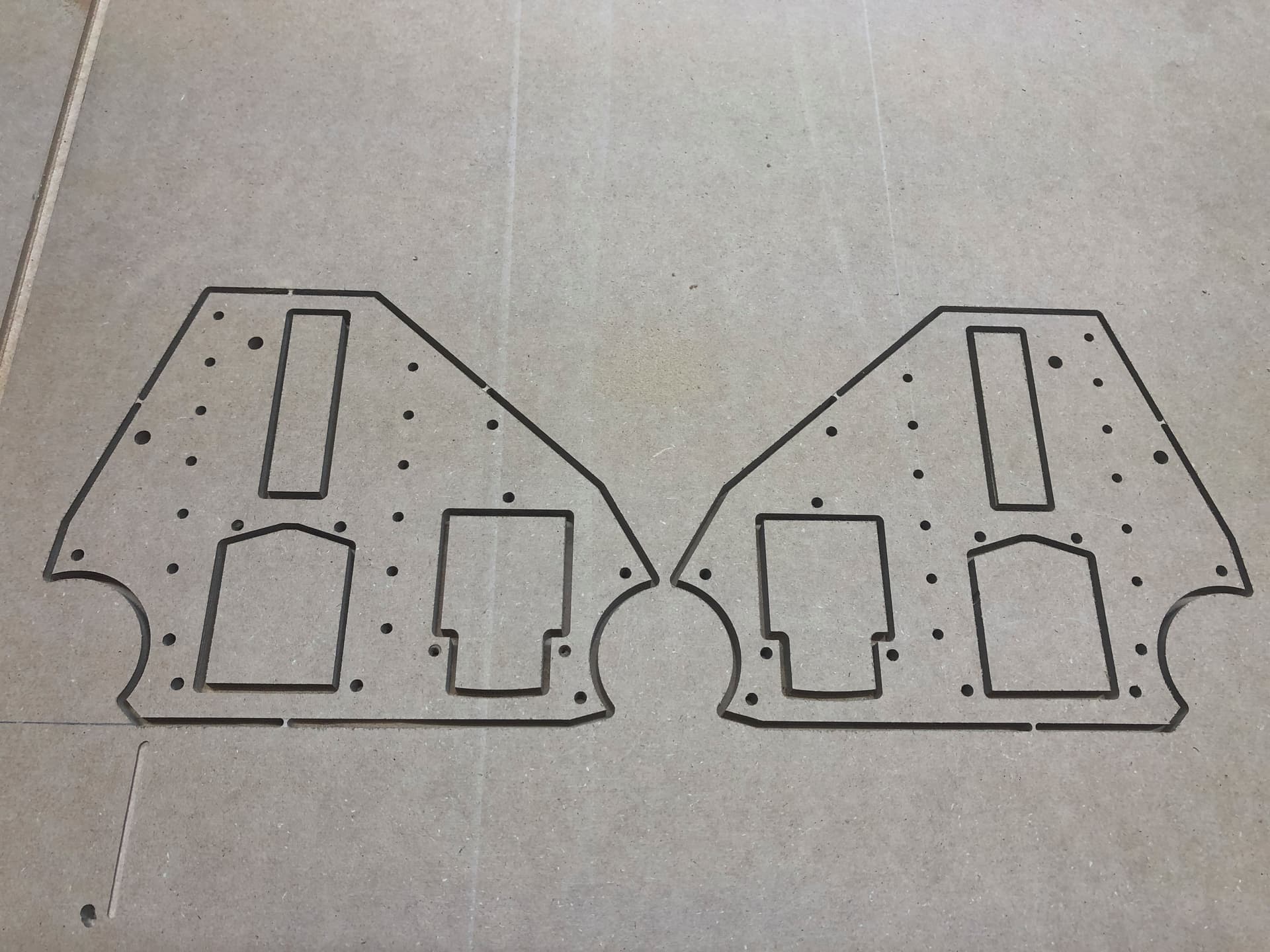

I ordered myself a 1" surfacing bit because i had a pretty bad dip in the middle of my table top. I used the surfacing gcode generator here (G-Code Test Pattern Generator) which worked great. Was just playing around w/ speeds, but seemed to find a nice medium running at 2000mm/min at 90% stepover 1mm at a time for the rough passes, and then 2000mm/min at 40% stepover at .5mm for the finishing pass. Very little scalloping maybe .1-.2mm… barely can feel it.
So now that i had a decent cutting surface, i cut out my YZ plates out of 1/2" MDF.
Accuracy looks good!

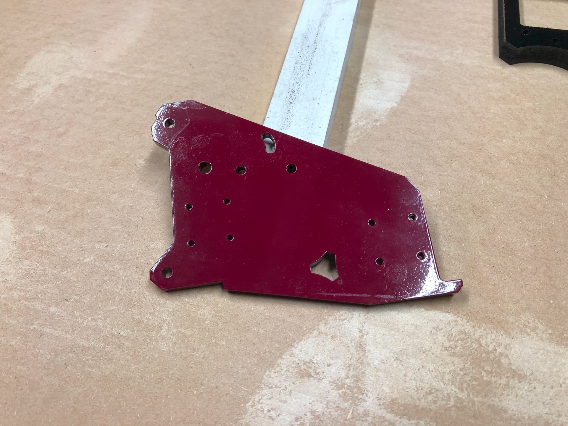

I also ordered the steel XZ plates, so painted those along with the newly cut YZ plates.
And they look great!
