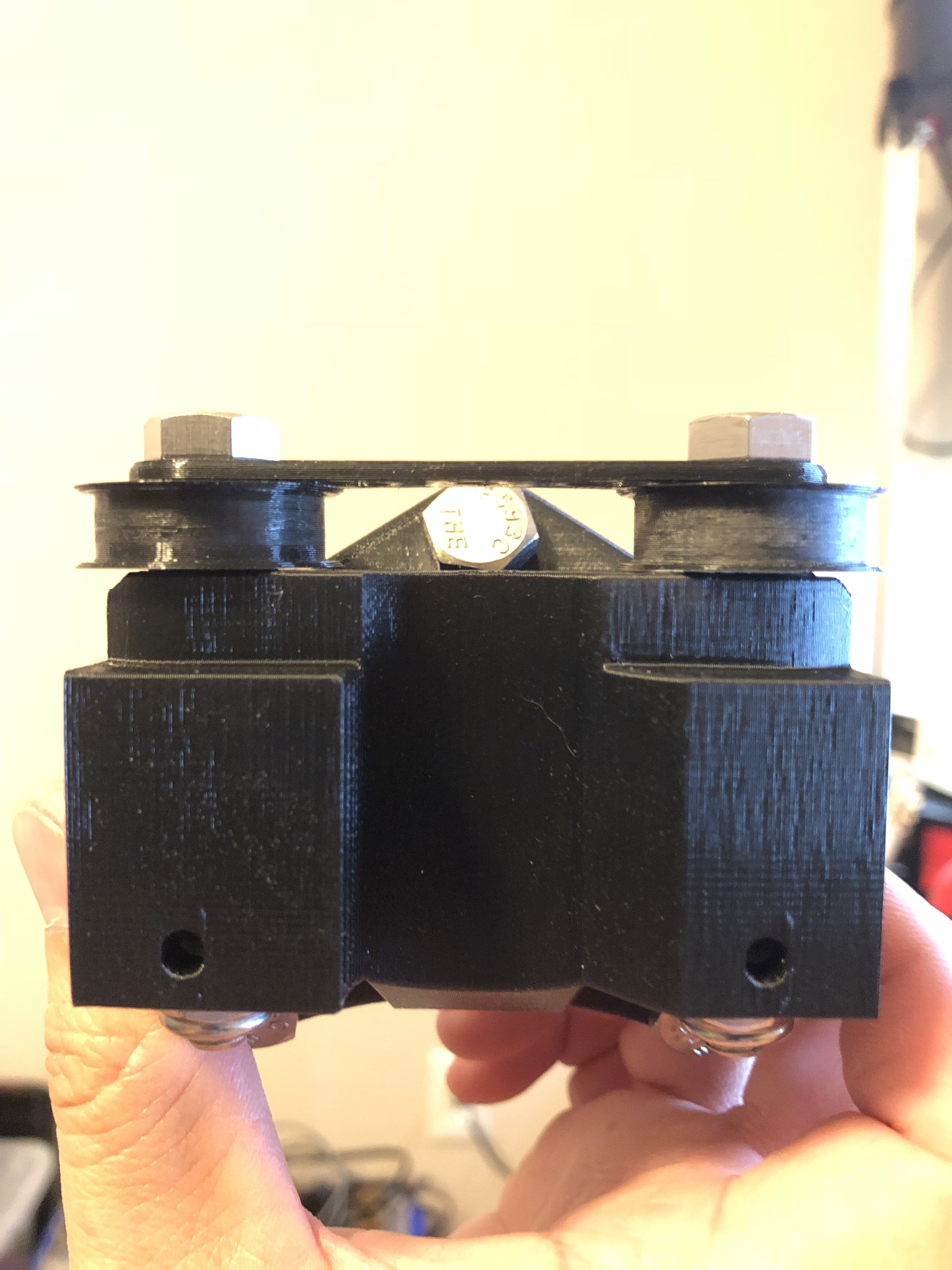

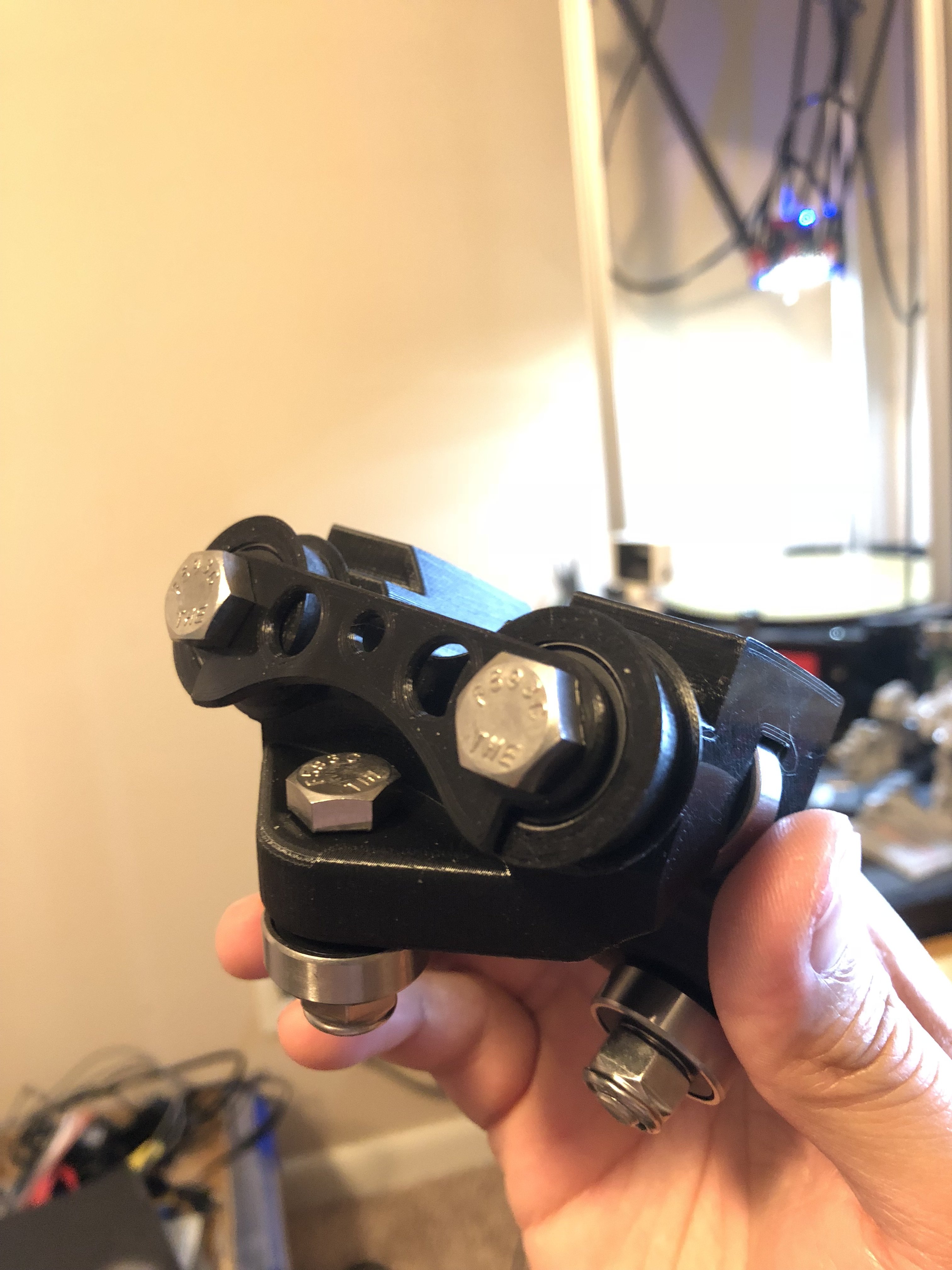

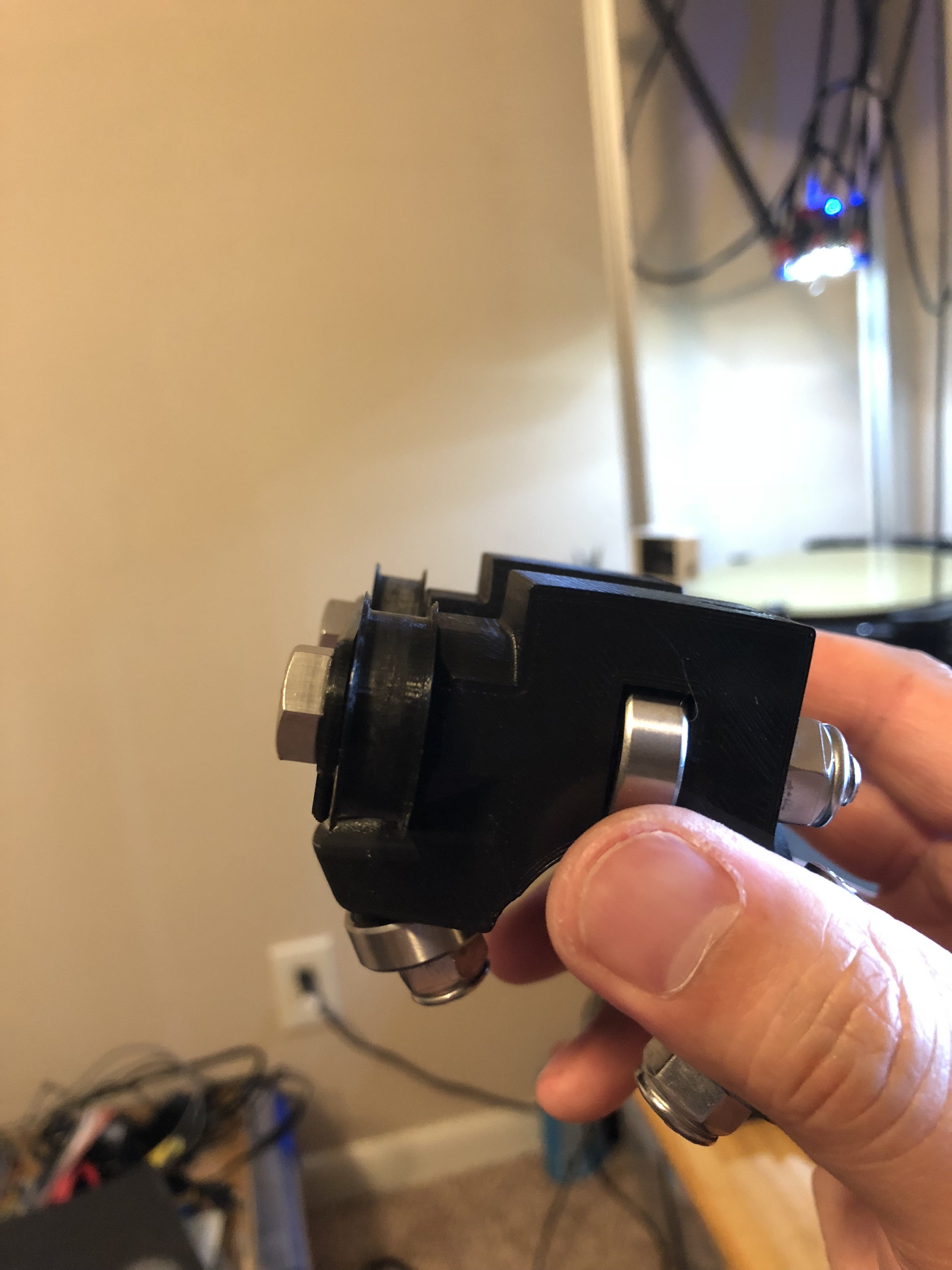

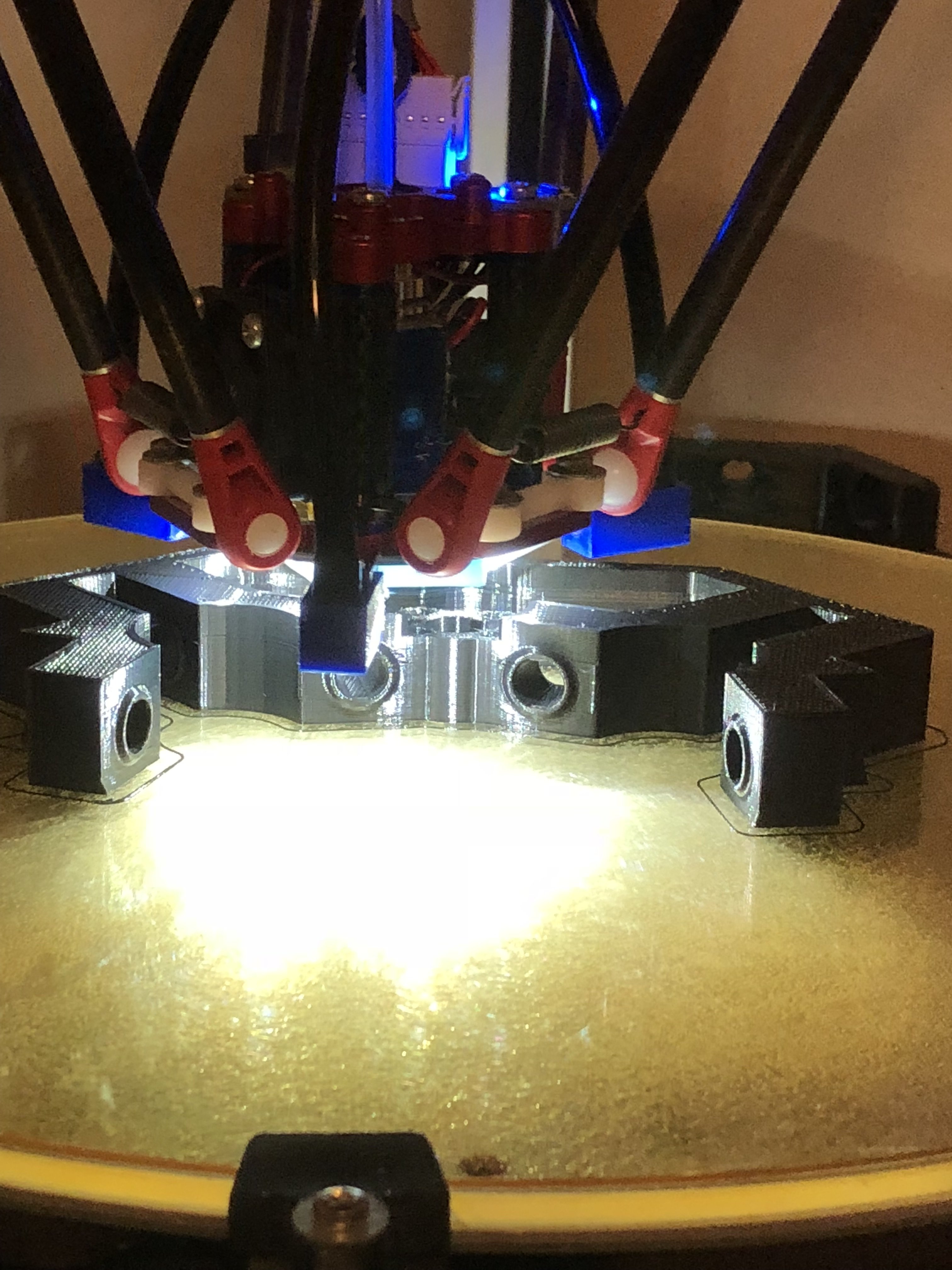

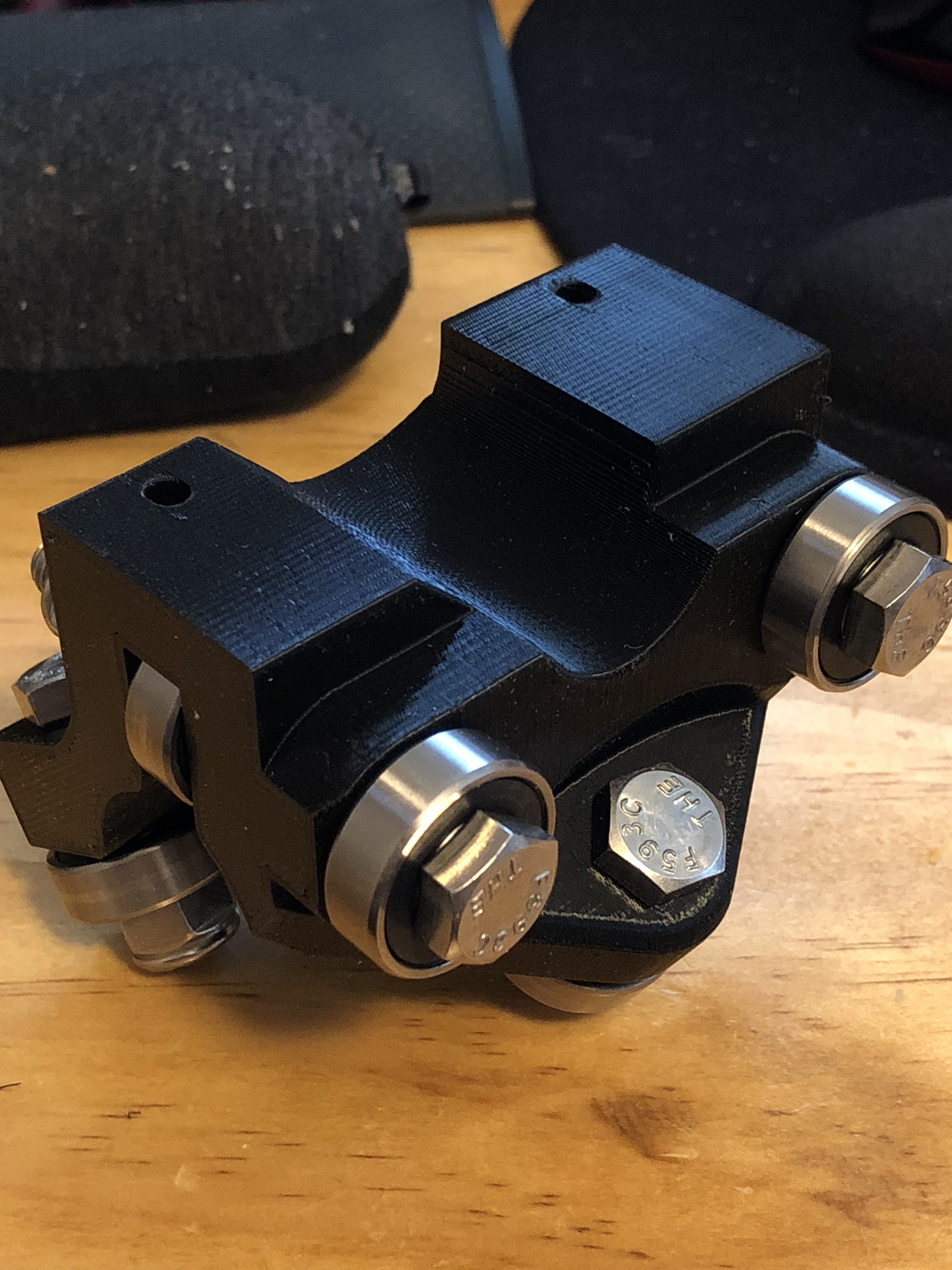

Some pics of a few changes I made and their output. I added in rollers for the belt to glide smooth since I noticed slight belt rubbing against the roller when moving back and forth. The pulley keeps the belt in track and lowers drag resistance. I had to print “precision shims” to space the bearing away from the roller mount. Overall 3D Print looked much more appealing and much more solid.
