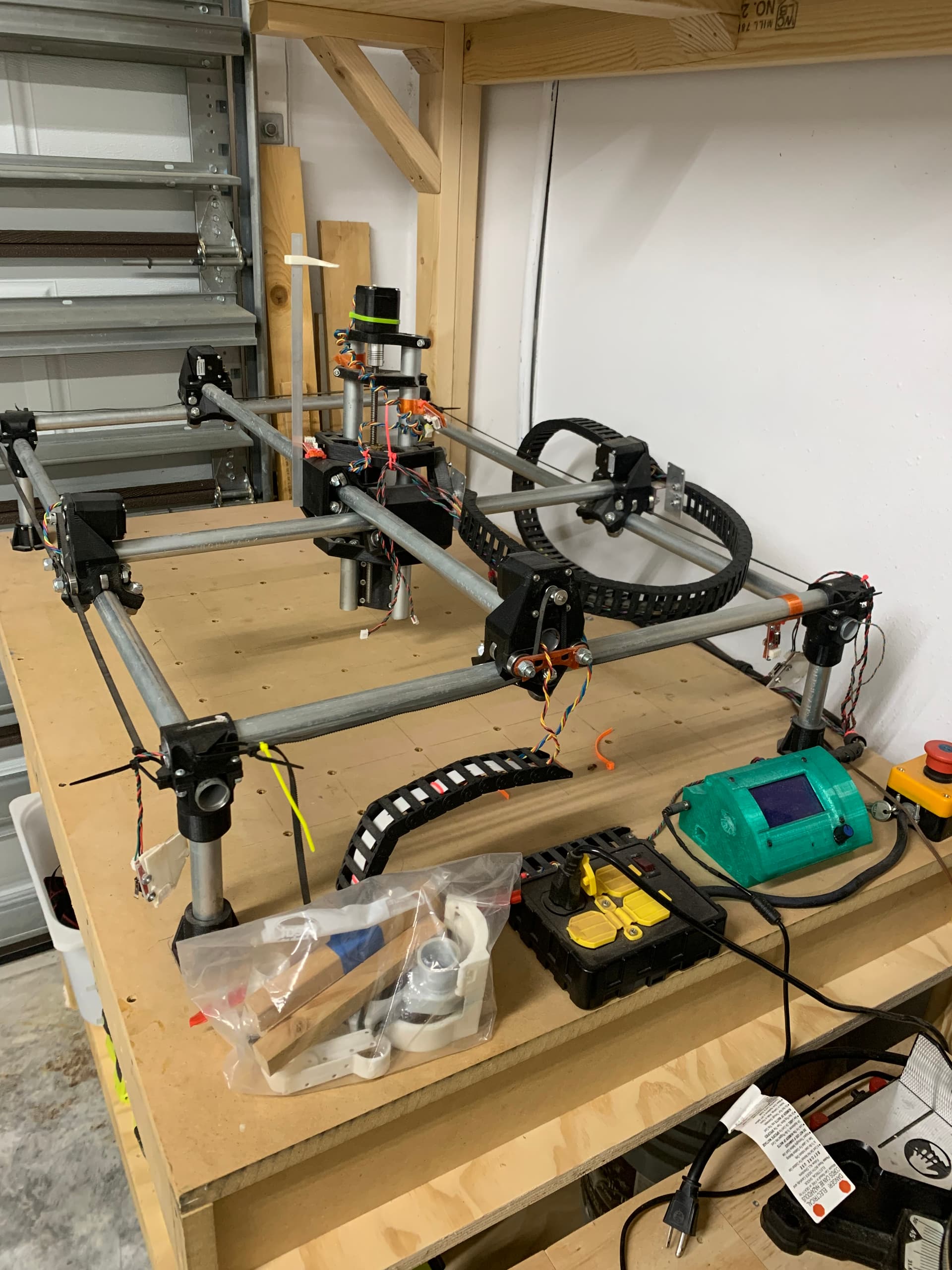

  1. Which specific model is this? It appears to be a Burly but from reading the forums, there are different versions, and even some earlier that I may not be aware of… I’ve attached an overview photo. If any close-ups would help, I’m happy to take more.
  2. Based on the answer to #1, since the upgrade kits from Burly to Primo are no longer available in the V1E shop, where would be the best place to source parts? So far, I’ve been able to find bulk bolts and screws at a reasonable price from McMaster-Carr, and the Pulleys/Idlers/Belts either from the V1E shop or Amazon.

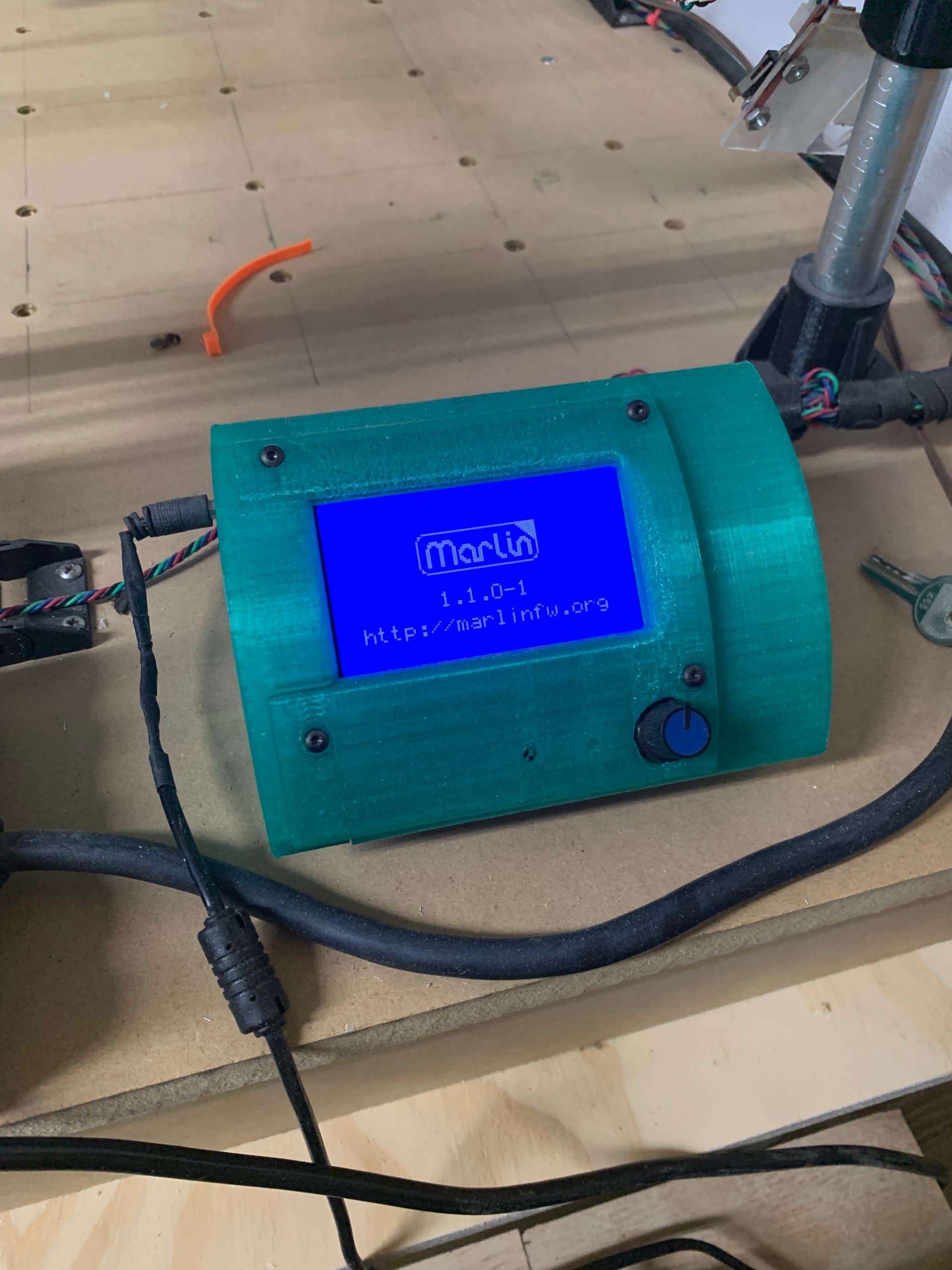

  3. Can the controller be identified from the photo? As you can see it’s running a super old version of Marlin (1.1.0-1). Is this directly upgradable to a more recent version?

It appears to be the older Burly model. I’d open the controller box and look at the board, could be anything, as a lot of DIY’ers used various boards and displays and modified the firmware for the board they had.

If you are really interested in this as a hobby I’d recommend just upgrading to the Primo.
Either way, make sure you are shortening the legs to minimum size, you are not going to have a lot of fun like this. :sweat_smile:

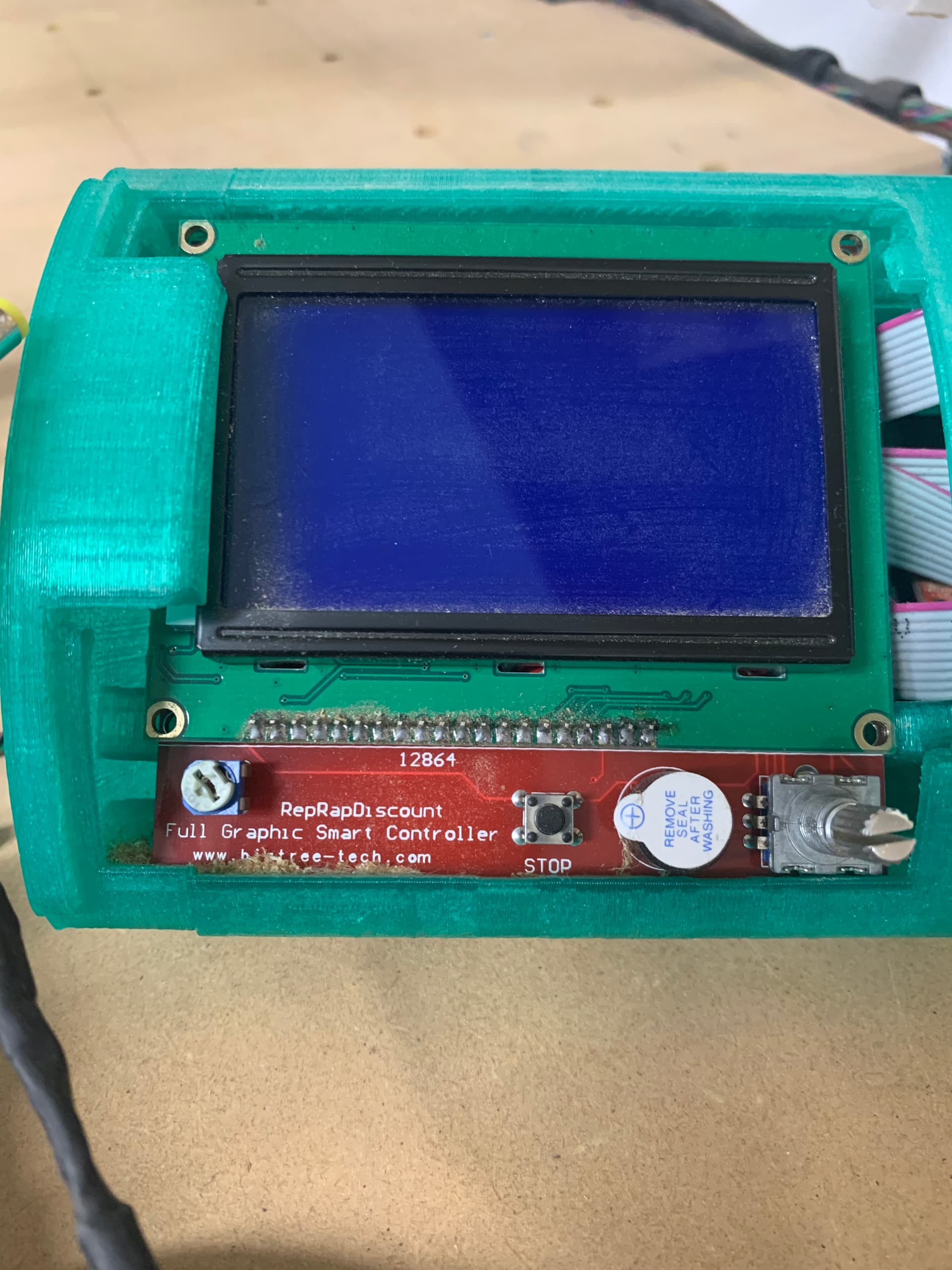

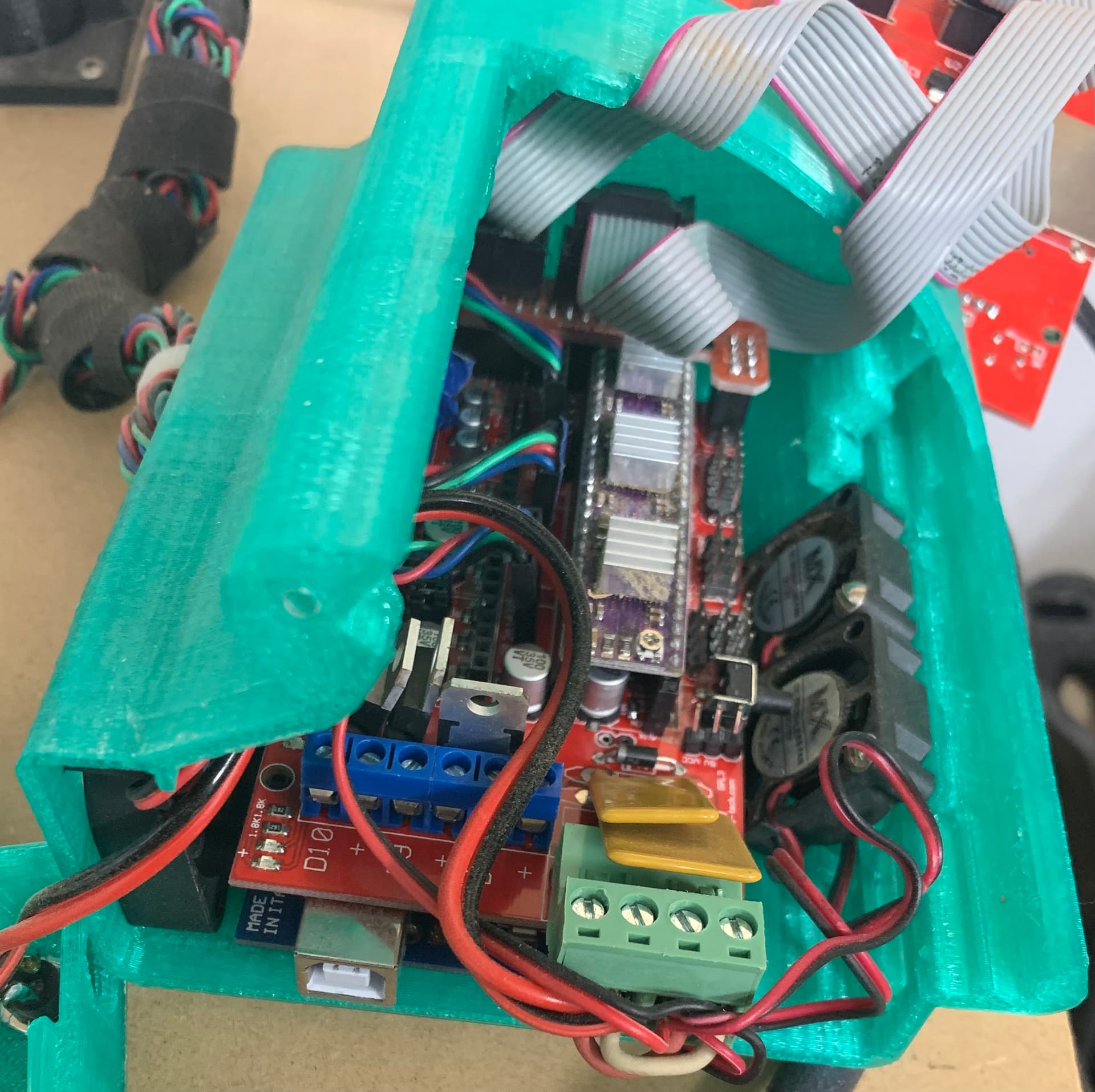

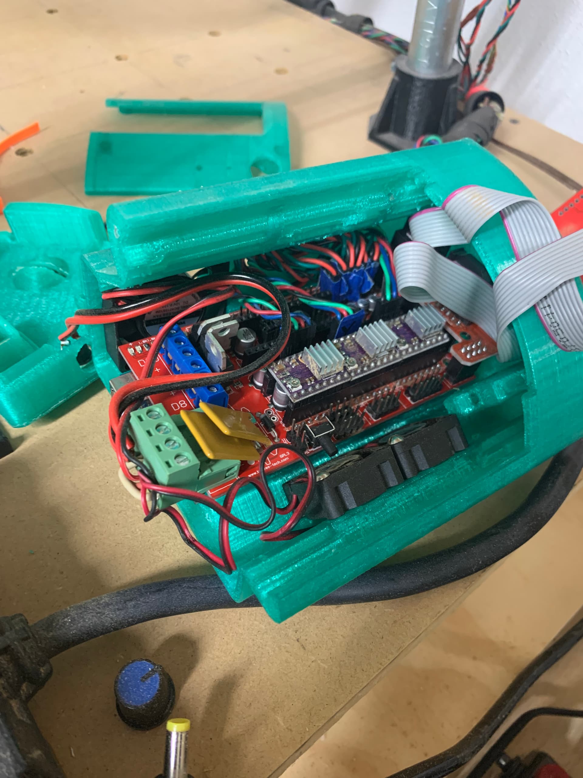

Here’s a few photos of what’s inside the controller housing. Couldn’t wiggle out the bottom boards, they seem to be glued in place. Maybe someone can identify from these? (Thank you!)

Ramps 1.4/Arduino Mega. ReprapDiscount 12864 display.
If you use dual endstops, I believe the correct firmware is below (Someone wil correct me if I’m wrong)
https://github.com/V1EngineeringInc/MarlinBuilder/releases/download/515/V1CNC_Ramps_Dual-2.1.1.zip

Ryan somewhere explains it in the manual. The longer the legs, the further the router needs to travel away from the core before cutting, so there is more chance for play. Not a good explanation, but maybe it is sufficient.
Some observations:
  • I only see three heat sinks → implying only three drivers → implying serial X/Y motor connections → implying no (or useless) endstops. (I suppose I should elaborate: you need five [5] drivers to use endstops for squaring. With just three, there’s no way to move only one side of an X/Y gantry, they always move in tandem. SOP is to set up hard stops that are known square, move [slowly!] the gantry against the hard stops, then turn on the machine, allowing it to start at a known square home.)
  • Longer legs mean the bit is reaching further from the plane of the gantries (the median of which is the plane of greatest rigidity), and therefore the more torque can be applied to the moment arm of the Z-axis just by the simple action of cutting stock. You can alleviate some of this by putting your stock up on blocks, and keeping your cuts as close to the gantry plane as possible, but then you have a large amount of Z-axis sticking up, generating inertia, and potentially causing issues if anything pulls on it. General best practices say go for short legs with a removable spoil board for thicker stock/vertical milling, and be very, very mindful of anything you attach to the Z-Axis.
  • The Z axis/Tool holder for the Burley can fit in a Primo, but it’s not an exact match (IIRC), so you may need to either rebuild that portion, or Frankenheimer it.
  • The Burly specs 6mm belts, the Primo specs 10mm belts. So, technically new belts, idlers, and pulleys. Ask how I know…

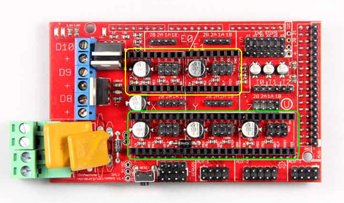

To fully use the auto-squaring capabilities of the firmware, each stepper needs to be individually controlled as well as having an associated endstop switch.
So, you’d need to populate the two empty stepper driver locations on that RAMPS to fully use dual endstop firmware. I’ve marked those spots up in yellow below.
I prefer not to use series stepper wiring for a variety of reasons, and the drivers are really inexpensive- so I’d probably add them while doing the rebuild (if you stick with the RAMPS, which is fine for now)
I appreciate the advice here, thank you! It took me awhile to digest this info while diving more into the hardware (as I was waiting on tool and material shipments). As you guys noted, my current Burly is wired for series stepper motors since single drivers are installed. I would need to add the two new drivers (and jumpers) to the E0/E1 on the RAMPS 1.4, so that these correspond to the X2 and Y2, correct? Then these would need to be defined in the Marlin firmware as well (which I think there’s a version for duals already). I’ve decided to go ahead and add everything from the start, so I don’t have to mess with it later. This includes the independent motor control and all 6 endstops (X, Y and Z, both min and max) unless there’s a compelling reason not to… I figure it’s easier to do it all at once and wire management would be simpler.
