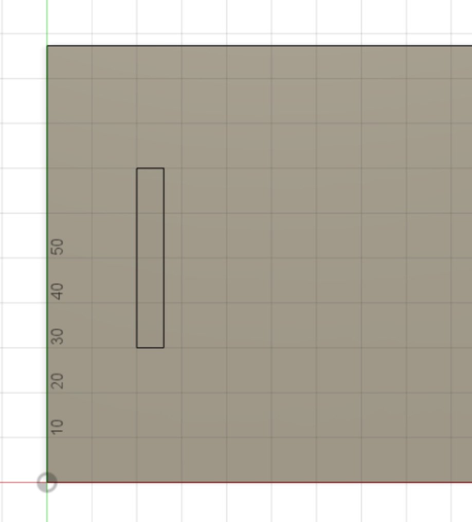

Hello, I am doing some cutting tests and I wonder why this happened:
  • First I made a cut in a wood of 40mm x 6mm with a 3mm bit and 2mm depth.

  1. The pattern I would expect, since you’re cutting a square hole with a round bit, woild be to leave some material in between, but right in the middle, cut through exactly.
  2. The alignment between the two cuts looks ok.

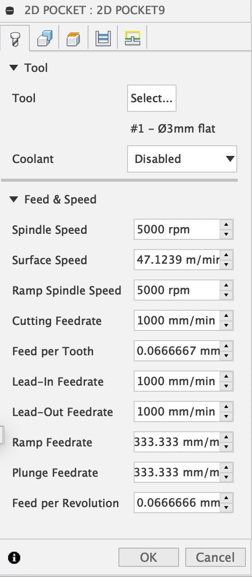

  3. You’re not cutting well, and you’re leaving a lot of material. This could be some flex in the machine, spindle, going too fast, not enough rpm, or a dull bit. Can you load up some HD foam and try it again? That should remove all the load and split the problem space up.
Cutting specs and speeds, router, and bit that you use? That looks pretty far off from normal.
Hi Ryan, I am using this spec in Fusion to make the g-code, the router is MakitaRT0700CX4 I set speed to 3500rpm

You really should start with Estlcam. From a glance at your settings (too many to check them all) You are plunging too fast moving a bit too fast and you are (90%) slotting from some reason. I promise you will benefit greatly from starting with estlcam and we can actually hep with settings. Fusion has soo many setting no one can possible check your work without spending a ton of time in your actual project file.
You have “stock to leave” checked and filled in at .5 mm, therefore, that cut operation will leave .5mm all around for a finishing pass, that’s probably why it’s not a complete cut.
The makita’s lowest speed is 10k RPM, do you mean 3.5 on the dial?
Hi Aaron, yes 3.5 on the dial. I though was 3500rpm. is it too much?
The dial is unloaded speeds, once it hits the material, it will slow down a bit.
