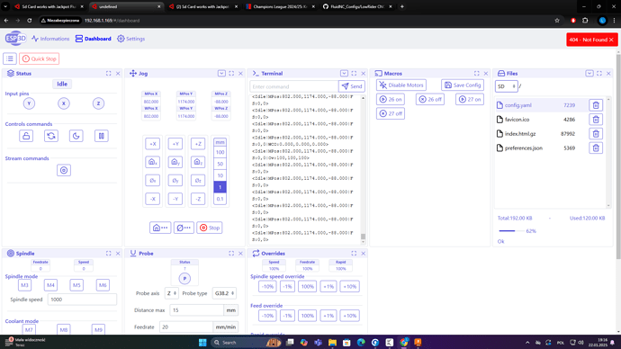

Hello Everyone,
I’m slowly completing my build, my problem is as stated in topic sd card works with v2 ui and not with v3. Any advice will be appreciated

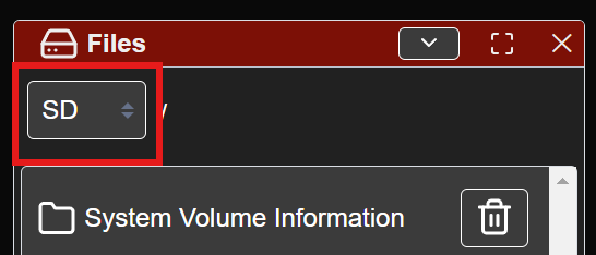

Make sure you are looking at SD and not FLASH…
Oh, I wish it was that simple:) When i press sd card on v3 it shows fault: 404 not found .

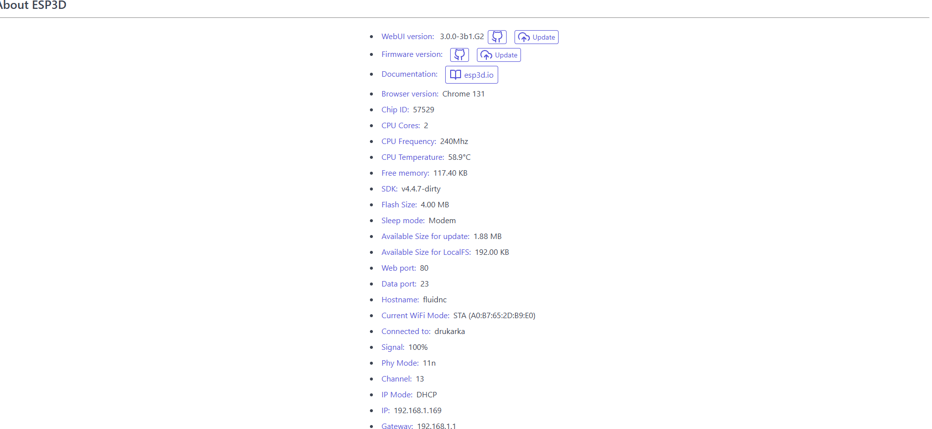

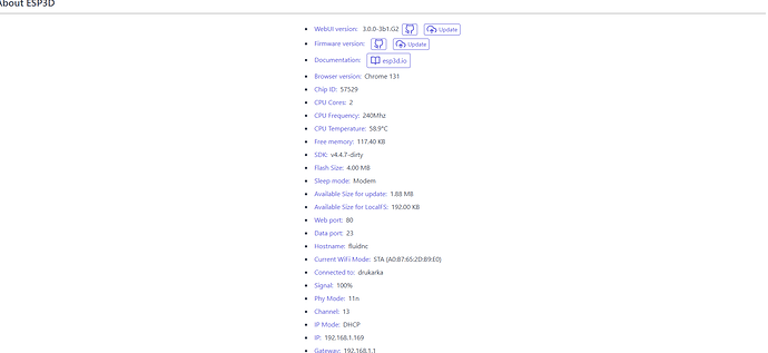

What version of FluidNC do you have and what specific version of the WebUI? It doesn’t really make sense for SD to work in v2 and not in v3.
Fluidnc is version 3.9.4
web ui version is:3.0.0-3b1G2
and i downloaded all configs from: FluidNC_Configs/LowRider CNC/UI V3 LRCNC at main · V1EngineeringInc/FluidNC_Configs · GitHub
I’m a little behind on both versions but that should be fine.
Can you post a screenshot of that?
Also, what is the output of $SS? That would show if there was an issue initializing the SD card.

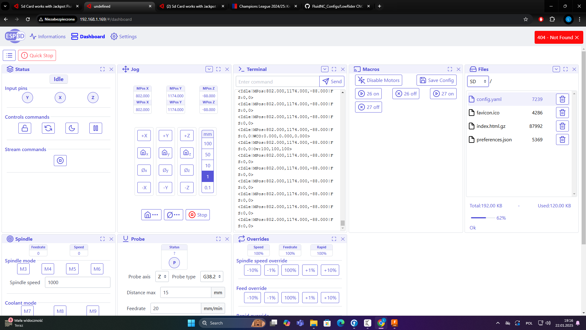

That all looks ok. What stands out to me is that in the upper left corner, it says ESP3D instead of FluidNC. Try the index.html.gz from here. This is the version I’m currently using.
No it isn’t. That’s what I was thinking might be the cause.
v2 and v3 use different preferences.
Download it and delete it.
Then try switching to v3.
That worked. Thank You!
