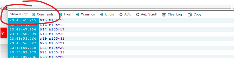

In Repetier-Host, use the following settings in Config->Printer Settings on the Connection tab. And set the Com port to whatever Windows assigned to your board.
You should be able to send gcodes on the manual control tab. Make sure to use UPPER CASE commands. Official gcode does not recognize lower case.
You should also turn on commands in the log to be able to see both sent and response commands.

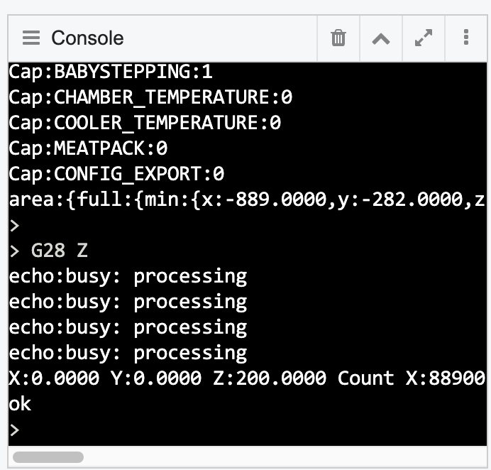

Try this on your Mac. Connect the USB.
Go to Apple->About This Mac
Click More Info…
Click System Report
Click USB
I see this when the board is connected:
With that, you know that the Mac recognizes the port

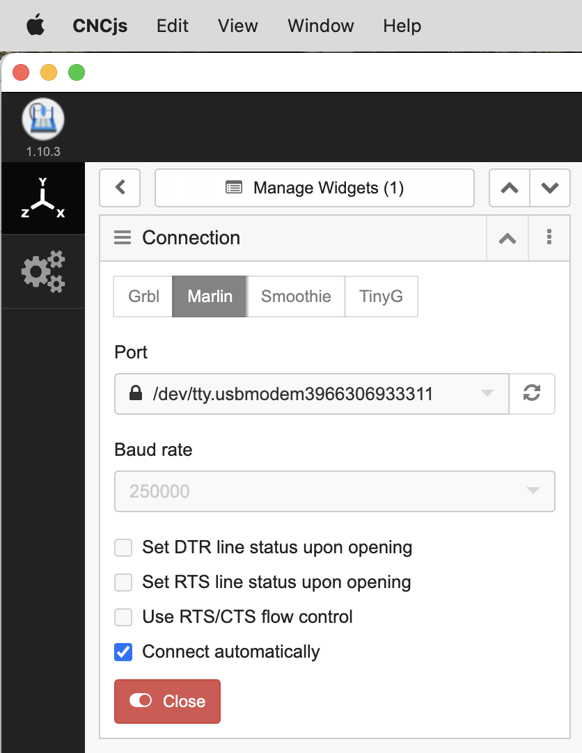

Open CNCjs and use the Connection widow.
Select Marlin
Click the reload button (2 spinning arrows) next to Port
My board connects as /dev/tty.usbmodem3966306933311
You can enter GCODE commands in the Console window
