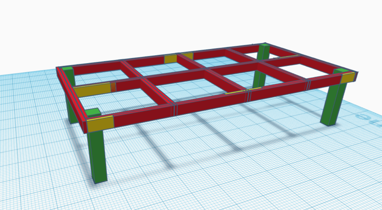

So I am also working on my table design. Since I have a tendency to overthink things, I am going to put this out there. When I am working on the Y sides of the table I am thinking of putting a piece of 3/4" angle down the side of the board. I want to put a full sheet of ply for my spoils board, so I was going to build the table around that and this is the long side side rails. Once I have the Y sides done, I would cap each end with a 2x4. Then drop the spoils board in so that the top of the spoils board is even with where the bottom of the wheels on the Y axis are. Would this work? or is this just overthinking the table aspect of this?
I was thinking that I would make my own 2x4 out of plywood. They would be 3.25" by 1.5". This may be overkill, but my thought is the multiple strand orientation would limit warpage, and I just don’t know if I could get the same precision with 2x4 lumber.
I am building my table to be 56" x 112" rather than 56" x 111" as requested by the calculator. The thought here is that math is just easier with the even number, and when the width is twice the length.
I still haven’t figured out the best way to skin it with a top layer. I am trying to wrap my head around minimizing waste. This maybe largely because I was planning on using the expensive plywood for the top too. I could use MDF and decrease my costs, or I could add other struts along seem lines to allow for optimization.
Ug.
Anyway, I have some thoughts:
https://www.tinkercad.com/things/49fBrFzCNgj-low-rider-thoughts-001
And if that doesn’t work then I have some pictures…
My table is something like 3’x5’ and I used plywood inside. If you are comfortable with it and you know how to rip it straight, it is a very good choice. I had a similar torsion design to yours, but I didn’t double anything up, and the supports were about 15" on center. I used 1/8" or maybe 3/32" hardboard on the top and bottom. I added a piece of 3/4" plywood to the top, and it overhangs the torsion box by a foot, so my total size is about 4’x5’ for cutting at least 3’x4’.
Your design looks good, although you’re cutting it close on thickness and it will probably be more than strong at 2.5" width on the supports.
Re: your questions about seams and full sheet tables, you can order in 10 foot x 4 foot sheet stock here so I made my table 10 foot and just had one seam on the skin down the side lengthwise where I butt-joined the skin sheets. I went with a 4" high table made out of ultralight MDF with 1/4" skins and 1/2" webbing spaced 11" apart. If I could have gotten 1/8" in 10 foot I might have done the skins with that like jeffeb3 but I didn’t want 3 seams on my skins. I only had a couple mm sag with this suspended from the ends so if you had 4 legs positioned as discussed above ( in from the corners not at the corners) I think you would not have any measurable sag at all. I think the most stress on the skin is in the middle so I put my skin seam as far to the side as possible… no problems so far for me. These tables get crazy heavy pretty fast… even with my setup I am at 150 lbs just for the table top.
