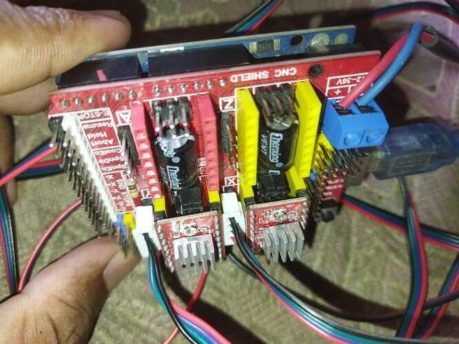

I don’t have good knowledge about robotics. Now I bought Arduino Uno, CNCShield + A4988, and two Stepper Motors NEMA 17. Now I want to know

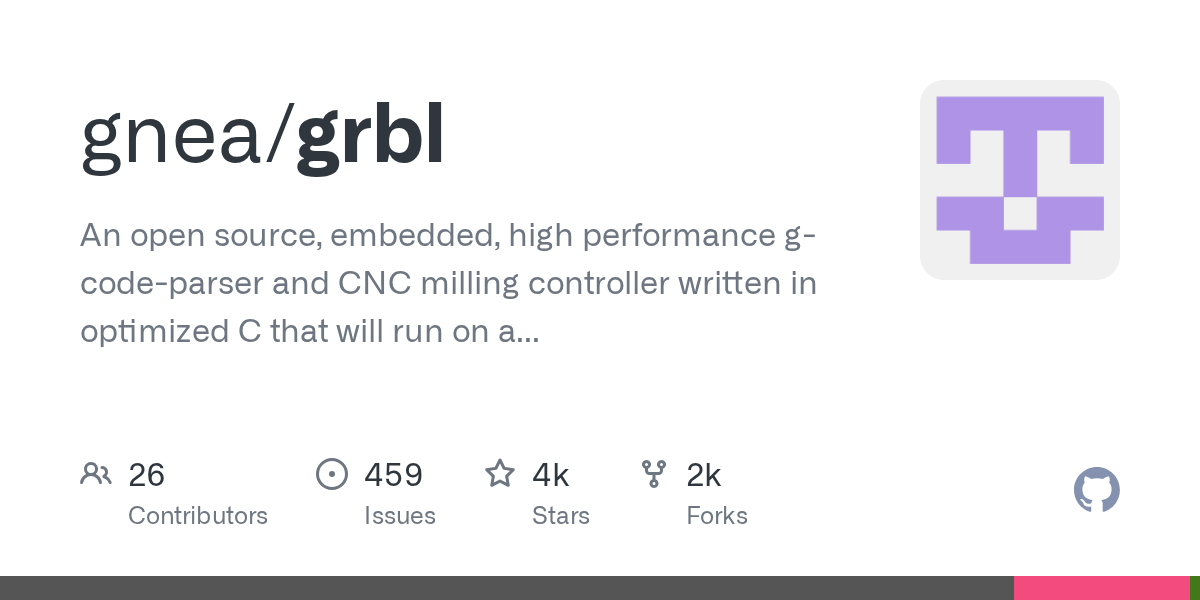

  1. Can you send me the correct GitHub link for Grbl that you mentioned?

The link Tom sent seems fine. I am not as familiar with it as Tom. So I would trust him.

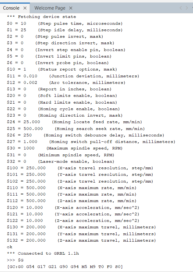

I followed the instructions you gave exactly. But I still couldn’t control the robot properly when I was given a design. If you can, please provide me with a G-code that you know.
to check whether the GRBL parameters I am using are correct or not, I will add that to this message as well.

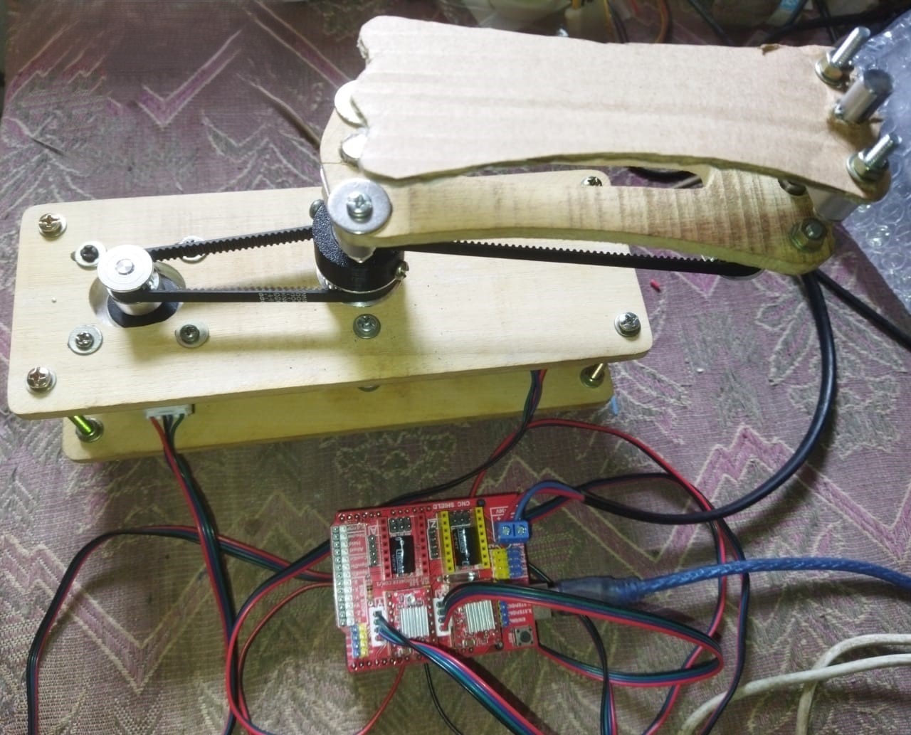

and images of the robot (arm length=115mm, cnc shield microstep resolution = 1/8, Gear ratio of both axis 1:3)
Where did you get these numbers? Have you tried manually commanding one rotation with G1 X6? I’m guessing that may be problem #1.
You also need to zero it before you start. Do you have a method for doing that?
First, I uploaded the Releases · gnea/grbl into the Arduino board. And after that, I go to Universal G-code sender. It shows parameters as below in the console…
I change it according to my knowledge. I don’t know, it is correct or wrong. What should I do now?

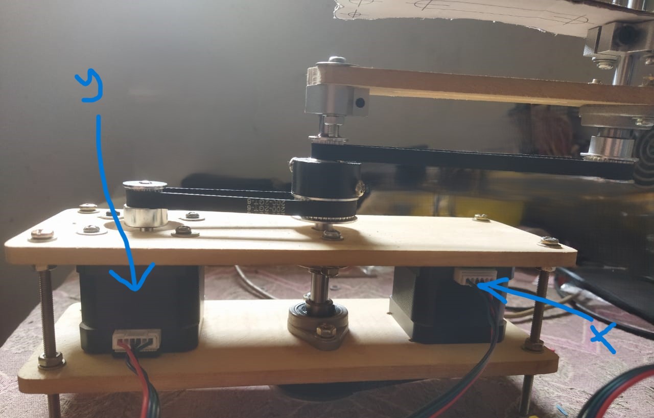

when I give G1 F50 x6 to robot using UGS console, 1st arm rotated 1 round but not 2nd arm any move.
when I give G1 F50 y6 to robot using UGS console, 2 nd arm rotated 1 round but not 1st arm any move.
That should be right. Once around (should be very close to exactly one revolution). The math on the sandify wiki comes up with something closer to 533 steps/unit, not 800. But your ratios are different.

I’m happy to say that I tried this on Christmas Day, and I solved that problem. The problem was that I had set the robot’s y-axis motor to move in the wrong direction and set the wrong value in $101 (Y-axis travel resolution, step/mm).

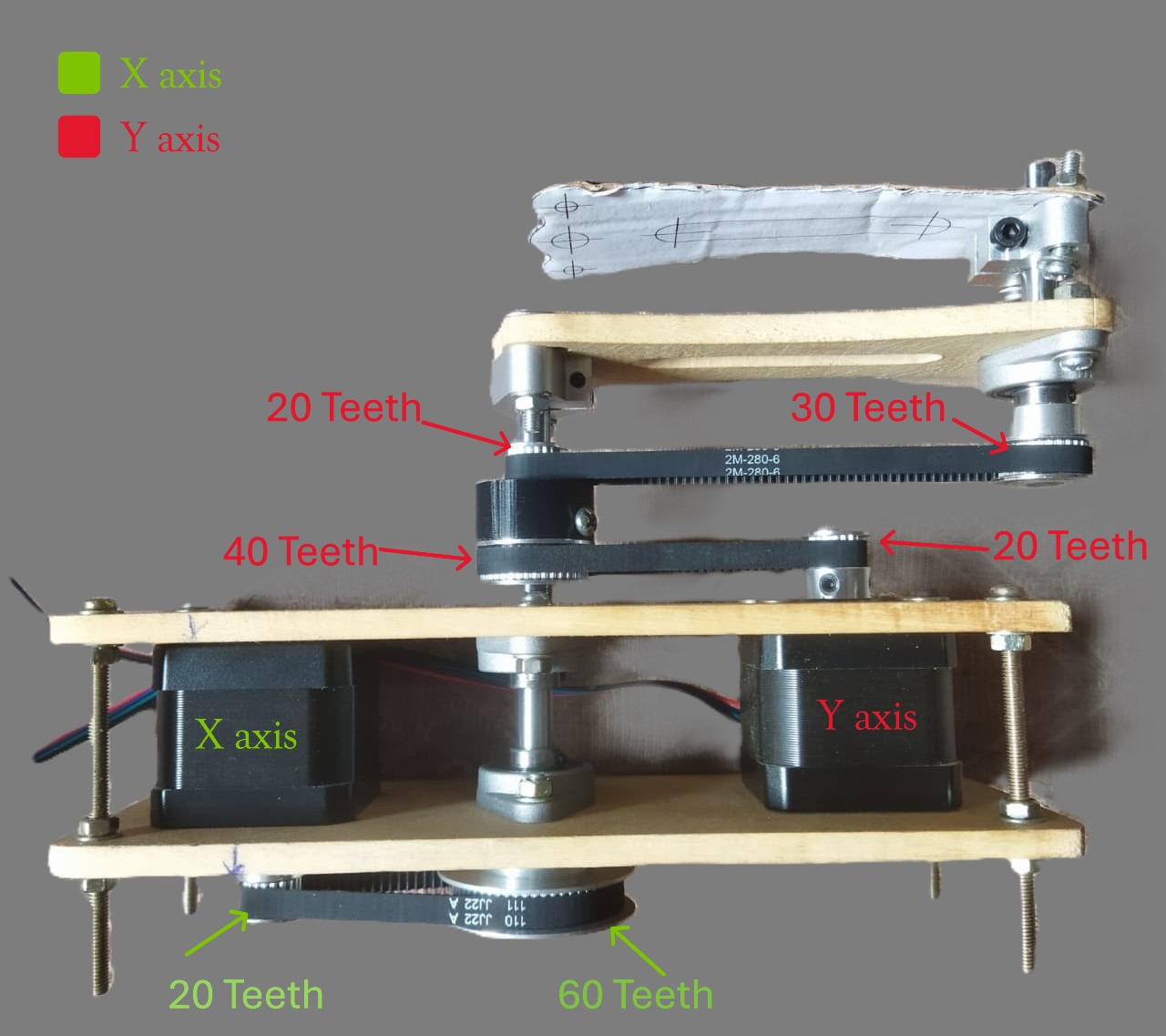

Now, I need to confirm and set the value of $101 (X-axis travel resolution, step/mm) & $100 (Y-axis travel resolution, step/mm) of the two motors on the X, Y axes of the robot. I need your help for that.
I designed the X-axis (shoulder arm) of my robot as follows,
Motor=Nema 17
X-axis microstep size in CNC Shield =1/8
gear ratio= 20:60 (1:3)
I designed the Y-axis (elbow arm) of my robot as follows,
Motor=Nema 17
Y-axis microstep size in CNC Shield =1/8
gear ratio= 20:40 (1:2) and 20:30 (1:1.5) (overall 1:3)

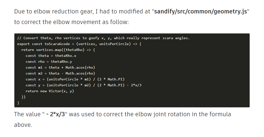

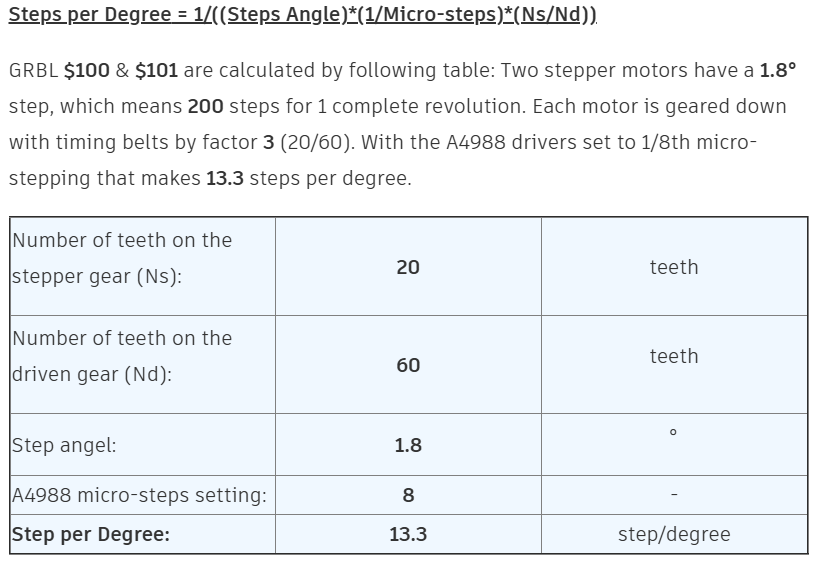

What are they currently set to? What is the current behavior? What have you tried? I don’t know much about SCARA but I think you are trying to set it to steps per degree? or maybe steps per radian?
Looking here, it seems that maybe you need a value of 13.3? I may be completely off base here.
D.I.Y SINGLE ARM SCARA ROBOT : 8 Steps (with Pictures) - Instructables
I won’t be able to help much here. I’m in planning stages of creating a scara bot, but my plan is to use a coaxial stepper and an unreleased FluidNC build where it will use cartesian coordinates in gcode and FluidNC will handle the translation.
This is how I work it out:
200 steps / shaft revolution * 8 microsteps / step * 1 shaft revolution / 20 teeth * 60 teeth / arm shaft rotation * 1 arm shaft rotation / 6 “units” = 800 microsteps / 1 “unit”.
So 800 looks right to me. I computed 533 for my imaginary machine, but that assumes 1/16 microsteps and not using a 3:1 ratio.
I don’t see a reason your X and Y should be different.
Does the X axis affect the Y shaft? It seems like it would if that gear if firmly attached to the X shaft.

The Y-axis (elbow arm) of my robot has a gear ratio of 20:40 (1:2) and 20:30 (1:1.5). So, should I also do the following thing also my robot? (My robot still has a drawing problem with some designs)
That should all be handled by the steps per unit config value and it should be the same as the X.
