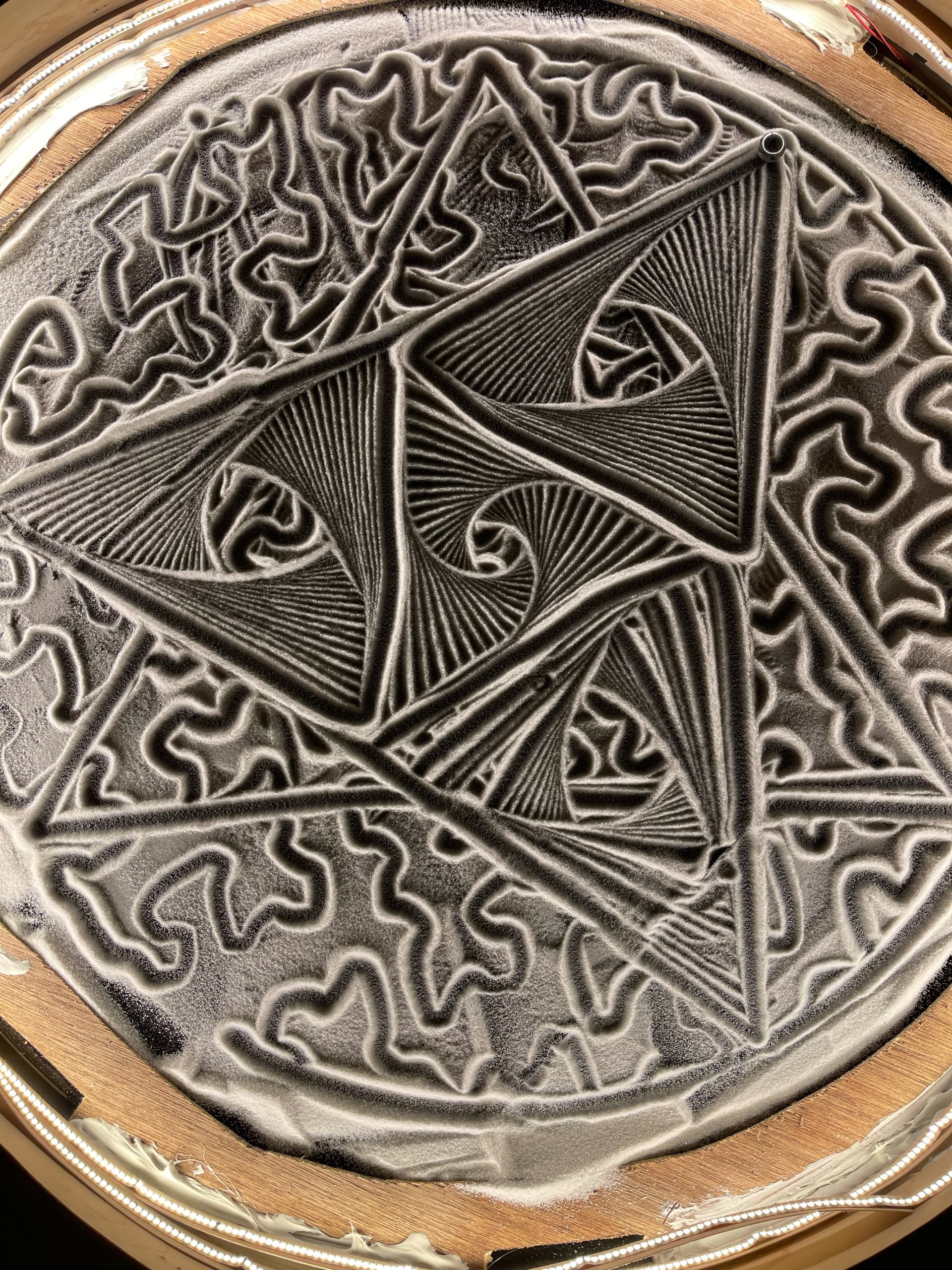

WE GOT IT!!!
That is so exciting
So I am not sure if this is a thing or not?
One of my motors points up and the other one points down.
So the wiring for each axis is different I guess?
And for sandify i needed to export as Scara and have a value of 1 for RHO.
CHECK IT OUT GUYS
Thankyou so much everyone
Now to finish the table up and get end stops working and a way to talk to the bot without plugging it into my computer
That looks an awful lot like a square!

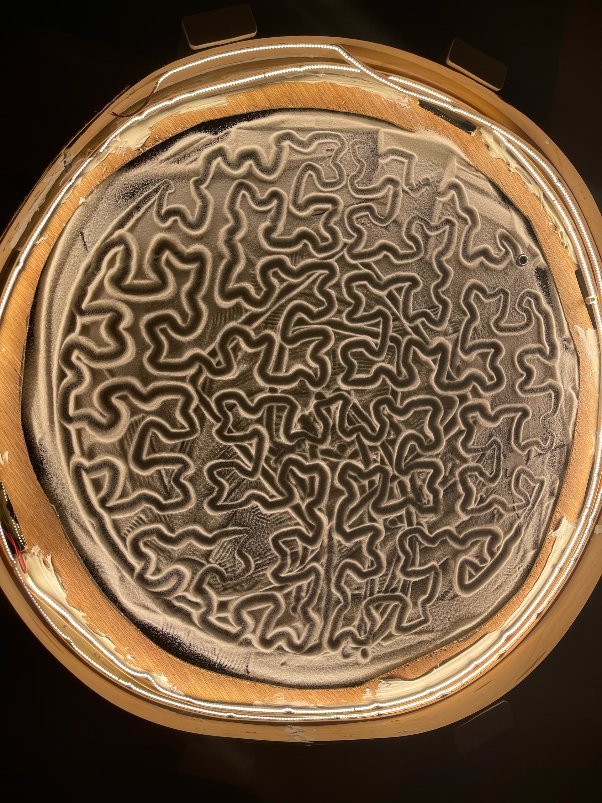

Two things I noticed:
  1. Is that scale about right? Try increasing the initial size of the shape so it fills the preview and make sure that ends up with a full size on your machine.
  2. I think both motors are reversed. The square should drive clockwise 1/8 and then drive counter clockwise through the square.
scale seems right to me. These other ones I did filled the area the bot could reach.
the image might be mirrored but I will double check on this.
You guys are literally the best thankyou so much for all the help. I am not sure what did it in the end. I did a fresh install of google chrome. Fresh install of Arduino ide. Fresh install of GRBL and UGS. I found the motors plug into the CNC shield in opposite directions ( at least with my build)
I still have a few things to work out here! I have to make the felt I have underneath the sand have 0 overlaps ( the ball gets stuck on the little ridges). I have to adjust the voltage for the drivers. I have to finish the wood working for the rest of the table and find something to put on top of this for a lid. I have to tidy up the LEDS and put them on a relay with a switch. I have to get something that will allow me to connect wirelessly to the table. I only want one power cord coming out of it.
