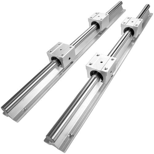

I am glad you are testing it, I have VEVOR Linearschiene SBR20-1200, Linearlager-Gleitset mit 2 Schienenwellen von 1200 mm und 4 SBR20UU-Blöcken, Linearlagerschiene mit Vorgebohrten Löchern, Führungsschienenset für Fräsmaschinen  | VEVOR DE in my sight for ages. :smiley:
I wish there was some easy way to make a guide or something to install one of these on both sides and keep them perfectly parallel . That would sure add some more rigidity by locking the machine down. I never take either of mine off the table so I don’t need the ability to remove like we have now.

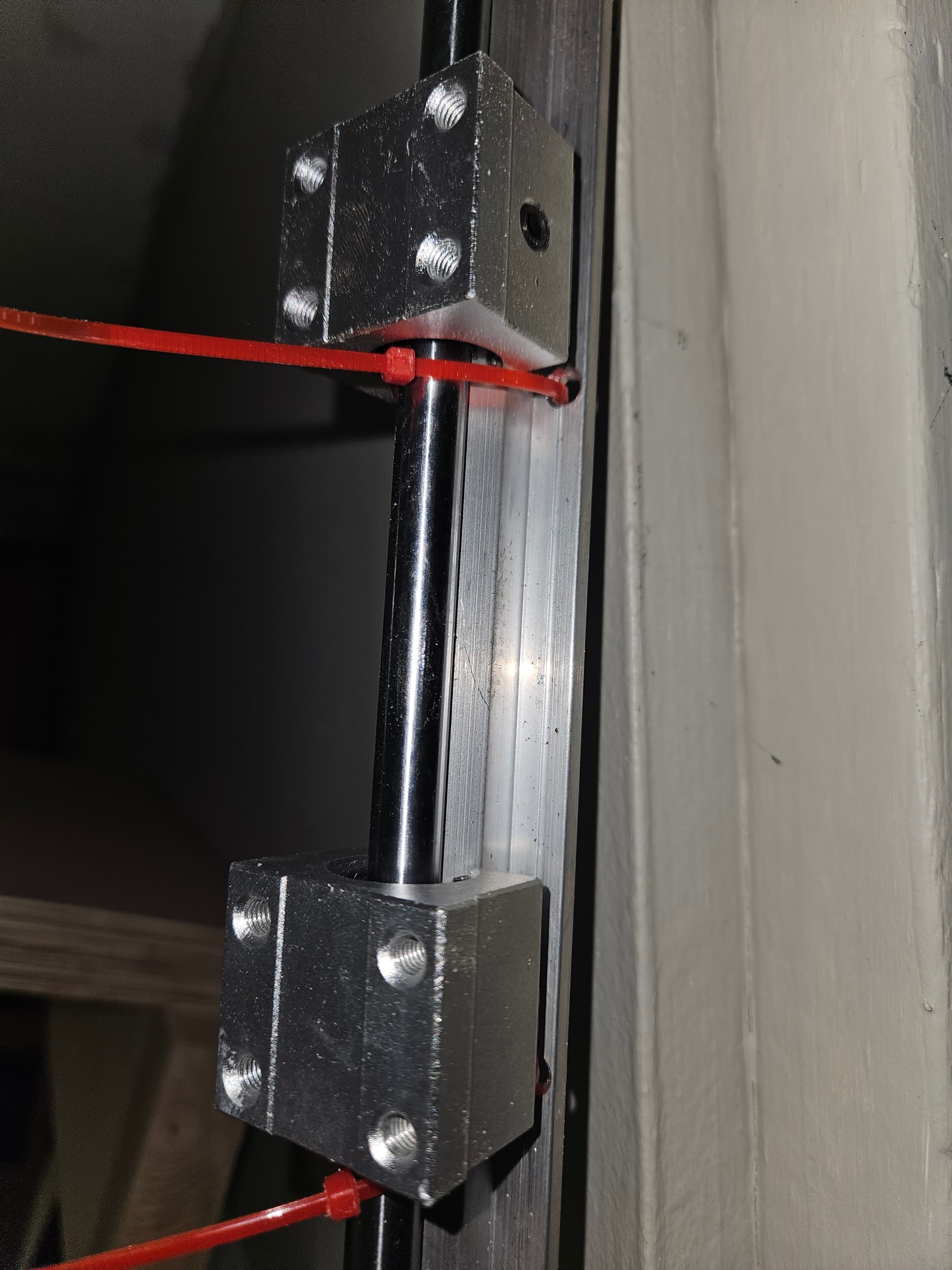

That’s a quick snapshot of the rail, I dont remember if I got 1.8m or 2m (I think 2m).
I just have to find where I put my calipers, then pull in CAD of the YZ plates and make rail riders that will work. I dont think I need more than a couple of degrees freedom in XY, but I’ll build for more than I will ever need. I’d love to build for a huge pivot, but of course I lose sin(θ) in usable X, so more than 10° swing isn’t happening. 5° either way is more than plenty anyway, and more than we would see with the current setup not having trouble, I think. Pretty sure Ryan didn’t think the rail needed that much freedom, and neither do I, but in this case because I am dealing with a fully captured rail, I do think it requires a more complex solution.
