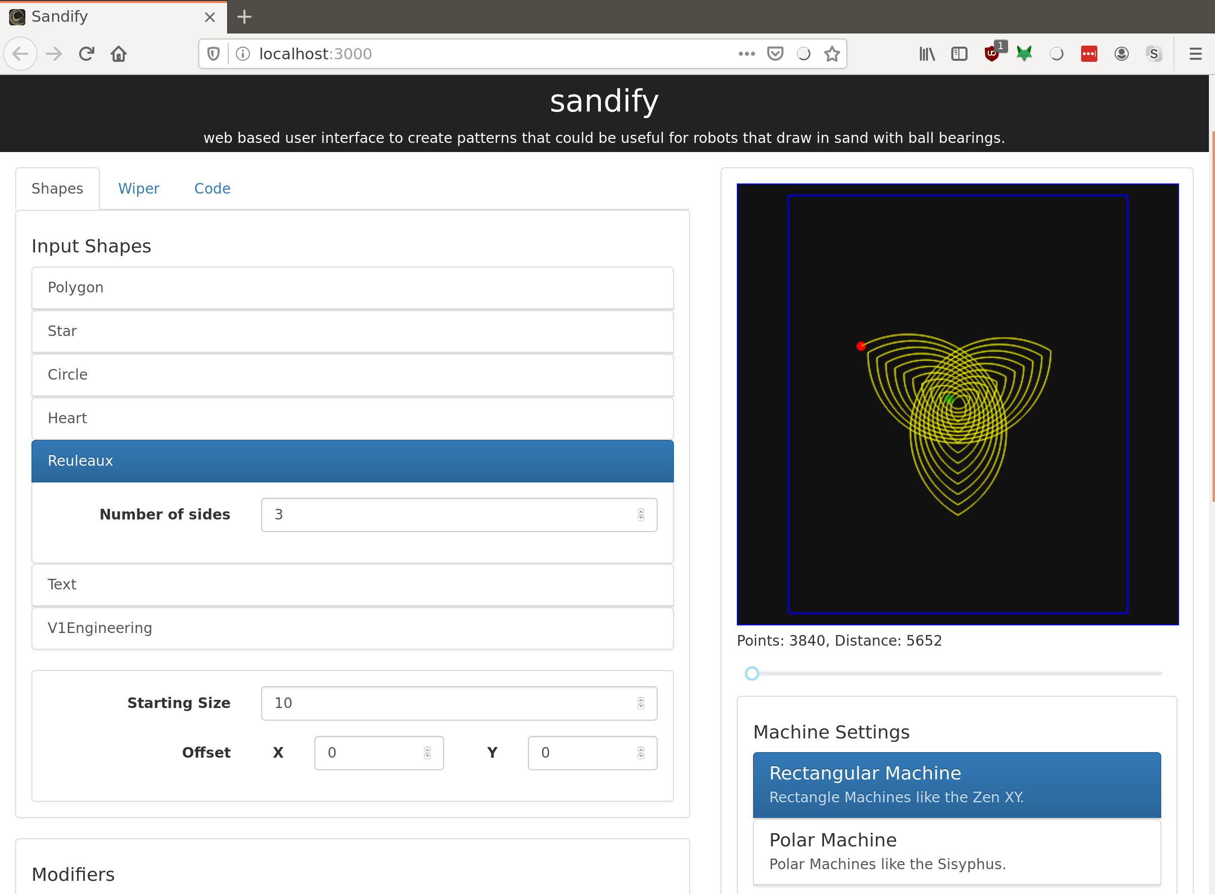

- I added a new shape tonight. Itâs like a circular triangle. Wikipedia says it is called a âReuleaux Triangleâ, so thatâs what I labelled it. Iâm open to suggestions on a better name
. I also figured out how to draw it with an arbitrary number of sides. Technically, the odd number of sides ones are âReuleaux Shapesâ and they have the interesting property of having a constant width from any direction.
I made this shape because it is the shape of the logo from my alma mater, The Colorado School of Mines, or Mines.
(New forum feature. Click on this little arrow to see more about the Triquetra fail)
I _almost_ got the triquetra to work, but I could only get it right for 3 sides.
If anyone is interested, maybe we can work it out together. I think the problem is that either the scaling or the arc length for 5 sides, 7 sides, etc. is wrong. I thought the arc length should be 2pi/(sides-1), but it is just slightly off. I didnât deploy this shape, because I need to also add a checkmark to switch between the reuleaux and the triquetra. Also, these names are terrible.
