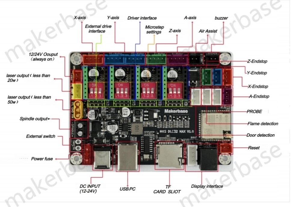

The machine uses a MKS-DLC32 as its board:
There apparently is a fire detector interface on that board and also a 12C interface, which maybe could be used?

The fire sensor will ONLY work with one particular revision of the LASER firmware. V2.0.8_H35_20220105_N.bin if I remember correctly.
There are no spare input pins left to use on the DLC32 to configure as a door safety switch and as the only firmware available for this board is the official pre-compiled MKS bin file you cannot edit the GRBL config to enable the feed hold function. I can’t see a way to do what you want apart from losing your program by cutting the power if the door is opened…sorry.

So it should be possible to comment out the references to probe pin in the /src/Machines/i2s_out_xyz_mks_dlc32.h machine file ( Add a /* before and a */ after the following lines)
#ifdef USE_BOARD_V2_0
#define PROBE_PIN                   GPIO_NUM_22
#else
#endif
and add a -
#define CONTROL_FEED_HOLD_PIN          GPIO_NUM_22
to the same file file and Robert should be your Mothers brother. connect the door switch between the probe pin and ground at the probe connector. Of course, you will lose your probe functionality doing this…
This board actually has both CNC and laser firmware with differing functionality for the two, for example, the probe connector that is used for CNC is re-purposed to a fire detector for the laser firmware. There are also two different sets of icons and macros for the touch screens on these boards.
Only having three stepper drivers is only a problem if you want to implement auto squaring, otherwise you can drive two motors from the one driver quite easily. It does have a very limited spare pin capacity ( basically a single output pin that is designated for mist or flood cooling) as the OP has found out.
So… I have made the suggested changes and re-compiled the firmware and flashed a spare esp32 dev module. Now, grounding IO22 causes a hold in LaserGRBL that requires the grounding being removed and the resume button be pressed…so yeh :slight_smile:

Well… never say never! There are no physical spare pins left unused on the ESP32 so the only option would be to re-purpose an existing used pin, (you cannot use a I2S pin for an input, nor can you use either I2C’s SCL or SDA as an input) perhaps the easiest pin to use would be one of the limit switch pins, is there one of those you wouldn’t mind losing? As you intend having the probe working perhaps the Z limit pin would be a possibility… just need to be careful not to drive the Z into the baseboard :slight_smile:
Comment out the #define Z_LIMIT_PIN GPIO_NUM_34 in the i2s_out_xyz_mks_dlc32.h file and add the #define CONTROL_FEED_HOLD_PIN GPIO_NUM_34.

I have only made a couple of changes to the stock firmware as supplied and I have successfully uploaded the modified firmware onto my dlc32. Try compiling the stock firmware from here and flash your dlc32 using the v1.0.6 tool from here

I have built a custom cnc mill and was wanting to do a similar thing here but have a mks dlc32 Max. This has a built in door switch input on the board which I hope will work as a feed hold and shut off the spindle. I would like to add a resume input also. Can the fire detection input be used for this task? I was hoping to use grblHAL as I intend to add a 4th axis for simultaneous machining. Any help or pointers would be amazing.
