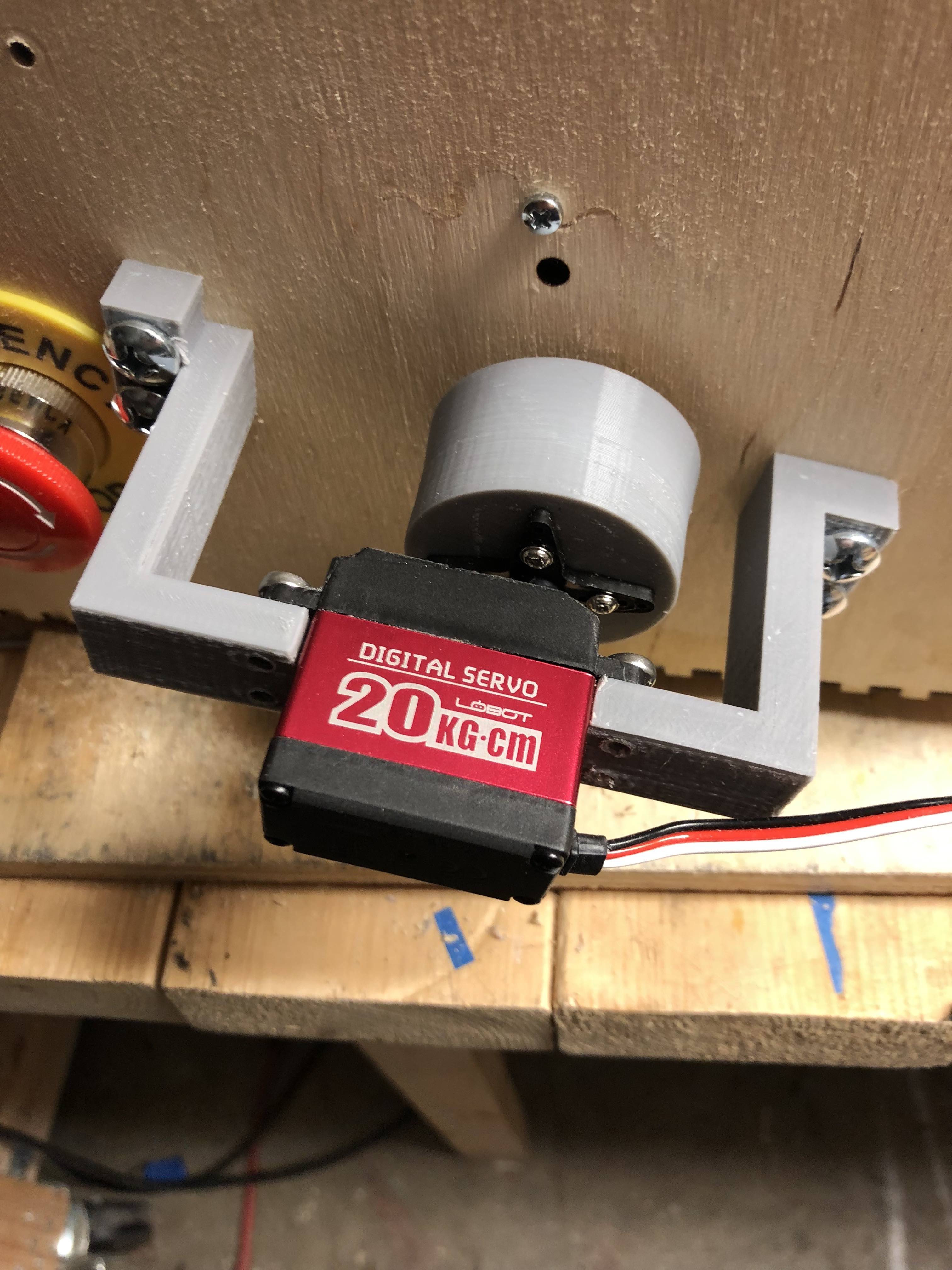

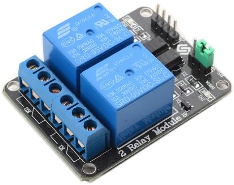

              It’s kind of hackish but I am using a servo to adjust the dimmer switch with writeMicroseconds, using a servo from amazon made by lewansoul, it has about 270 degrees of rotation similar to the dimmer switch, I have a range of 550-2350 microseconds movement, which gives pretty good resolution of speed.  It enables some “digital” control of speed, for reproducibility and allows me to adjust from the control panel without stooping over to twist the dimmer where I plan to have most of my stuff on the lower level of table.  I have been using Armin’s remote joystick firmware and editing it to have extra features.  I put in a 5V relay in my system that allows me to have emergency stop  button on the controller.  I put in a safety switch so I can toggle whether some buttons and the joystick send commands or not to prevent inadvertent moves.
