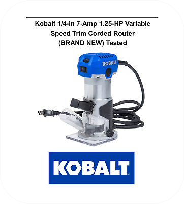

The Makita 700 series is a good choice, and since the nice Kobalt competitor to it did not get picked up by Kobalt as permanent part of their line up, the Makita is looking good. I think there are “clones” of it that are perhaps more affordable. Harbor Freight might be somewhere to look for such.
Speaking of the nice Kobalt router, here’s a link to a new one on eBay for only $79.
Since the Makita sells (new) for about $140 to $150, the Kobalt link is worth considering.
Update: the link above lists shipping charge of $15, but the link below has a better price, free shipping, and is also new:
Another update: This listing is priced lower still, and also new, and also free shipping.
Per your recommendation, I ordered the kobalt. Thanks :+1: Another NOOB question… Will the controller, SKR PRO, control the router speed or do I need a separate speed controller??
Router speed is manually set on the router itself and can’t be controlled externally. To do that, you would need a spindle instead. But, in reality, it’s not a big deal. My Kobalt spends 90+% of it’s time at a dial setting of 1. Sometimes I might change the speed when doing a tool change but you’re hands on with the router then anyway.
