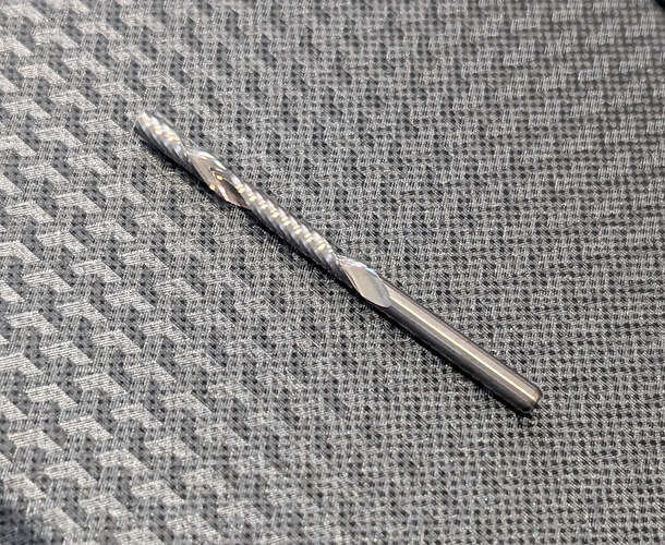

I mostly use 1/8 inch single flute upcut endmills from the V1 store. That’s ideal for through cuts. Sometimes I’ll use a 1/4 inch of the same.

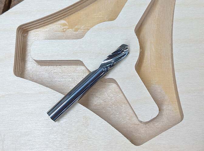

I would recommend either 1/8 inch or 1/4 inch single flute upcut endmills. Also, you want to run your router at a low RPM. I run my Kobalt at 2.5 on the dial. When I started I was running it at 5 and making sawdust. You want to see wood chips, not sawdust.

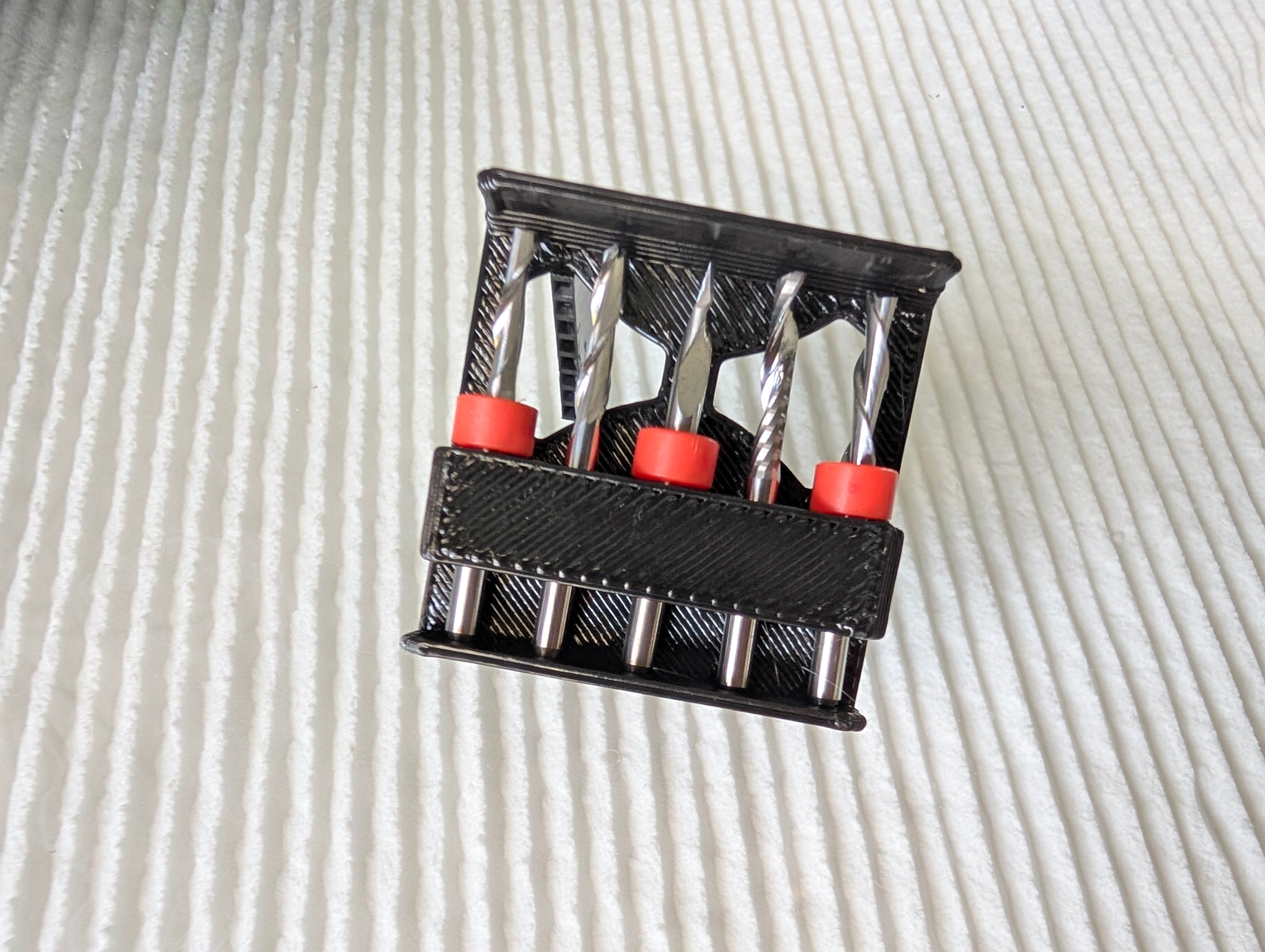

so i am not sure, but I STILL have the 5 cnc bits that Ryan sells (or sold) they are very handy and great to get started with!
this one, very hard to go wrong with this. it is a great starter pack and supports Ryan!

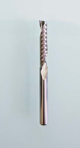

Get this one too. Unless it is above!
then this would be a GREAT workhorse!
