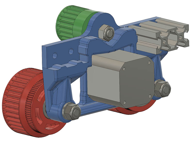

Meanwhile, I am revisiting the Wheel plate design. I used the pitch angle for the HTD5 belt for measuring the belt connections but seems like it is looser than it should be. This image has the top idler pulley at its upper most adjustment. It was sized for the belt to perfect length at middle spot (3mm adjustment on each side of center) Maybe these were measured by inside diameter.
I am thinking that if I can get the HTD5 belt tighter, the accuracy might improve. I moved the idler pulley hole up 3mm. I am printing the parts with PLA+ with 5 Perimeters & 40%infill. I was going to print the final versions with more infill, but didn’t get around to it. This should beef up the support around the top idler. A little over 4.5 hour print with 6 Perimeters, 70% infill & adaptive from .2 to .28 layer height.
