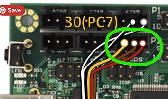

in doing to web searching on servos for rambo mini I ran across this bed leveling device that uses wiring similar to servos (or seeming to anyway). Scroll down to the mini-rambo wiring, second image.
it claims to use #define SERVO0_PIN 30 for the servo.
I’m assuming I can just use the wiring in the green circle
Thoughts?
That does not sound right.
Use 23, 24, 0r 25 for the pwm. Might be defined as PB5,6,or 7
