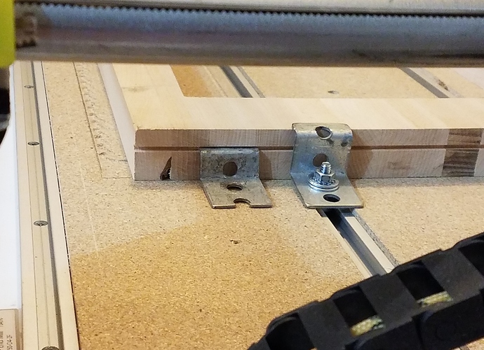

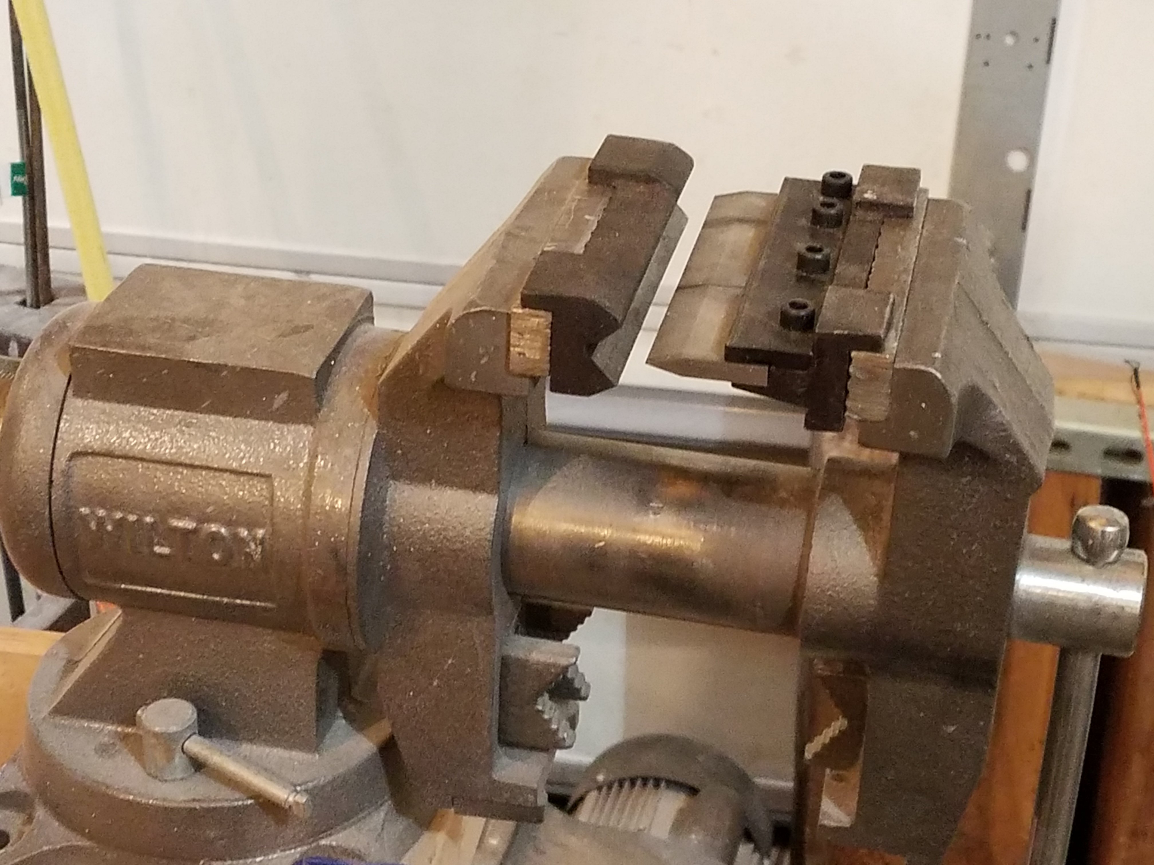

That’s a nice but the tracks are too far apart in my opinion. I use 3/4 MDF ripped to 5" widths with 5/8 t-track between each strip. Lower left spoil board really takes a beating on my machine so I just flip it or replace the one board when it’s time. I use punched flat bar for hold downs that I bend in a $50 vice brake.
