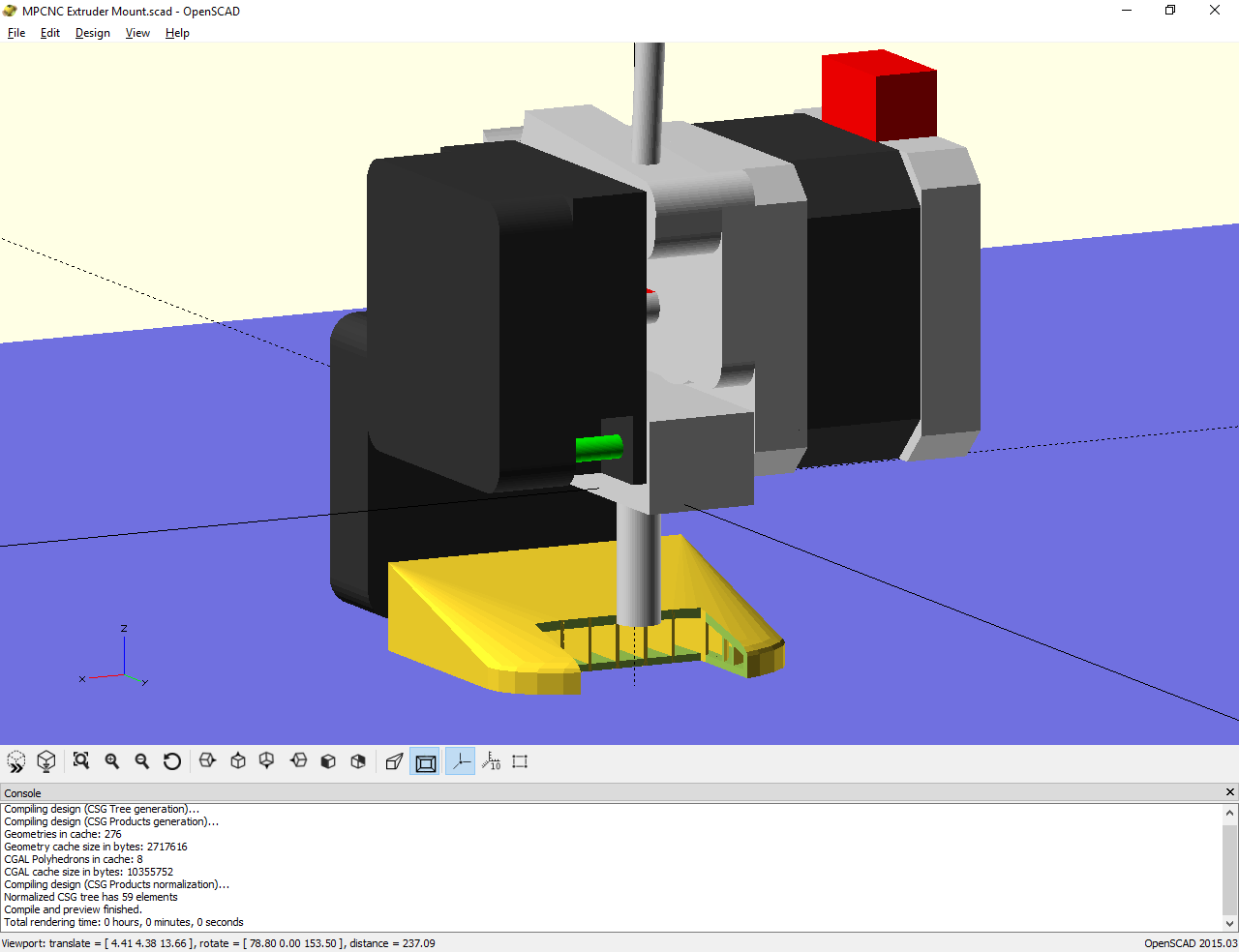

Just a design im kicking around. I made a blank tool mount file a couple weeks ago and decided to start start building on it. There is nothing wrong with the mk8 mount from allted, I just found it to be a little wide and bulky, especially when i started trying to come up with clever ideas to add my capacitive bed probe. I figured with id start by adding rigid support for the motor and extruder assembly, then it dawned on me that i could shrink the amount of filament needed and add a through body fan duct. Please feel free to try it out and give me your feedback.
The hotend doesn’t make goo out of the part that’s nearly touching it?
Why is the filament lever in the back?
I have been working on something similar over the past few days, but the bottom of mine kind of looks like a flying saucer still have a lot of finishing touches before I can actually print it… like deciding where I’m going to stick the spool of filament
A: no, i made a small indent ion for that, and if it was a problem I could just spin the heater block 90 degrees and gain like 10 mm of clearance. And the through body fan could actually be keeping the plastic cool. but so far no problems at all.
B:because that’s the way my extruder faces. they make them in both directions. i don’t actually use the lever I just feed and let it pull it in. this orientation let’s me see the entire hotend from the front of the machine.
FWIW, attached is what I have so far; I plan on wrapping the whole bottom with ABS, and using the “cutouts” in the heatsink as the anchor point for the extruder… still working on the duct work to get that rear fan to blow on the nozzle… now I see why car makers use clay… soooooooo many measurements
For some reason people seem to think that pla can’t handle being less than a foot away from the hotend. fwiw I’ve been using a blower fan since v1 with a pla duct that actually made contact with the hotend and aside from a tiny bit of warping where they touched it never caused an issue. your part looks great, but it still has the entire extruder dependent on 2 screws at the bottom holding it up. ive seen issues with second and third layers slightly warping and colliding causing vibration. I like your idea about using the fins to anchor your shroud to, I was using a shim plate before to attach my bed probe and found that the heat sink isn’t very “secure” when it comes to angular torque. see the fans mounting holes are 32mm on center and the nemas mounting holes are actually 31mm on center, which means that there is a lot of slip on that 2 1/2 Inch screw. i would have problems where my probe would be dead on for one print them drive into the bed on the next because the weight of the probe was being tossed around on fast moves. my part has solved all these issues and given me a good part that can be removed and replaced with ease, without worry that my probe will have to be recalibrated. And I don’t have to takeoff or lift up the fan to get at the mounting plate. plus I’ve gained about 10mm on my X axis and 6 or 7 on my Y

If you can print the cnc universal mounting plate then you should be able to print this it’s kinda tall but I kept the size down to a minimum. if it is too wide and you don’t have a capacitive sensor, you could always cut it off in tinkercad.

im working on how i need to direct the wires up the side, so i havent gotten that clip designed yet, although i dont think itll be neceessary since the motor wires dont really have that far to go before they hit the top of the mount. On your list of things there are some things to note. it could be a difference in throat height from different distributors, i too had my throat as high as possible to alleviate filament grinding, and have since added some filament guides to the extruder for that and that has pushed my nozzle down, but the pictures are of the extruder with the troat as high as i could get it. if you use a reverse filament lever then the hotend will not line up with the air duct. I personally dont use the lever unless im forced to manually drag the filament out of the extruder, instead i just have the extruder do the feeding itself. i did make the mount holes slightly too perfect in size and some of my screw heads try to bind up there, but its really not a huge issue, I am going to add another .1 to the hole size there. I have also made the extruder motor mount wall slightly thinner, because i had to get longer screws to hook up my extruder fan and heatsink reliably, and then i had to cut the screws down because the next size up is too long, which ultimately led to me striping out one of the steppers threads ;( I may even produce a few other versions with inductive probe mounts and even one with no probe, but I am still learning onshape and i find that once something looks nice and works its hard to convince myself to make any changes to it. i was thinking of getting an e3d hotend and i may also make a version to accomodate that.
I have had great success with the original design, and as ive said before, one should always start with low fan speeds, because for some reason this thing works incredibly well at pumping out cold air, i cant even get over 50% speed out of the fans im using without it actually peeling layers off. So i have been toying with the notion of adding some circular geometry to the duct out nozzle to spread the air out more evenly. but that may take a few more onshape classes.
