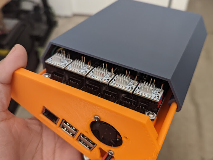

if you have a dremel you could trim them a bit or sand your top case so your drivers can fit nicely.
Or wait for them to heat up enough to melt into the top, providing another positive locking mechanism… :wink:
Case looks great! Was looking for something similar for a SKR 1.2 and RPi4. Love seeing creative thinking!
Lets see how these perform. I’m not sure what I’m going to do with the other 95 from the variety pack. Maybe I can double stack them. :smiley:
Now I don’t remember wherw I saw it, but someone uses those little heatsinks as stand-offs for using a laser in order to be able to cut through material.
Dki4linux did. In one of the neje threads.
Awww… How cute! Widdle, itty-bitty heat sinks… :baby:
Looks like you even have room to run a copper heat pipe across all of them and out of the case. :japanese_goblin:

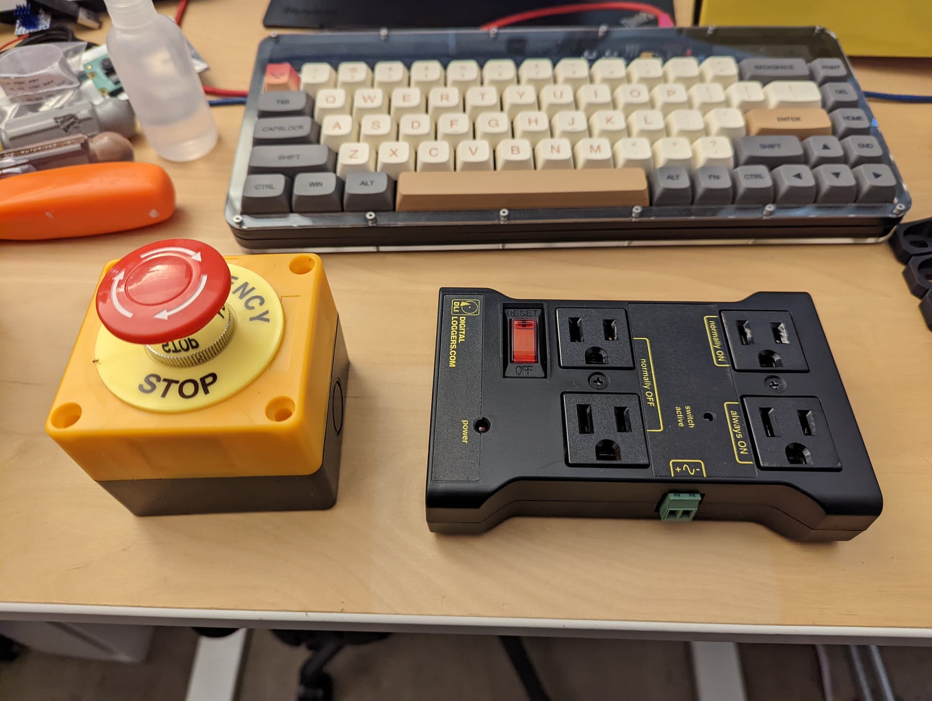

More goodies! The plan is to use the always on socket to power the Pi/SKR, the 2 switched sockets for the router and the vacuum and place the emergency cutoff on the main AC line. The switched outlets will be controlled by an extra I/O pin from the SKR.

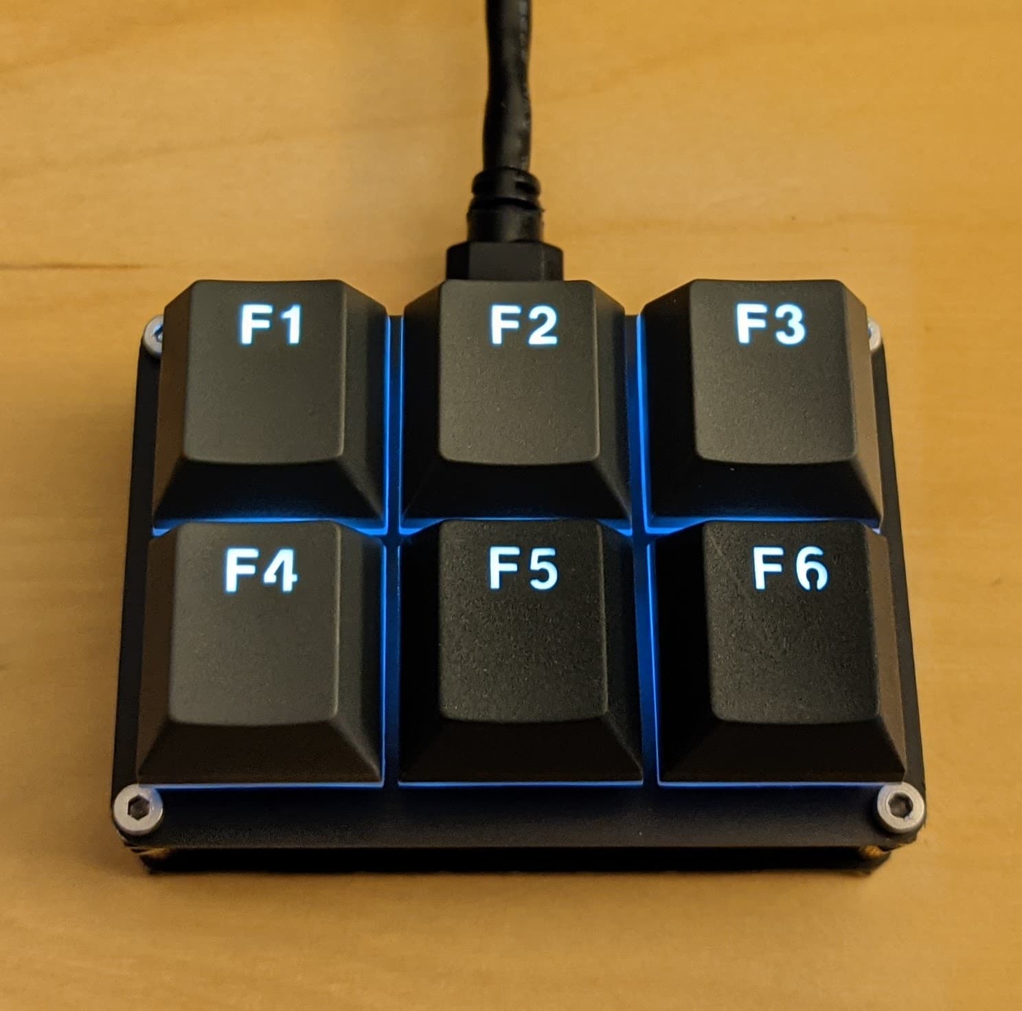

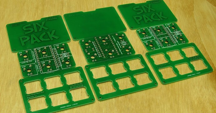

Since klipper (klippy actually) can address "MCU"s over USB, I’m thinking of loading klipper FW on this little Arduino based macro board to use as a jog controller. Just need to replace the key caps with arrows, and decide what to use the other 2 buttons for.
If you are wondering, it’s a nice little open source PCB from:
Nice! They didn’t used to have an always on. Only two normally on and two normally closed.

My thought of using a small opensource keyboard as a jog controller with klipper hit an immediate speedbump. The beauty of klipper is, the firmware itself is relatively small and installs on a ton of microcontrollers. It’s so small because it’s only job is to turn the microcontroller and all if it’s attached devices into simple drone that does what the control process (klippy) tells it to. Kliippy, running on a python compatible computer (Pi or PC), talks to 1 or more of these “MCUs” over a serial/UART connection making it interestingly expandable by just flashing klipper firmware to the device, defining the new MCU in your printer.cfg (text file), and restarting the klipper processes on the computer. The only time you have to “update” the firmware on the device is when there is a major change to the “drone” code which is rare. Sorry, this turned into a klipper fanboy post. :wink:

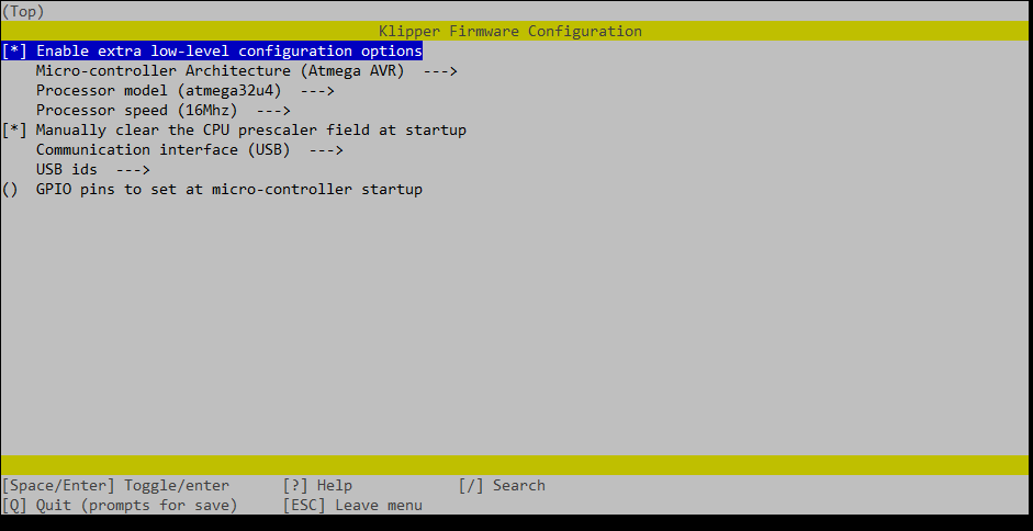

Back on topic. My little six pack keyboard uses an Arduino Pro Micro running QMK firmware when attached to my computer as a macro-board. Converting this to klipper should have been as easy as compiling the firmware using klipper’s make menuconfig command, selecting the options below, then running make to compile the new .hex file.
I then flash the new firmware by hitting the reset button on the PCB and use the avrdude utility to do the deed. This is what should have happened. It should have been quick and easy… it was not. It’s ok though, every challenge is an opportunity to learn something new and in this, I leaned a bunch about bootloaders.
The Pro Micro uses an Atmel atmega32u4 AVR. These boards usually ship pre-flashed with a boot loader called “caterina”. The purpose of the bootloader in this case is to allow you to reprogram the chip without needing additional hardware like an in-circuit serial programmer (ICSP). When you bridge the ground and reset pins, the MCU will “boot” into this bootloader instead of the program you had previously loaded. When the MCU powers up normally, the bootloader does nothing but load the flashed program.
The atmega32u4 only has 32k of flash space. The carerina bootloader consumes 4k of that space leaving 28k in useable program space for klipper. Why is any of this important? A little while ago, klipper grew just past that 28k mark. This means that uploads fails and my face looks like this :frowning_face:.
