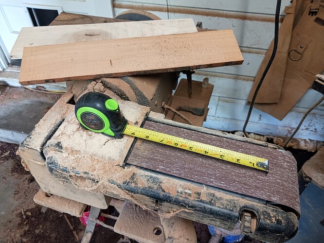

Here’s my modest bandsaw-milling station… a 14" Porter Cable bandsaw and a Porter Cable 4" x 36" belt sander.
The sander is a PC benchtop belt and disc combo. I rarely use the disc…
I use 1/2" bandsaw blades exclusively for milling limbs and small logs. They have 3 - 4 teeth per inch and the saw has a ~6" depth of cut max…
The sander has about 8-1/2" of flat platen area… so I limit the plank length to 16" - 17". I can then work 1/2 a side at a time… smoothly stroking 4 - 6 times against the roller and then flat on the platen to remove saw marks. Flip end for end and side for side and repeat… taking care to keep the time/strokes for each area approximately the same.
