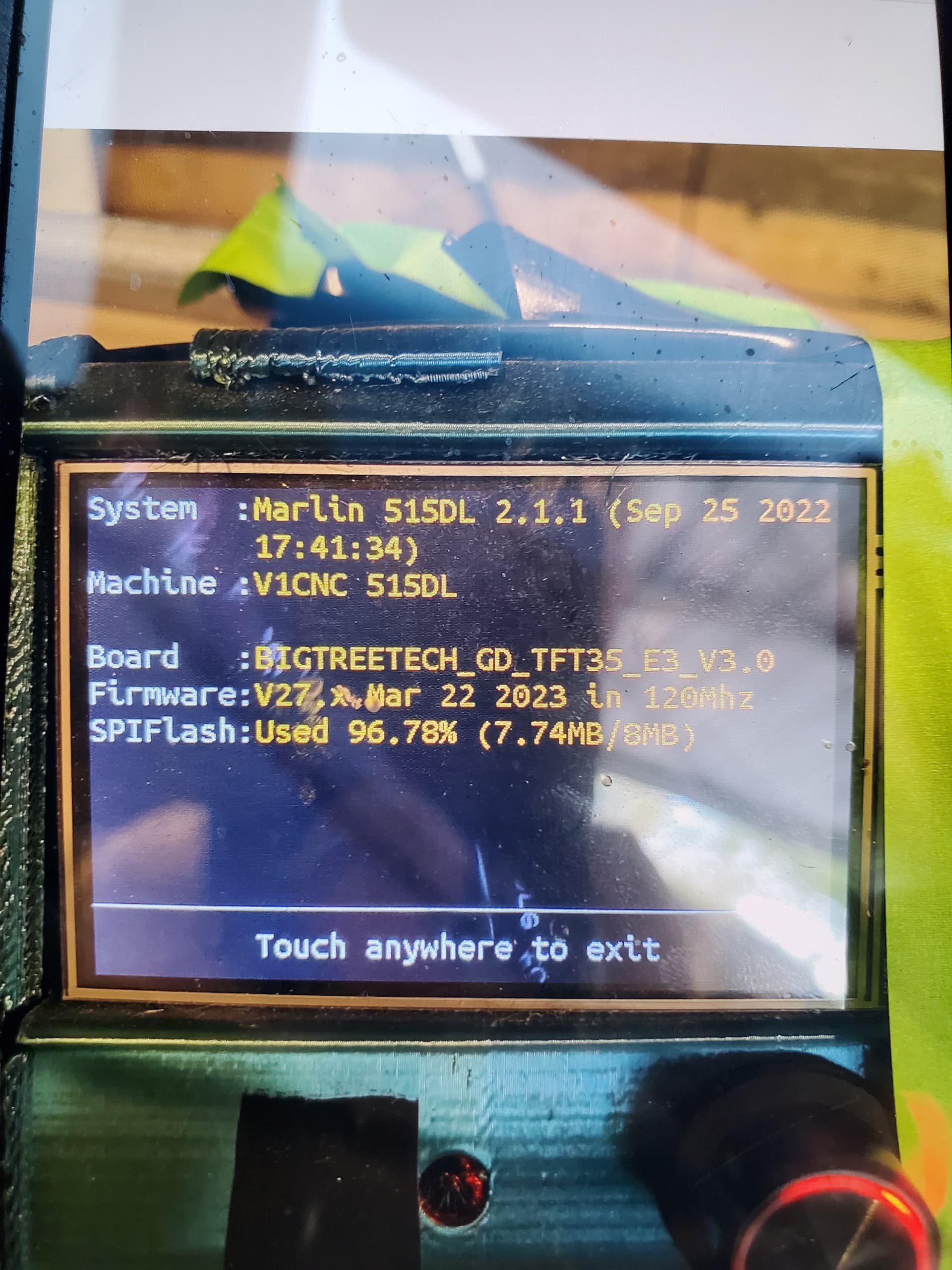

Hello, I recently bought the lowrider v3 with SKR PRO board from the v1 site.
Everything is assembled and functioning.
all my axis are moving in the correct direction , EXCEPT when i try to home x and y in repetier.
when i change the x home position or y home position, they still try to drive the opposite direction.
neither are inverted in repetier.
i havent tried to update the firmware, but they were moving correctly before i linked to repetier server.
any advice on what to check?
Some questions to start the troubleshooting process:
What version of the firmware is installed? Look for a version on the display when you boot the Lowrider, or reported in the Repetier log screen when you connect.
Are you using Repetier Host or Repetier Server? I’ve only ever wanted Host to manually control a connected machine, but Server gets installed by default and takes over connection ports if you’re not careful during the install.
Do you have end stop switches installed? (Without them homing doesn’t work, you just jog to the desired starting tool location and send a G92 X0 Y0 Z0 to set the machine position)
What does M119 say about the state of the switches when you send it from the GCode box on the Manual tab in Repetier Host? Does the console properly report “open” or “triggered” for each axis’s switch when you click them by hand and re-run M119?
Do the axes home in the proper direction if you call for homing from the display (assuming you’ve got one connected)?
How far do they move in the wrong direction? If the end stop switch is already triggered when the homing sequence starts, you may be seeing them backing off the switch for the second low-speed pass.
First off Tom, thanks in advanced, I appreciate your time.
Firmware
Currently using repetier server as repetier instructed to connect that way? I’ll switch it tonight when I attempt again
Yes I have end stops installed that came with lowrider v3 and they all activate and disarm as expected.
I could home every axis before I connected to repetier server. Now either way sends my x and y axis in reverse when I select home.
I can control them correctly with both control panels (repetier and LCD screen)
M119 reports all end stops are functioning.
I can trigger and see them and then release and see them accordingly
They will travels far as I let them go when I attempt to home. I’ve tried close up and from opposite side of the table
