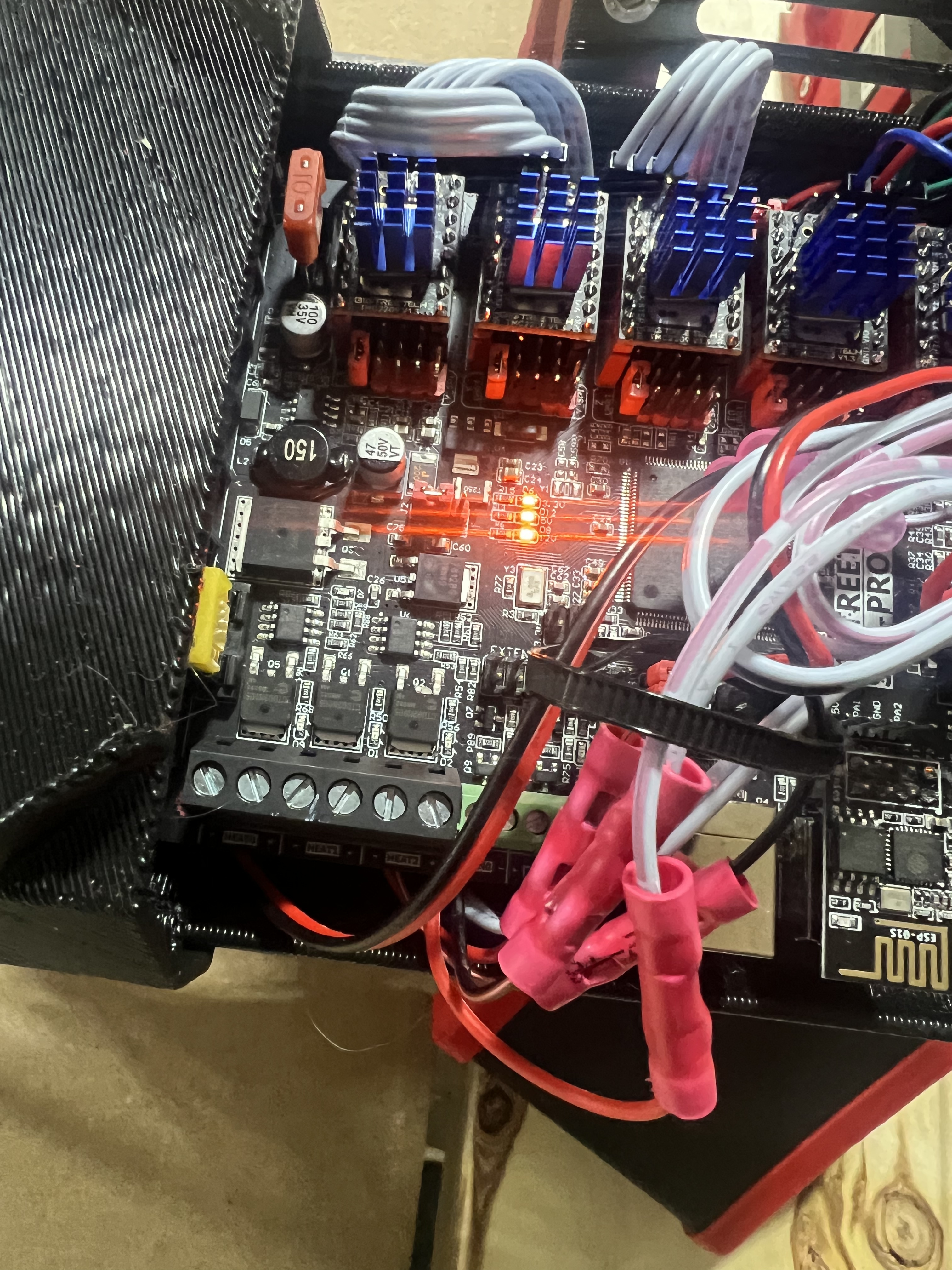

The SKR has a jumper to select how it is powered, either by the +5v from the USB connection or from the +12/24v main power feed.
Is the jumper in the USB power position and is the 3v3 LED lit?
mike, thanks for the quick response!
Per the image attached, the jumper is set on 12/24v and the three led’s are lit.
Linux is my preferred OS. There are no drivers needed for the skr pro. I would watch dmesg when you plug it in. You should see some new devices added including something like /dev/ttyACM0. If you don’t, then it is probably a bad USB cable, or something wrong with the skr pro.
