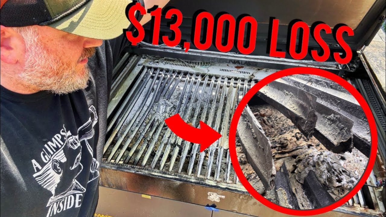

Remember kids, don't leave your machines running unattended
This was definitely a good reminder for all. I will sheepishly admit I haven’t used my mpcnc for a while. I never leave the shop when it is on, but I am in the room.
This system appears to be fairly air tight. I am guessing the operator didn’t smell anything and only noticed a flicker out of the corner of his eye. When I am cutting or sanding, I wear PPE, 3M half face mask p100 filters. I don’t smell smoke through them.
I having been in small lab fires, I think they did a decent job. I wouldn’t want to be exposed to the smoke.
I wonder what was needed to bring the unit back to life.
Nice thinking, but I hope my mpcnc doesn’t catch fire often enough to have an effect on the 100year carbon footprint (and I don’t believe co2 has an effect on the ozone layer)… or at least less of one then all the trees they had to cut down to make the wood I’m turning into chips XD.
Still think co2 would be my go too. I can buy 10lb bottle of co2 for $45 (at my local grocery store no less)… beats the hell out of the $400 they are asking for some of those alternatives. And it should not require any clean up either.
Problem there is they always make smoke it would be hard to sense what is good and when its gone bad
@timonjkl Yeah you would need a good sensor that can measure actual parts per million of a substance. Or one that detects heat intensity.
I know we used co sensors in our direct fired hvac equipment, but I’m not sure how much co a wood fire produces.
string on a weight strung over the top of the machine.
string catches fire. string breaks. weight falls and lands on button triggering fire suppression system.
New application for conductive filament… just run strings across the top of the enclosure. The fire will melt the filament and break the circuit tripping the alarm&starting the fire suppression.
It’s in a solid enclosure, just turn it off. That’ll kill the ventilation and It’ll burn itself out. Same rule for an oven fire. Do NOT open the oven…
