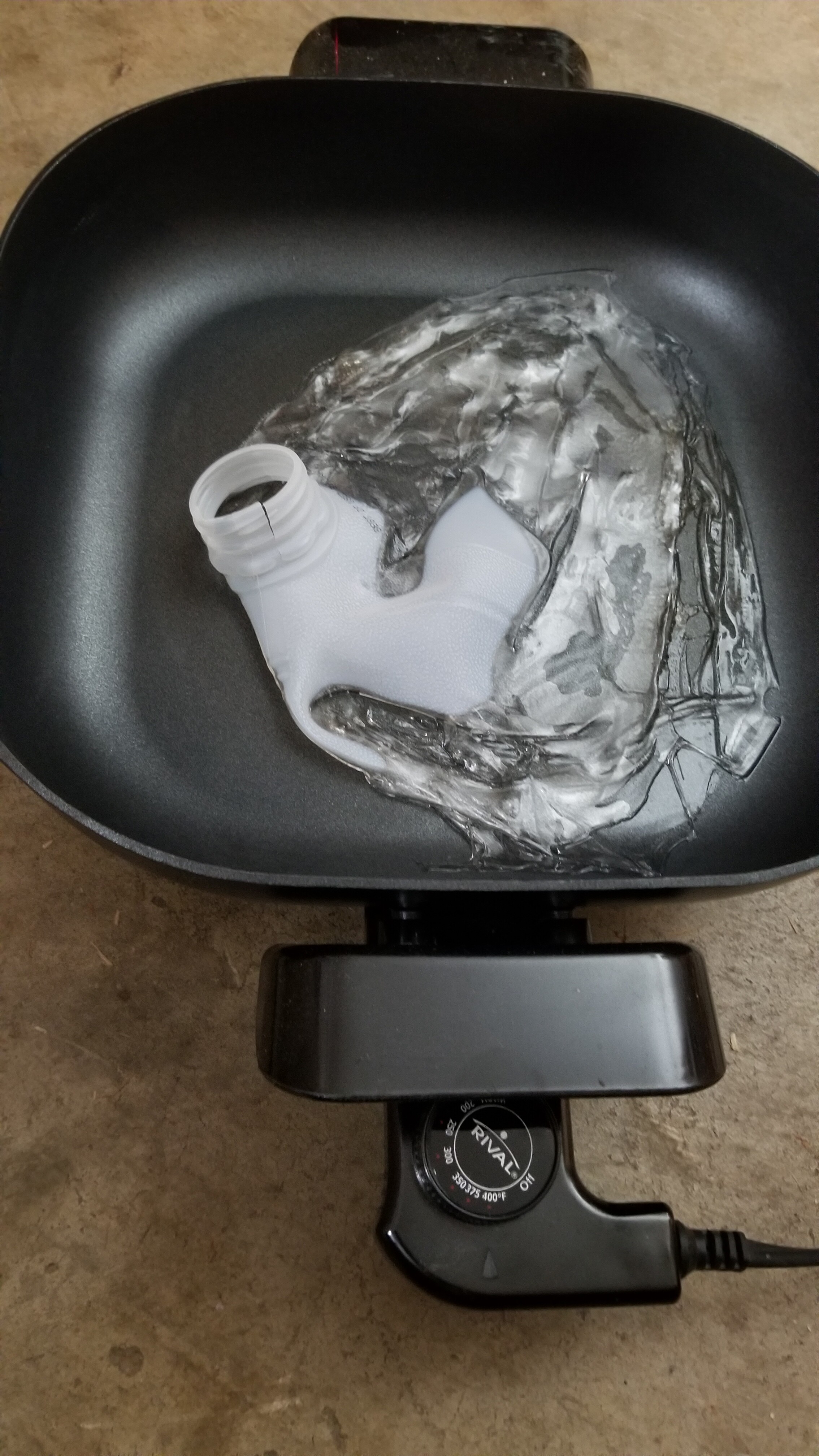

I realized I had an old electric skillet that I had already ruined for food purposes for a different project. After digging it out I discovered it goes to 400F (or that’s what the dial says).
Dropping a HDPE bottle in and pressing down gently, it melted pretty well, without large pressing forces.
It made a fair bit of smoke, but I think that was residual from before, since it smoked before I added the HDPE. I had set it at the max temperature because I figured I could always dial it back if it works.
