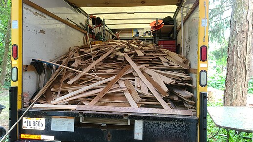

So a few months ago I picked up quite a bit of oak flooring (3" and 4" wide planks) that was pulled up out of a house near me. It was free and I figured I could at least use it for screwing around and upping my wood game. The 4" wide sections I am able to machine down to 3"x5/8"xlength planks after cutting the tongue/grooves off, planing the top stain and bottoms to flat.
I figured I could start with a few simple cutting boards and then my wife made me think about something. Since this is old flooring, there’s a possibility of any number of things that could have spilled, leaked, or come from domesticated animals, on to said flooring.
Thoughts?

Apart from a big dose of jealousy you mean? Wow, just wow! You have years of fun locked into that lot!

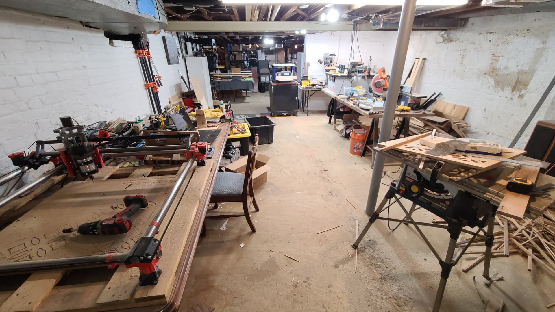

Yeah, it’ll probably mostly remain in my barn for longer than I’m around :sweat_smile: As far as age, it came from a house in a sub-division that can’t be more than 20 years old. I will maybe try that mother-in-law test you mentioned though, you know, just to be sure, in the interest of safety :rofl: The nails aren’t a problem because it was only held down by L-cleats on the tongue side. When I rip a 3/4" off that side, the cleats go with it. It is quite tedious though, rip one side, rip other side, chop off ends, take 1/16 off the top to strip the old finish off, then a little more than an 1/8 off the bottom. I batched about 30 pieces the other day and it took a while.
Those builds look great! I really need to build some benches. My “shop” is a hot mess right now.

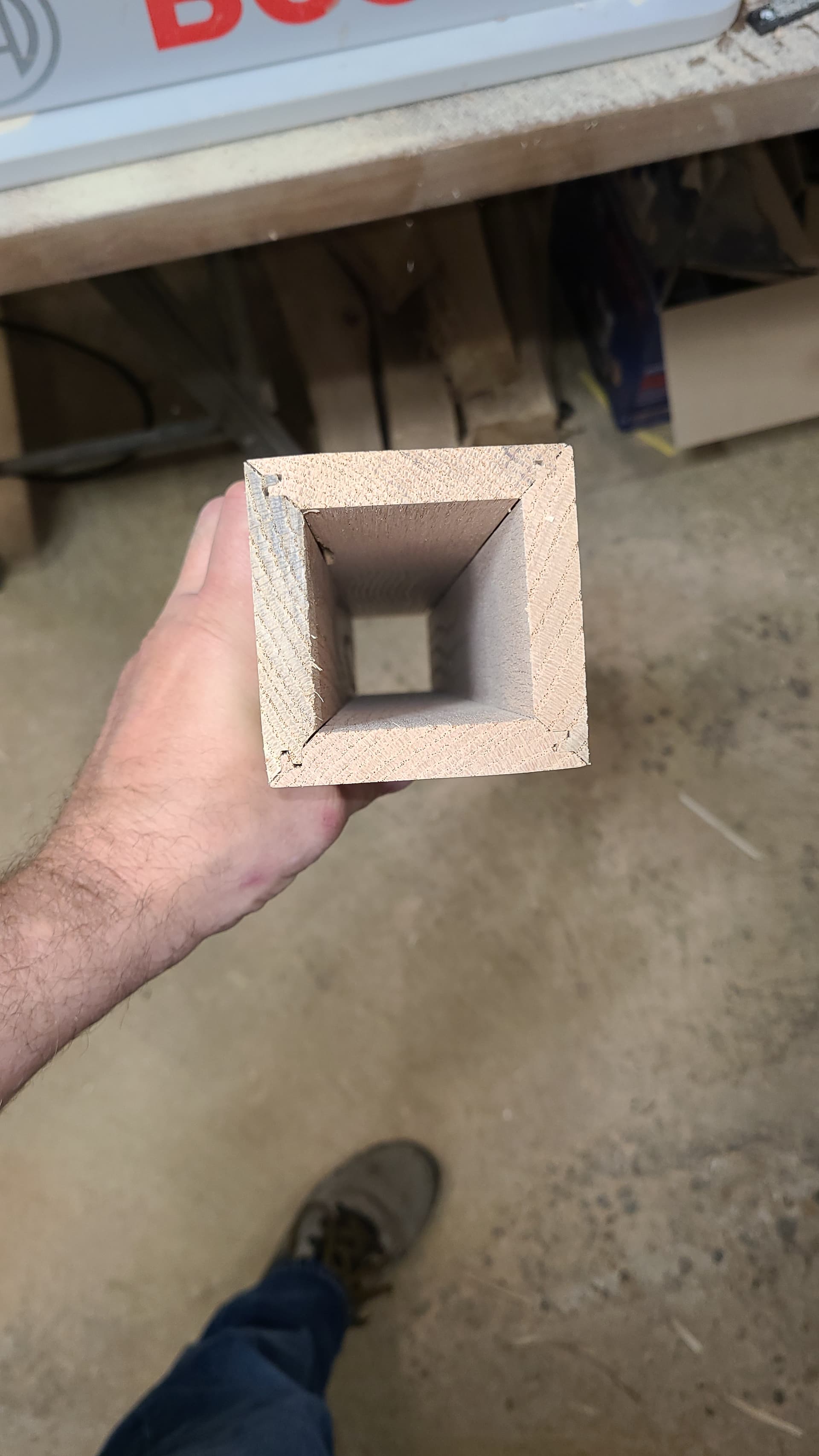

Here’s trying to figure out how to get a lock-miter bit dialed in.
What I wouldn’t give for that space! Have fun - it’s well worth the tedium getting it sorted now and having a lovely stack to draw from whenever you want for the rest of your life! (I stopped collecting timber fifteen years ago and it looks as though I’ve timed it pretty well - just a small truckload for my kids to get rid of… :rofl: :rofl: )

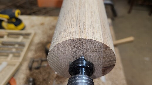

I then needed a center spindle, so, I figured I’m going to need a lathe. Did I mention how much I love my wife! :smiling_face_with_three_hearts:
Here’s the pieces I have so far…
The top is 20" diameter. The stain really brings out the tool marks! :rofl:
This is the first time I’ve touched a lathe since high school. I think I did OK. :sweat_smile:
