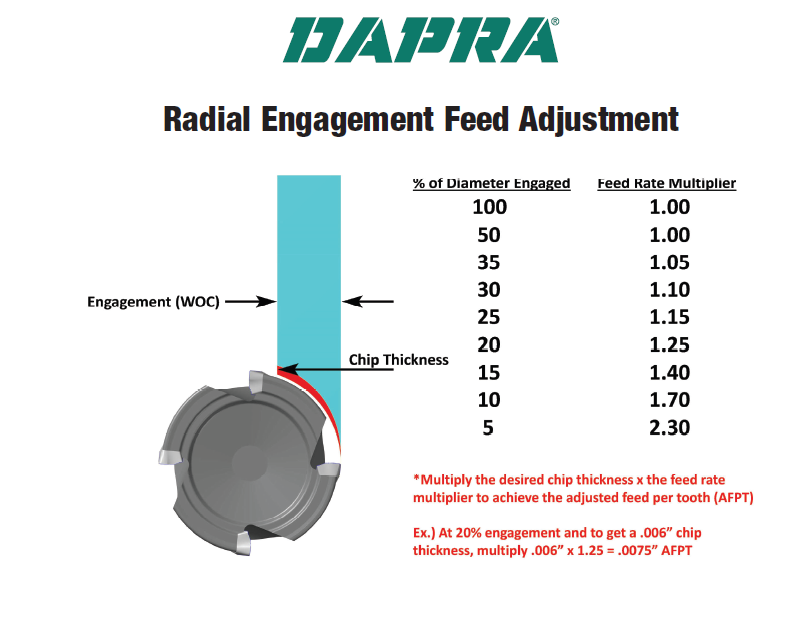

I found a website that has feed rate correction factors for chip thinning (which trochoidal effectively uses).

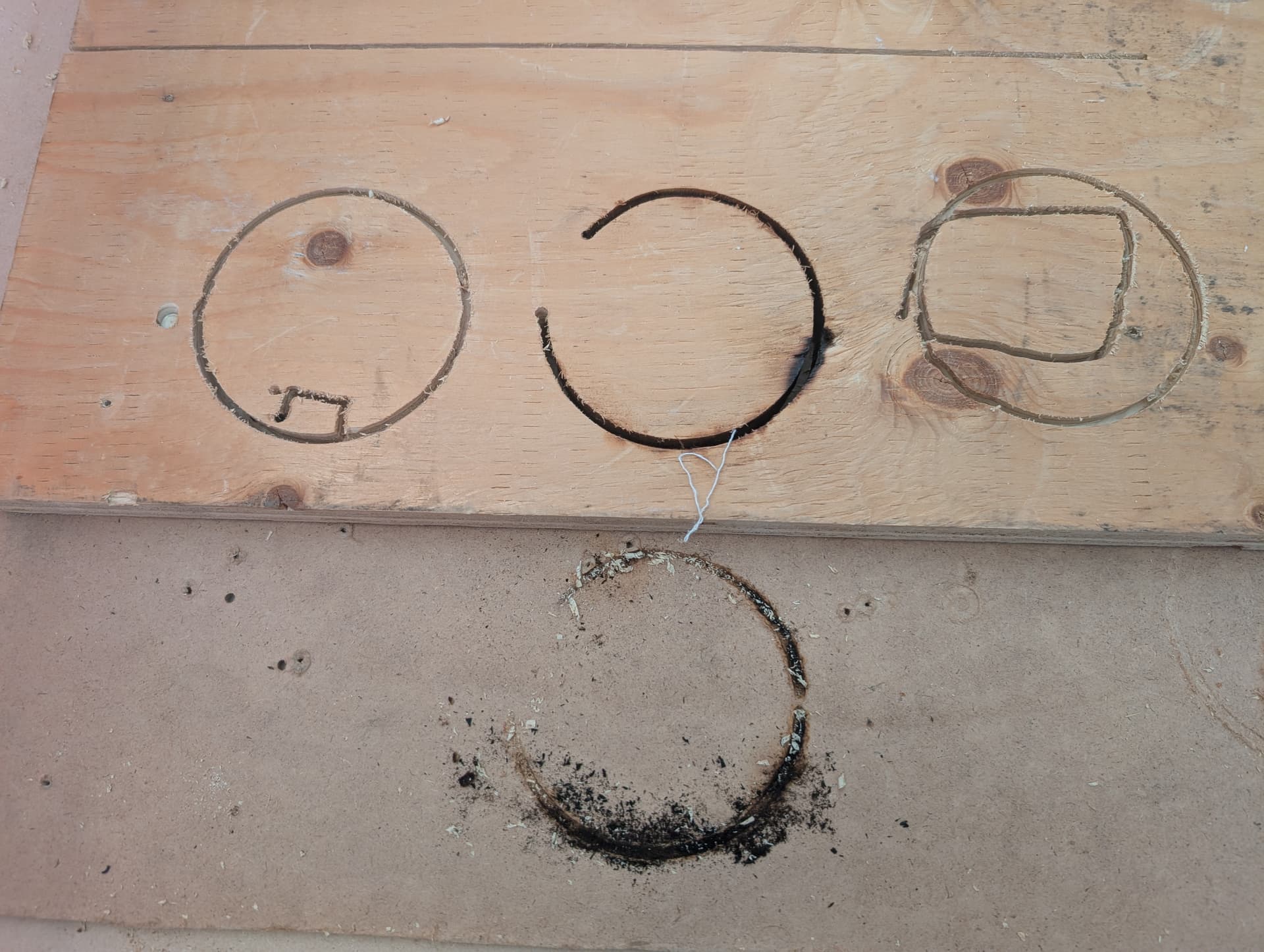

Before I discovered this correction factor, I tried a full depth Trochoidal cut using 35% Trochoidal Stepover, 25% Trochoida Width, and a feedrate based on maintaining the recommended (standard) chipload. (center hole)
As you can see, the bit was rubbing, and the heat started to burn the wood and the spoil board underneath it. The slot was also too narrow for the chips (sawdust) to evacuate, which just added fuel to the fire.
The two outer cuts were using a standard milling at 6.5mm (just over 2x Dia. DOC), and in both cuts the newly replaced bit started skipping steps during the second pass.
I ended up giving up on using the 1/8" single flute bit, and going to a 1/4 2 Flute bit. The feedrate calculation said that I needed to go over 5000 mm/min, and run the router at minimum speed (10000 RPM), but I tried it at 3000 mm/min and 10000 RPM. Because the plywood was so knot-filled and the glue was so hard to cut, it actually stalled the router on the first test cut. I jacked up the router speed to about 22000 RPM, and it cut perfectly, creating reasonable sized chips (even though the chip load was supposedly about 1/3 of recommended).
Better yet, the stiffer bit didn’t deflect at all, cutting the holes to within 0.010 mm of the specified dimension with the bit size specified as 6.35mm in EstlCAM. With the 1/8" bit, the best I could get was within 0.050 mm, and only after reducing the specified tool diameter from 3.175 to 3.00 and using a finishing pass.
