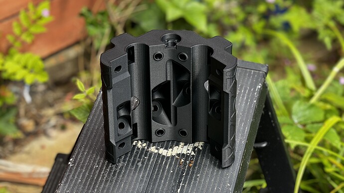

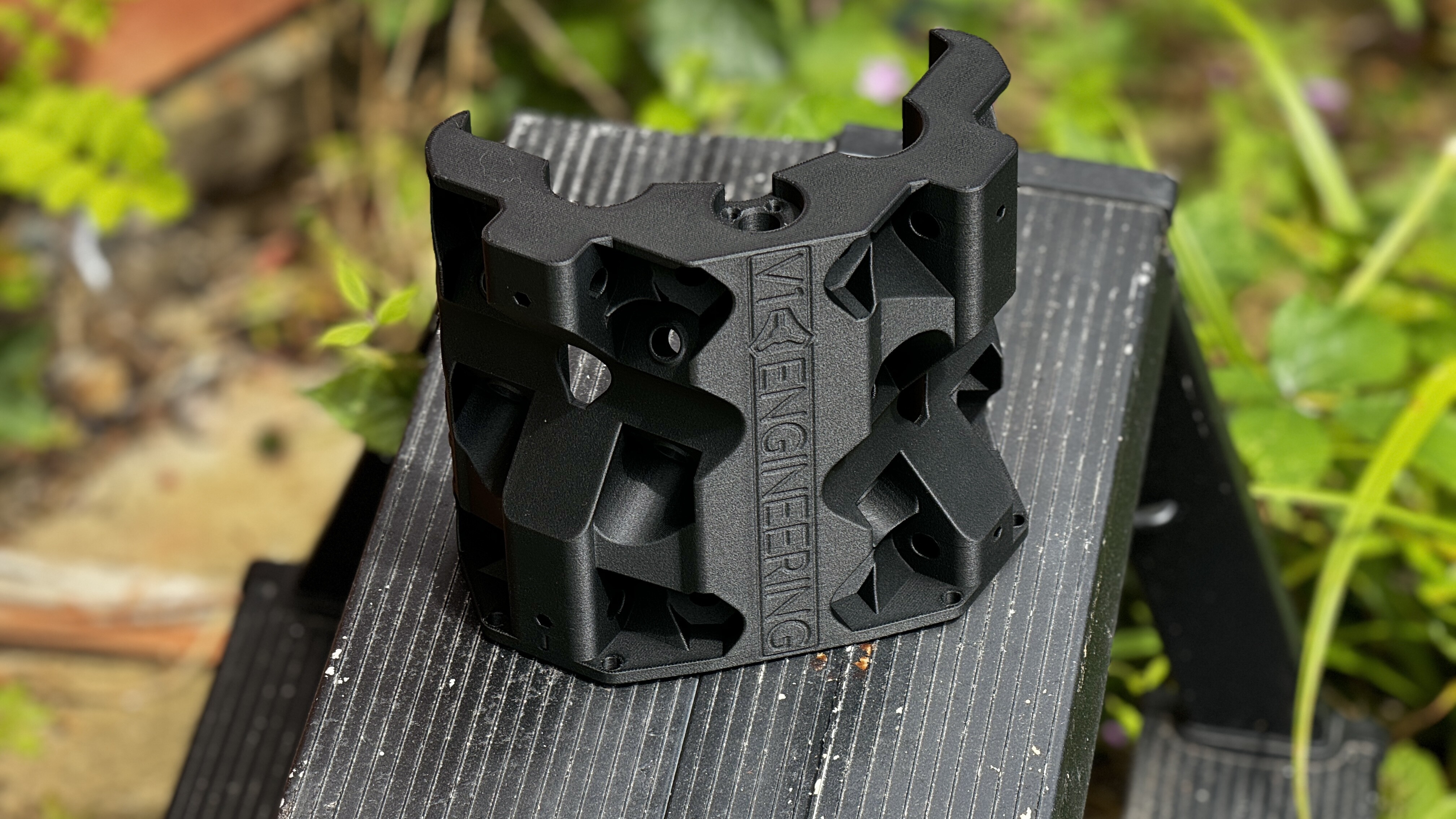

Core was a success! It took about 15hrs. Weighs about 500g.
  • used 4 perimeters
  • 70% infill through whole thing
  • 5 top and bottom shells
That’s a good looking print. That’s in PLA-CF?
15 hours? that bambu lab mini did not print it, did it? What speed is 15 hours?
I just looked to re-print mine and was looking at 1day and some.
Yea that’s the PLA CF. It looks super nice
I’ll double check the gcode but pretty sure it was 15hrs ish. I was using Bambu lab strength profile (slows down outer wall speed) with 70% infill and 4 perimeters.

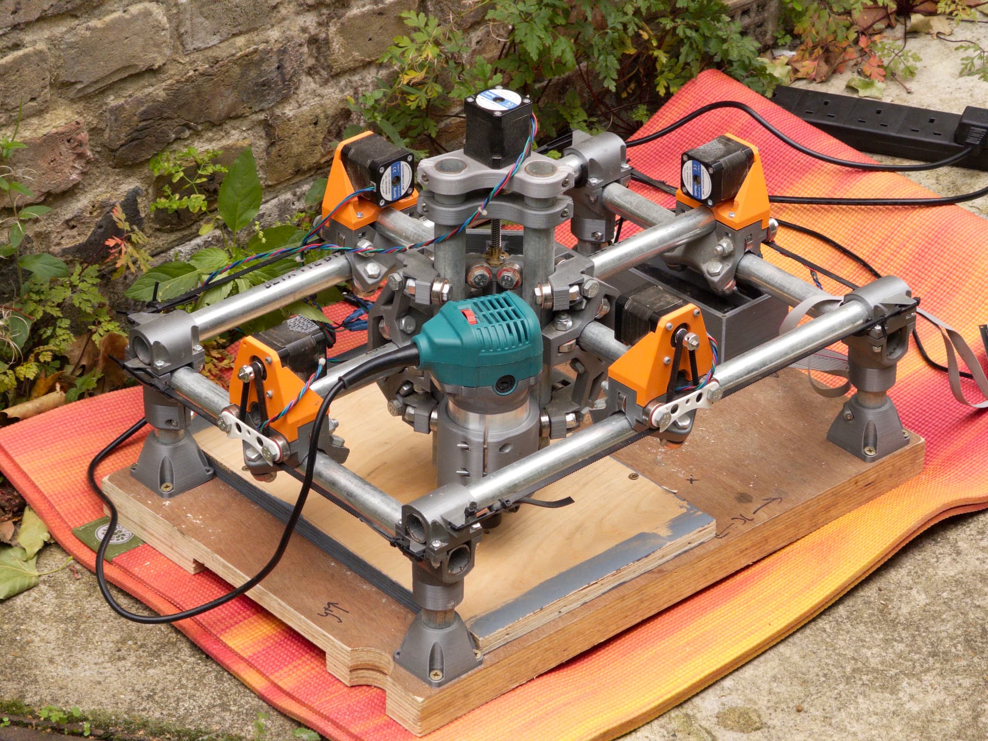

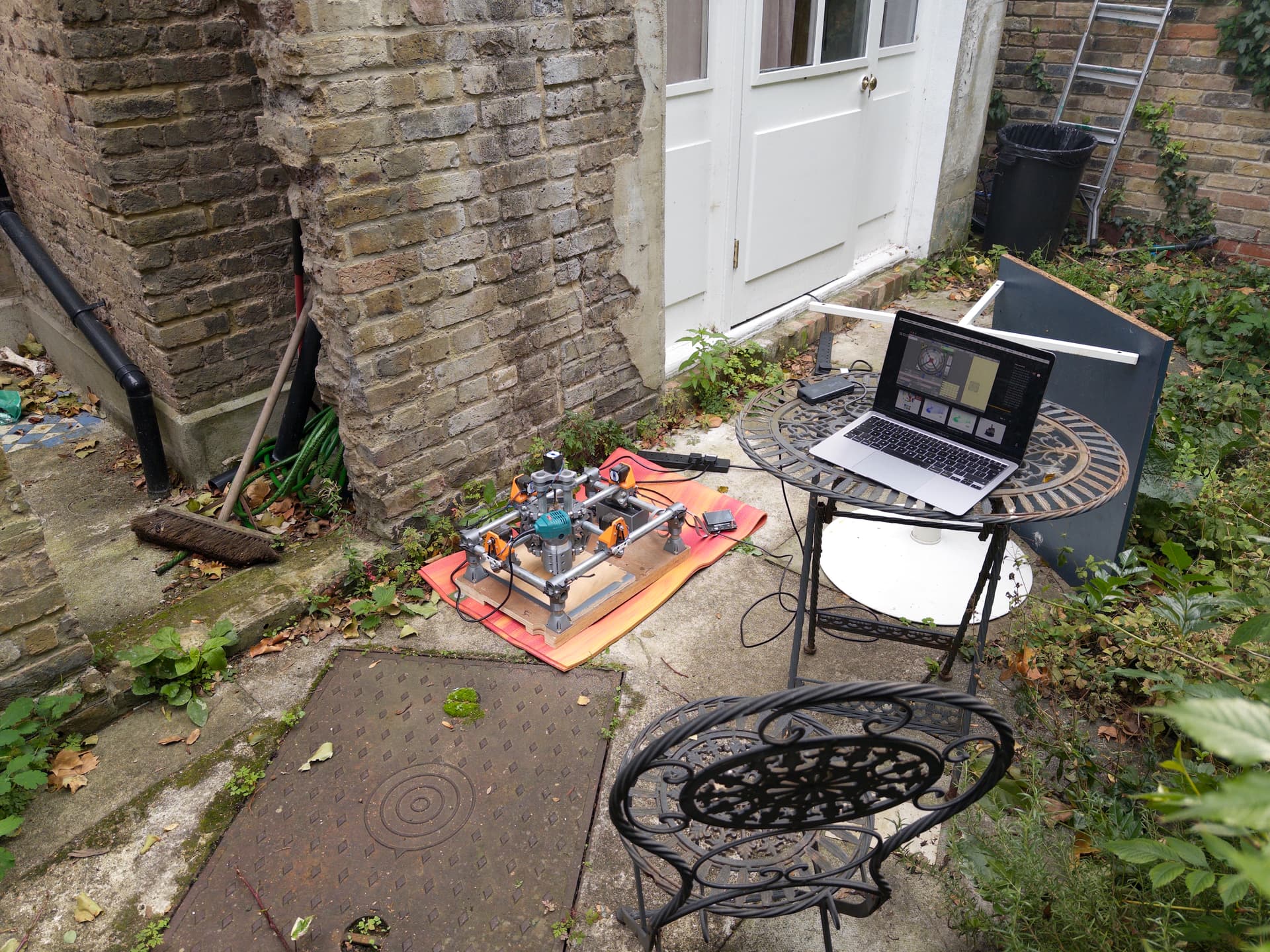

Chips flying for the first time in many years!
Have not gotten around to the rebuilt but am testing out the burly again before I do.

Hey Jim, I’m not in need of any assistance right now ( I think).
I’ve gotten back into MPCNC because I have a 3D printed product I think could benefit from a few beautiful plywood parts.
I’m using a 1/8in bit and fusion 360 as my CAM generator.
My first cuts were:
  • 3mm adaptive clearing, 0.925mm stepover, 900mm/min
  • 2mm DOC 2D contour at 900mm/min
My part was useable but a little off on dimensions, worse on Y axis. The belts don’t have super even tension but I’m not sure how to move forward on that. Maybe redo both tighter.
I’m now chasing a bit of speed so my next test running is:
  • 2D Adaptive Clearing at 4.25mm DOC, 900mm/min, 1mm stepover
  • 2D Contour at 3mm DOC, 900mm/min.
It’s looking like Speed Test 2 is running nicely. No bad sounds. Will report back.
Cuts are very clean. I’m having more luck this time around with the MPCNC.
I am getting some defection and the walls aren’t perfectly straight. Hopefully moving to Primo can help with that.
My dimensions are off by 0.5-0.9mm. So quite good but for my use case of using with 3D printed parts I’ll need to chase a bit more accuracy.
