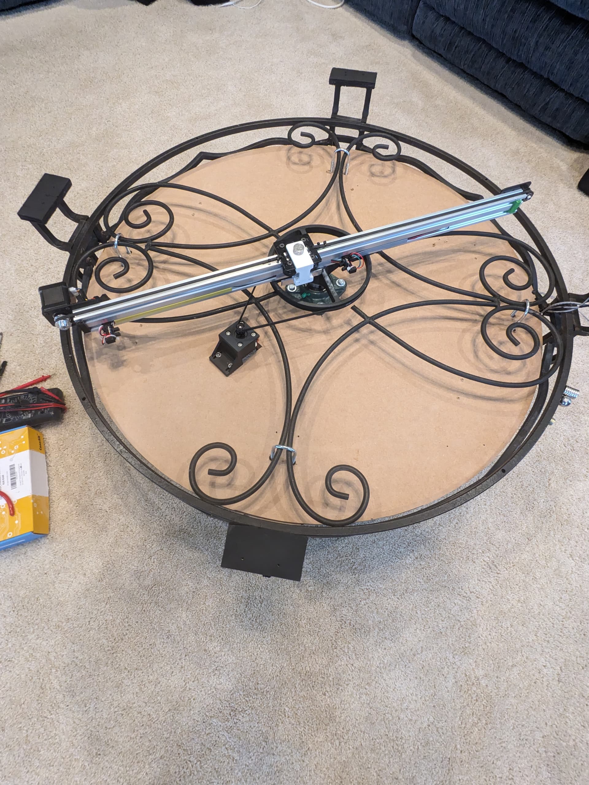

Alright, that is the arm and the rotor assembly. I have all the electronics underneath.

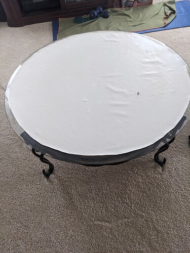

The surface for the sand is a piece of glass that I got off the marketplace.

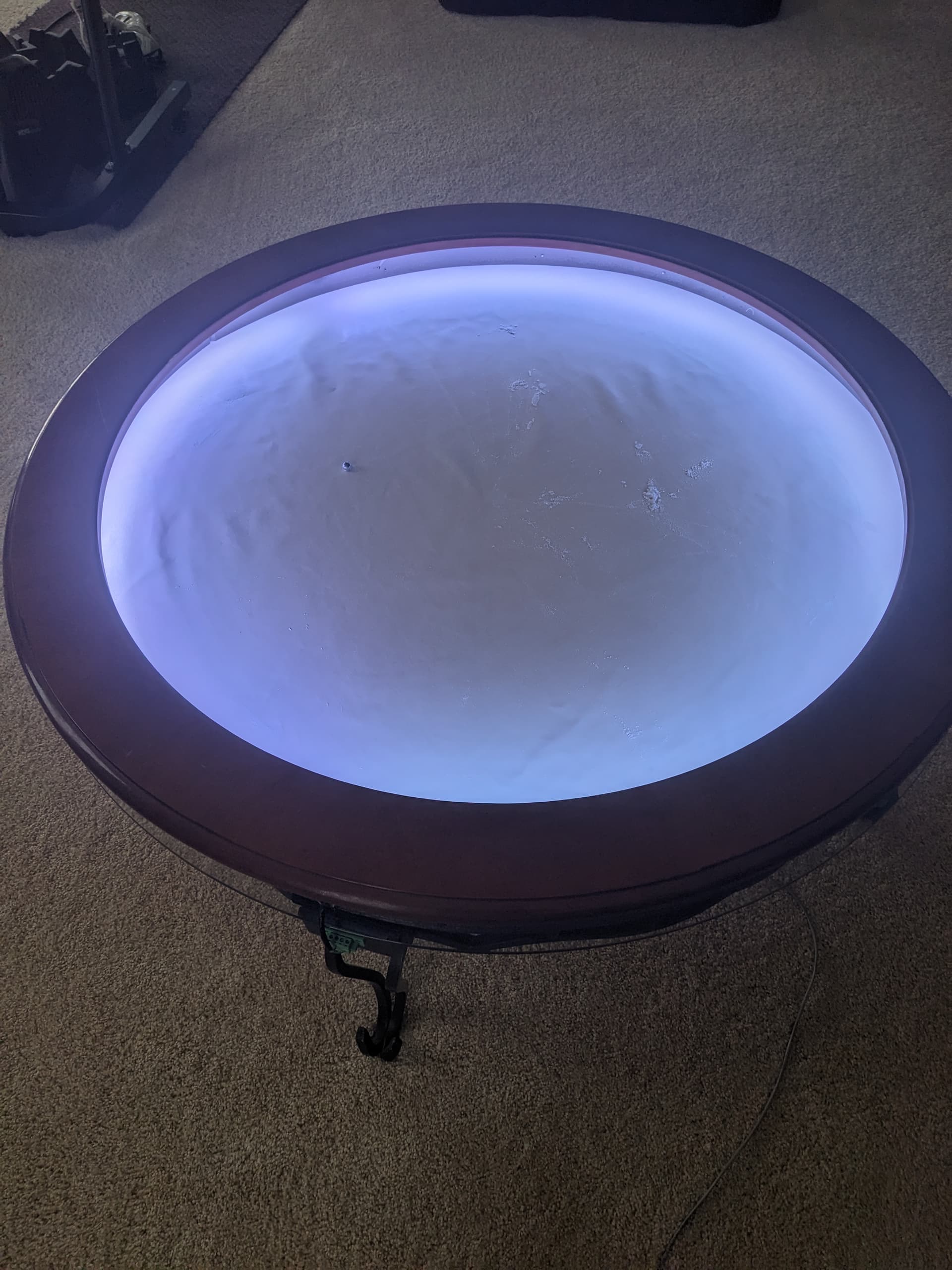

The lights are under this wooden ring that comes from the original table.

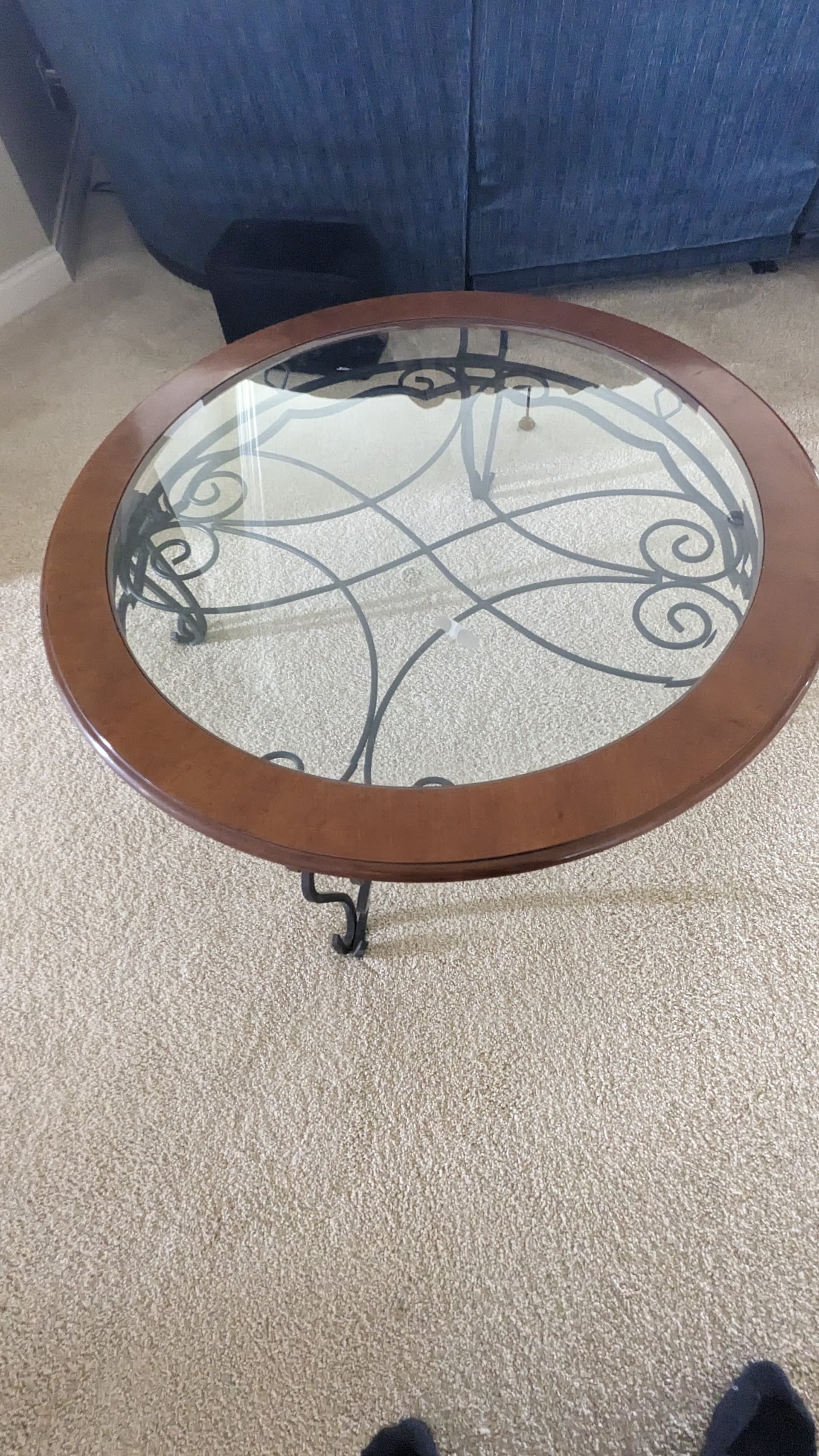

Here is the original table before I started modifying it. Also from the marketplace.
That looks awesome!
Thanks. The table itself started off looking pretty nice and I just tried not to make it too much worse.
