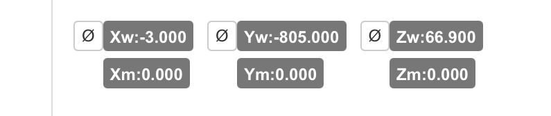

It seems that any time I shut down power to the LR4 and start it back up, that position is marked as Y:0. If I jog it back to the actual 0.0 Home position, the Y will be -2300 or some crazy number. With a digital scale or set of calipers, there is a reset button that resets the current position to be 0.0 without having to power down and back up. So now my question: does that “reset position” exist in the control software?

Homing and zeroing are 2 different things.
Home X and Y
Zero X and Y
Jog to x100 y100
zero x and Y
Now if you power down and move the gantry by hand and power back on again how does the controller know where it is? It can’t. Till you home x and y again.
Home x and Y and it will know that it’s now -100X and -100Y from the zero you previously set.
There is still a machine XY zero which is your homing point (plus pulloffs) but you can use the process above to set a custom x0y0 and always return to it. (actually you can set 6 of them)
You can see on the UI the machine - M and workspace - W coordinates.
Thank you for the explanation. I think I have not yet properly establish the machine XY and the correct pulloffs so it has no clue where it is anytime it turns on and therefore thinks that home is where ever it woke up.
