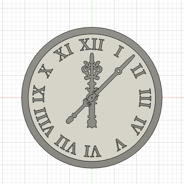

In a month we have a musical “Ciske de Rat” and the director wants a really big… clock, so I went ino Fusion and designed a clock that resembles the clock of Amsterdam Central station.
The outside diameter is 3.15 meter, my calculator tells me thats 10ft 4 Inches in ancient units, so a one part clock is not possible.

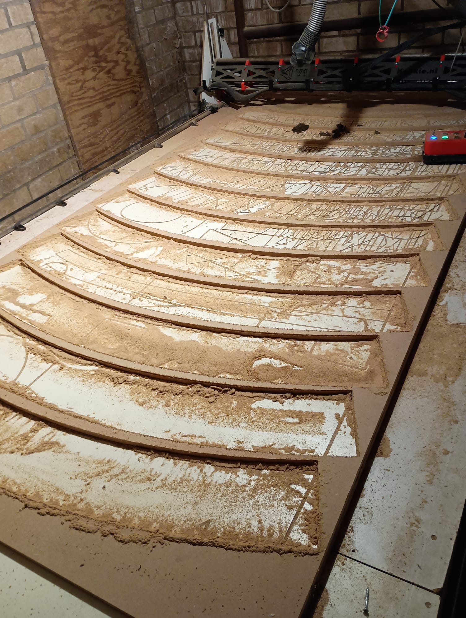

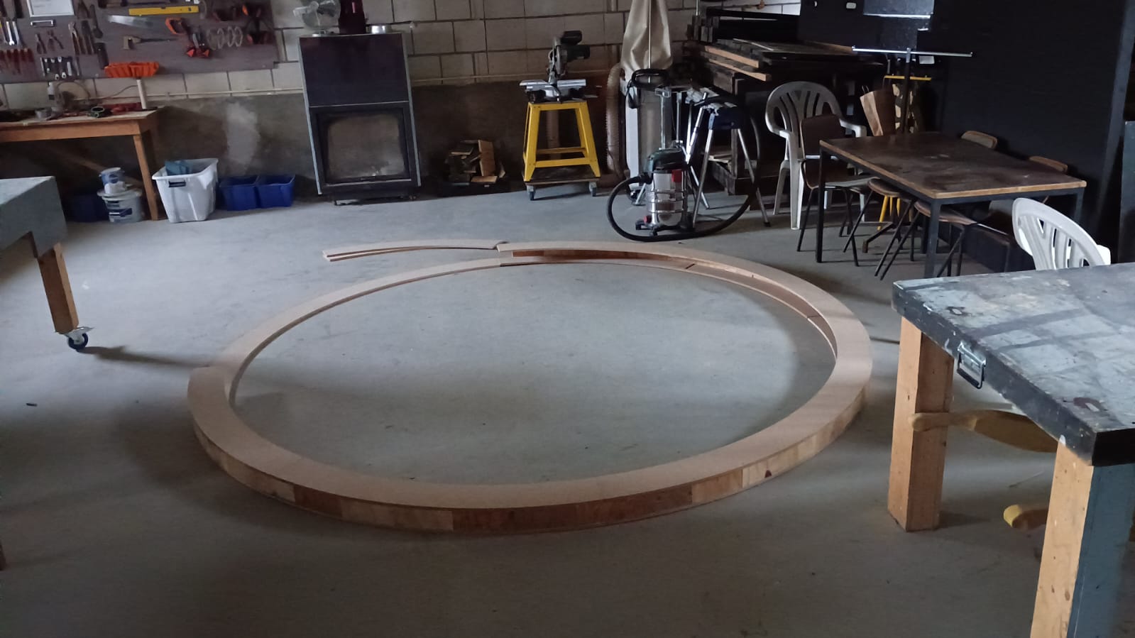

So i made cut the circle in 8 to make parts, 13 out of a sheet of MDF, i need 16 to make a double ring
Not my own workplace BTW, but from the musical association I’m one of the set builders.
Remnants of some milling with my lowrider3

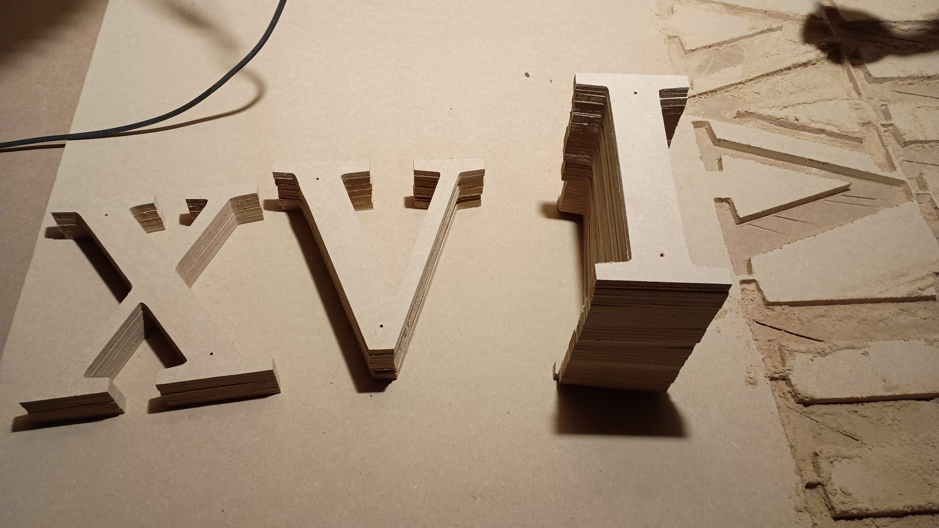

some Roman numerals

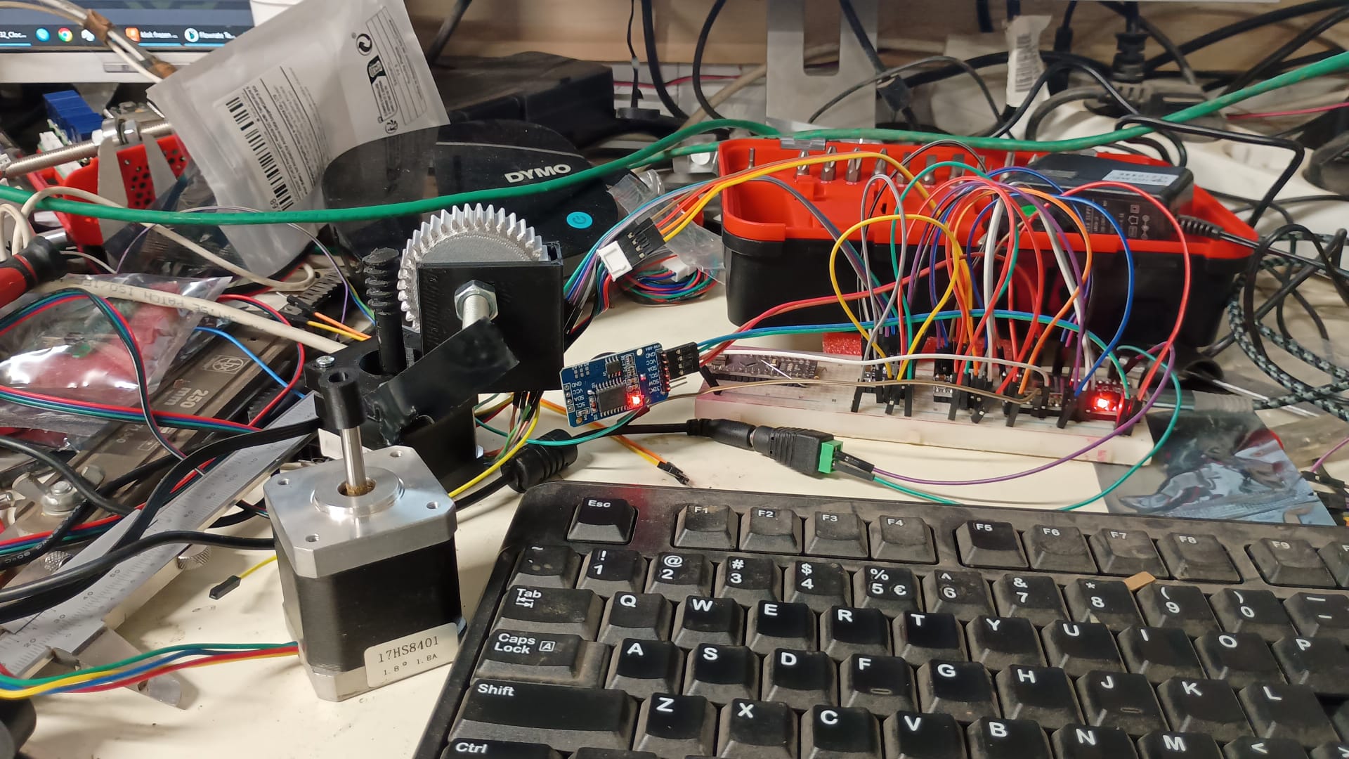

The electronics on a breadboard (wonder if it ever comes of the breadboard…)
I made the program with help from chatgpt, it still cost me a couple of long evenings…. I wanted to be able to use NTP, manual time, Streaming acn and DMX, but for now ditched the latter two.

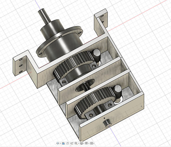

Here the clock mechanics, printing just now:
Two nema17 steppers with wormgear and gear

Second picture is a clock ring. Is it going to be a big, black clock? :joy:

Yours is a very cool clock. I’m very interested in the mechanism.

The angle between midline of the clock and the letters is intentionally, so i can take the clock apart easilly. Otherwise the letters would cross the seams when taken apart for transportation.

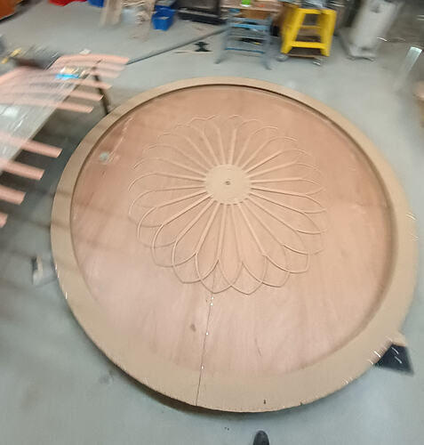

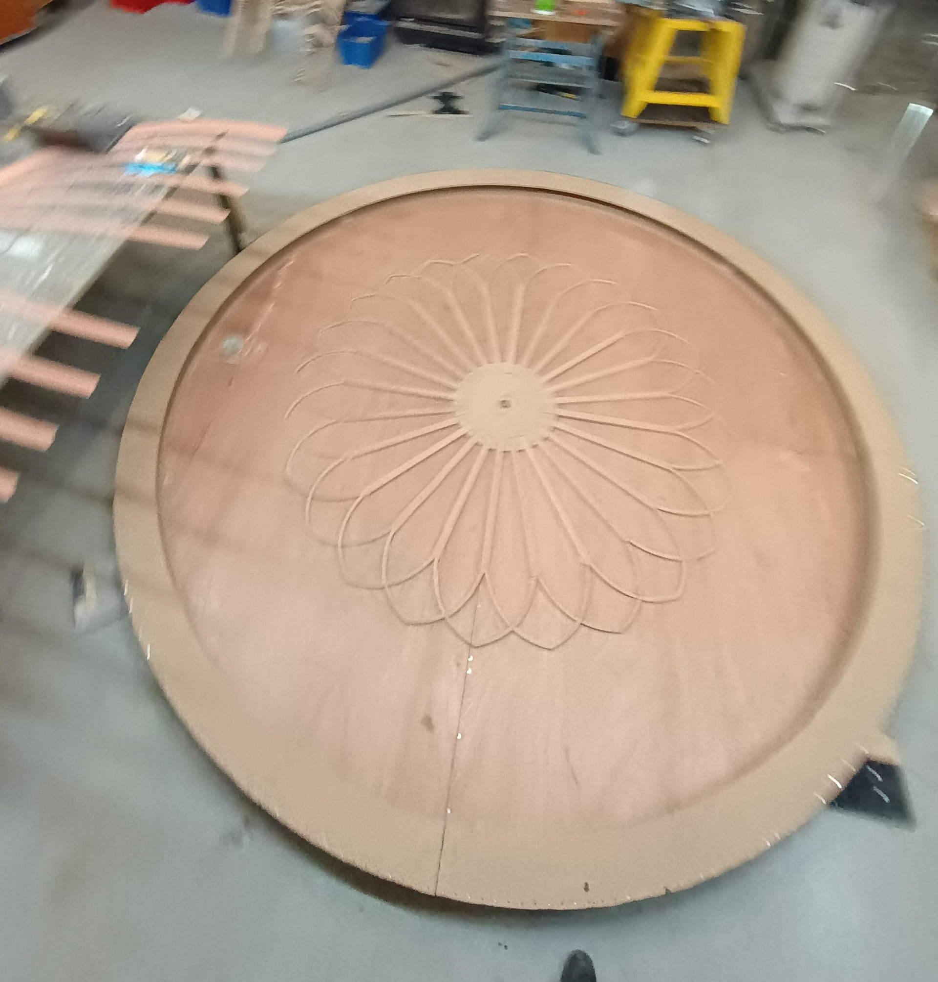

A littlebit further again. It doesn’t look like it, but the ornament in the middle is perfectly spaced in the middle of the clock. Hopefully it gets painted tomorrow. Just a week to go and it will be in the musical!

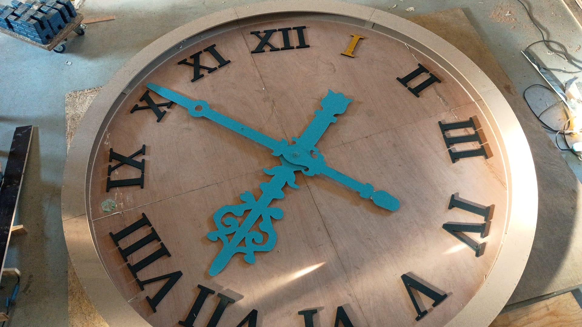

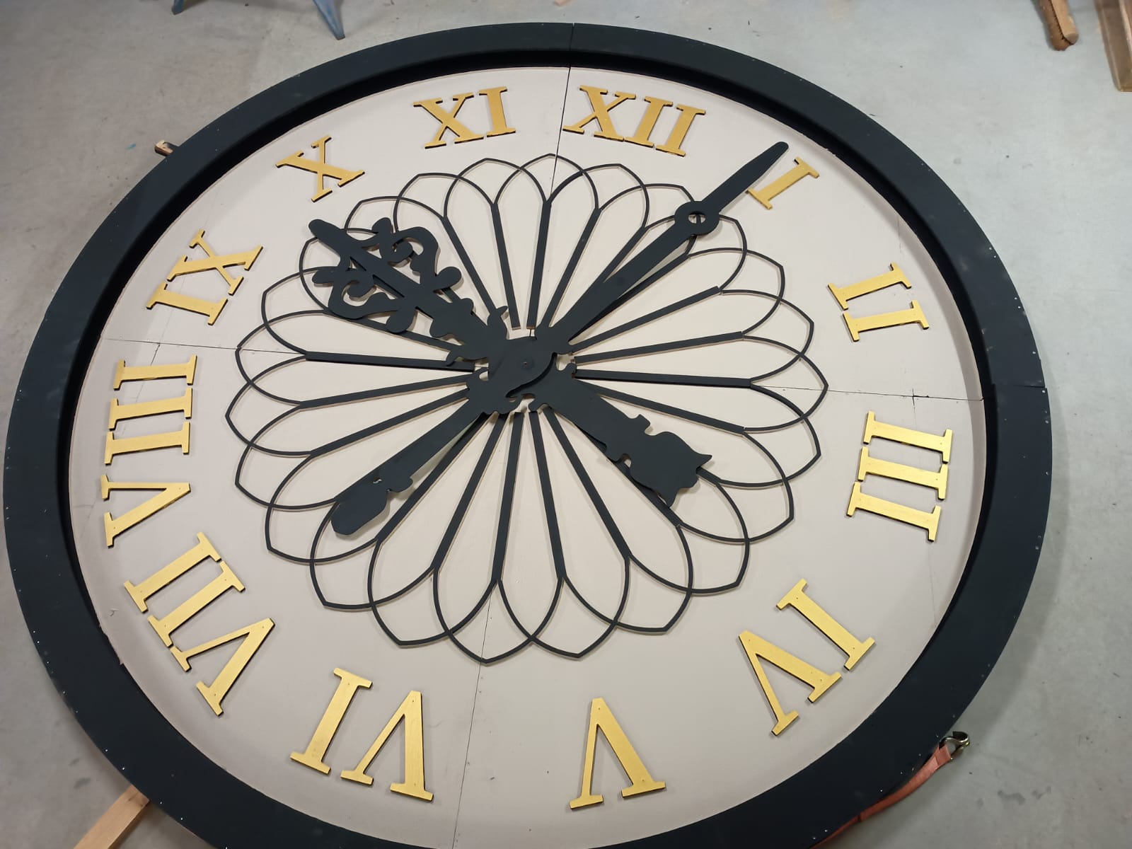

And a bit more work done. The roman numerals are not screwed down yet and the hands of the clock are not connected to the clockwork. I doubt whether the hands should get a golden tip
Maybe white?

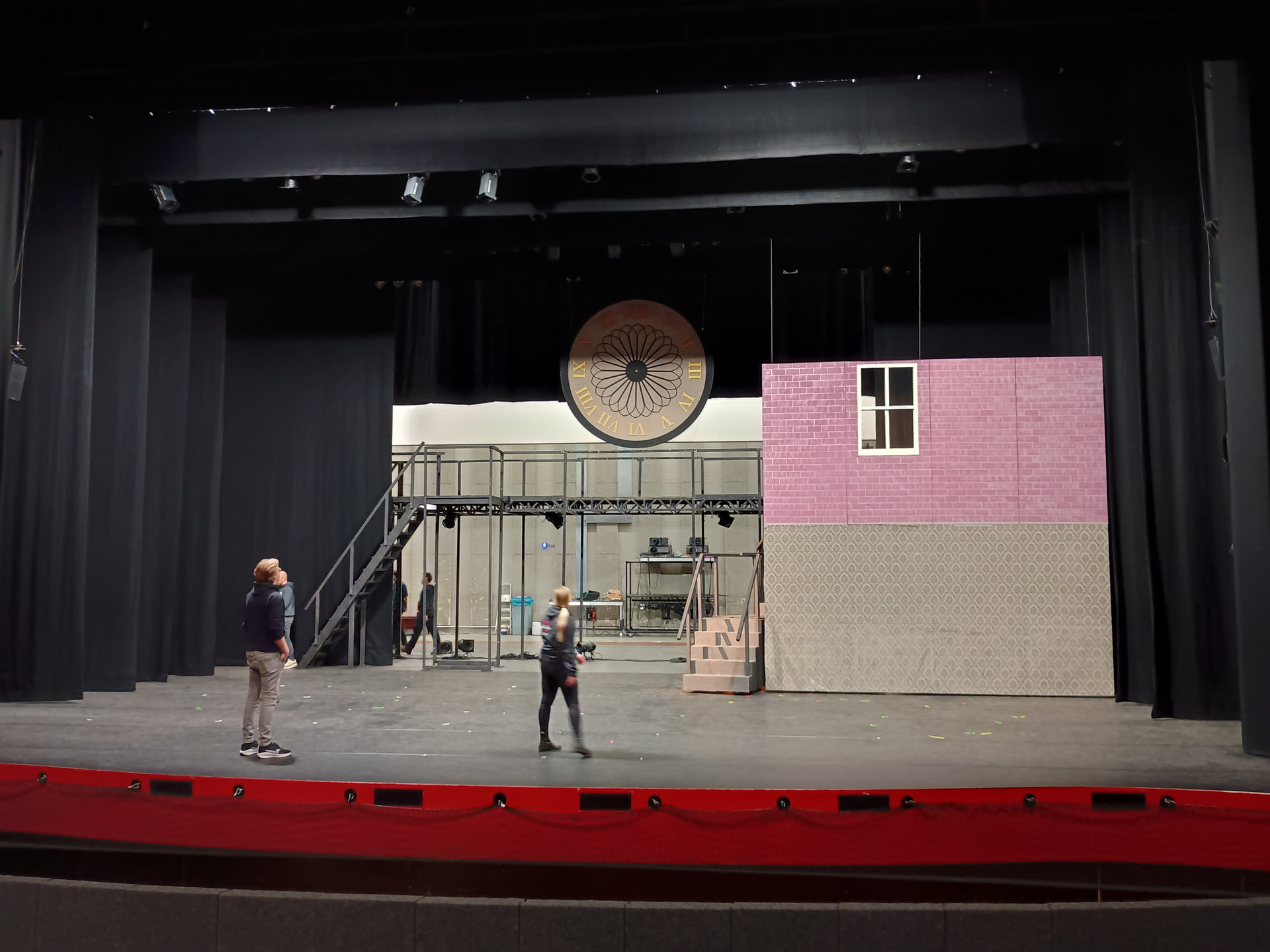

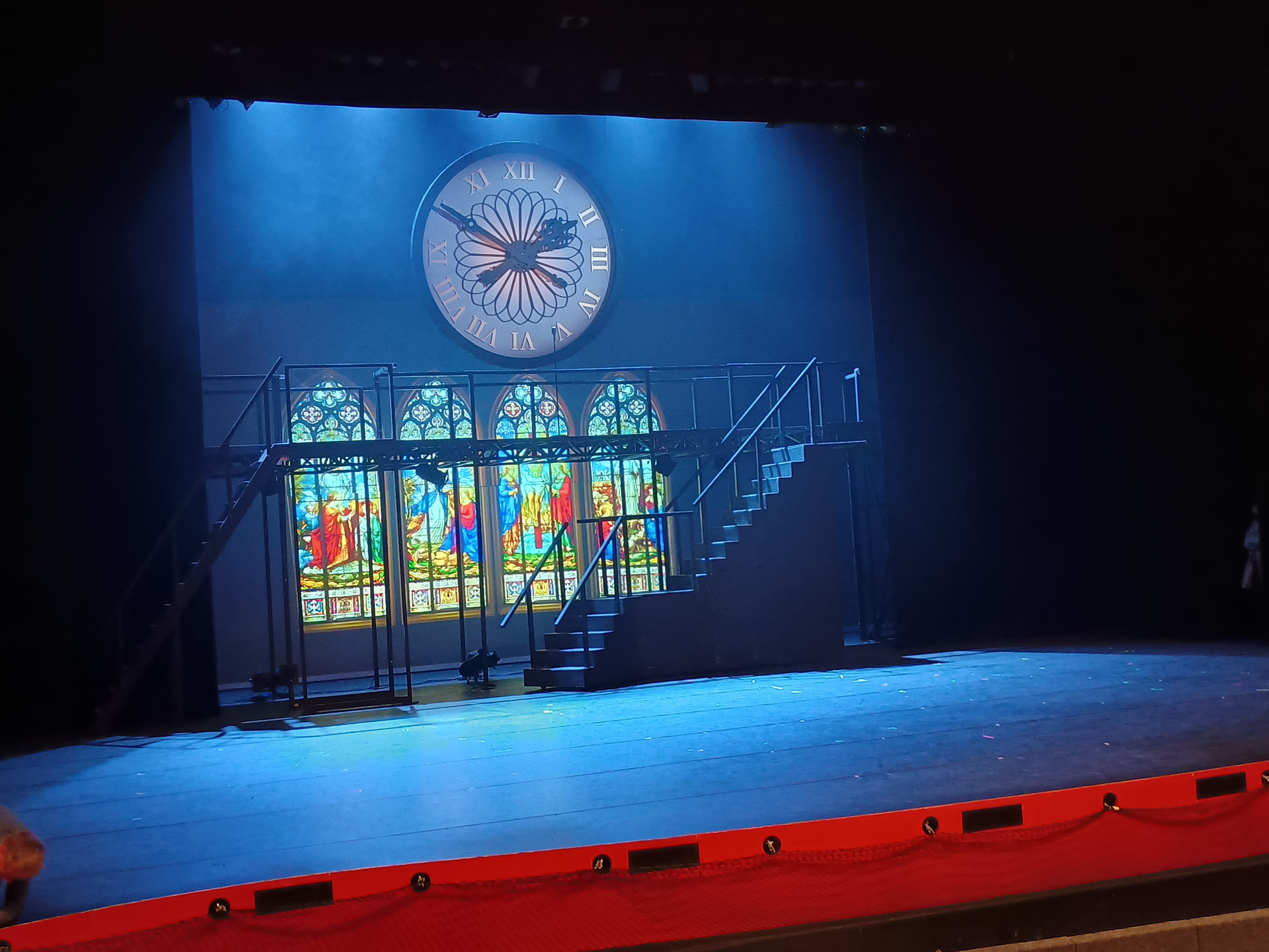

It’s in the theatre!
Its certainly drawing attention! Looks good.
