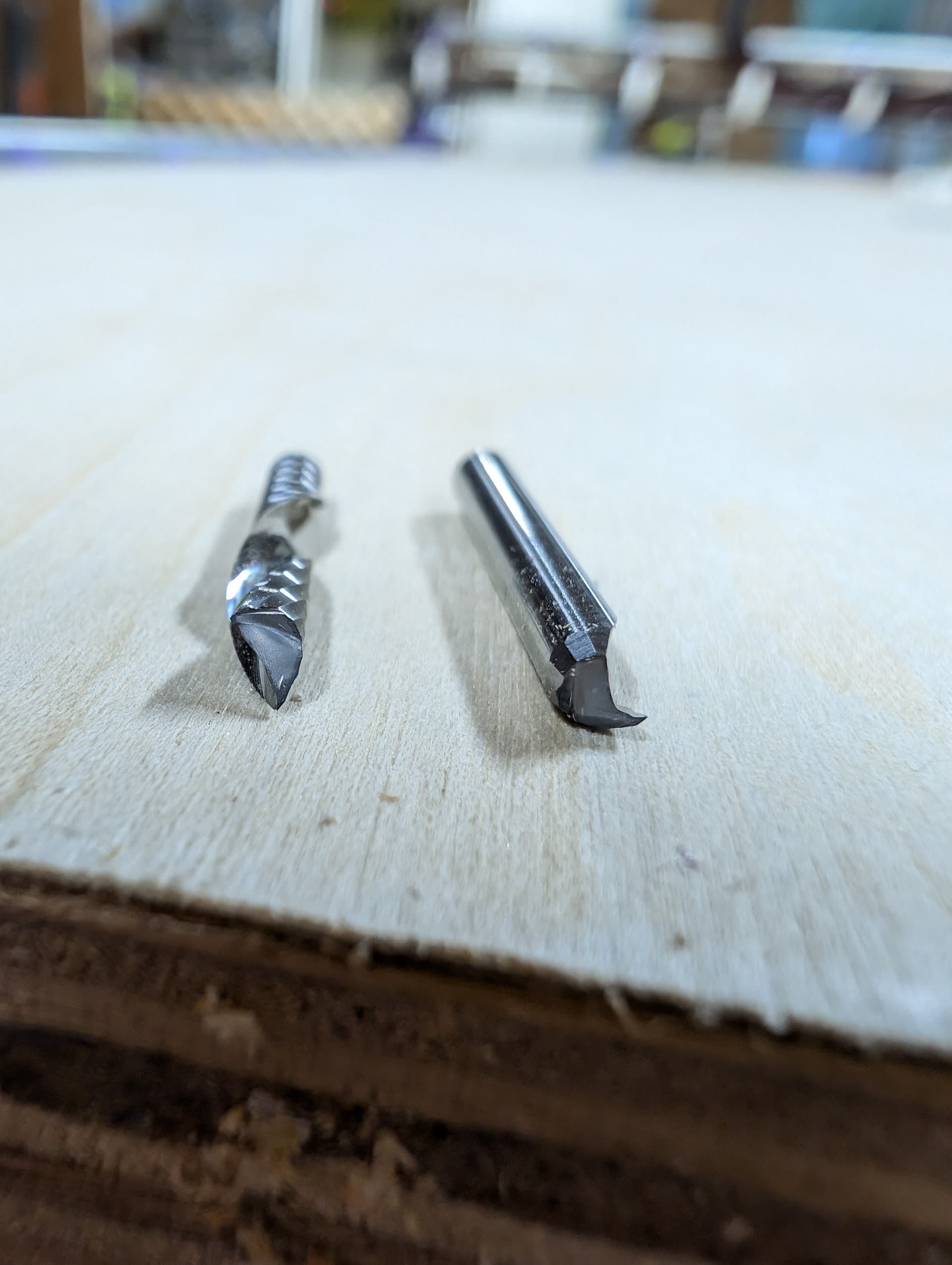

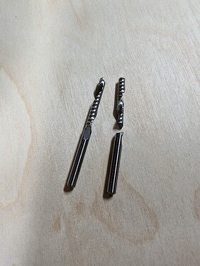

Brand new bit running at the settings below, broke while doing a pocket cut. At speed 1 on the Makita router.
I don’t know if anyone can read the tea leaves of this bit, did I do something wrong or did I just get unlucky and grab a bit that was destined to break.
New bit compared to broken bit, I don’t see any discoloration.
Snap point

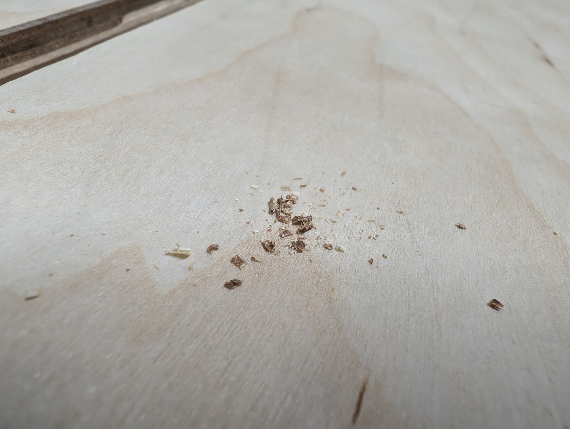

Chips seem good (I think)
If you didn’t hit something (screw or anything else) then I would think that was just a defective bit. Your settings don’t look bad. You do have estlcam set up to send that as mm/m correct?
Converting that over is just a touch over 16mm/s feed rate and a 5mm DOC. That doesn’t seem bad at all.

Plywood is in the same league as hardwood because of all the glue, I’d recommend not to go deeper than diameter x1. Rather go faster than deeper. 1400mm/min with 3 or a maximum of 3.4mm DOC (when you want to cut 10mm ply in 3 passes).

I’m more inclined to say that you were pushing that bit pretty hard.
-at 10k rpm on a .125 bit, you were only at 350 SFM. Thats even slower than one would generally run aluminum. Wood can tolerate much higher SFM which yes generates more heat but is easier on the bit due to my next point
-at 10k rpm on a .125 bit @ 40ipm, you are taking .004" chip per revolution. Thats a pretty big bite for a small bit, and those bigger and heavier chips are harder to evacuate from the flute and can jam up in slotting operations. I’d say that is a bite you would expect on a 1/4" bit. Couple that with your ADOC which is 160% of your tool diameter, you are asking alot of that little bit. once it starts to lose its edge then you are just pushing and it will break.
I would either get your RPM up, decrease your feed, or take shallower passes (then a full depth finish pass to clean up)
If it were me, I’d be running at least 750 SFM (so ~23k rpm) with that size bit. At that RPM, you can stay at ~40IPM feed, be taking about half the bite/rev. Then just adjust your depth of cut to balance load and tool life and go from there.
