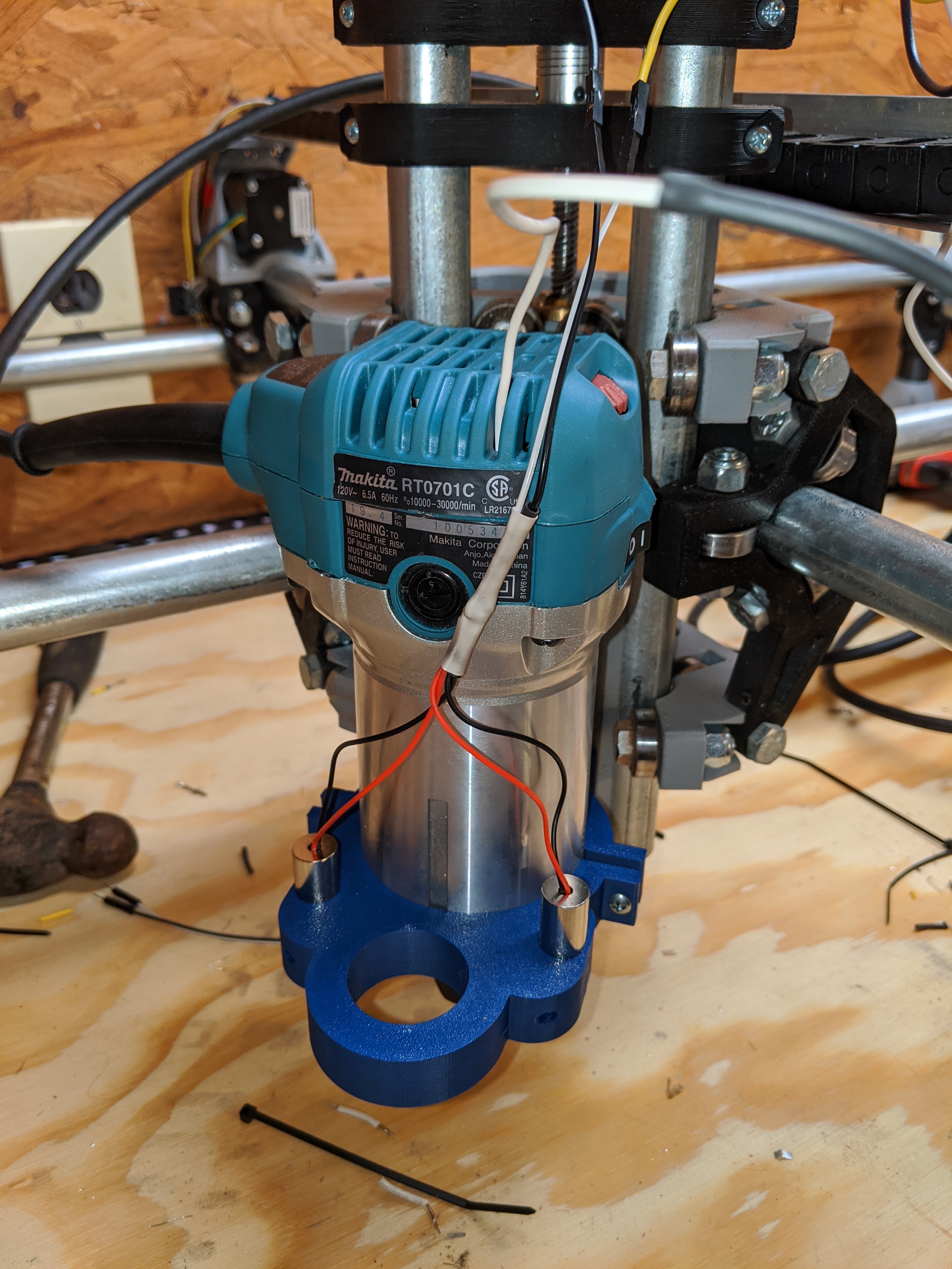

I decided to switch to Makita routers for some speed control. The DW660 worked great for me but I plan on getting in to a lot of plastic milling soon so I figured that’d be a benefit. I also wanted to do my own mount and the curvature of the dw660 annoyed me.
Some of these pics will be at various stages of development/building on either machine. There’s a top mount too but I didn’t have it mounted when I took these pics.

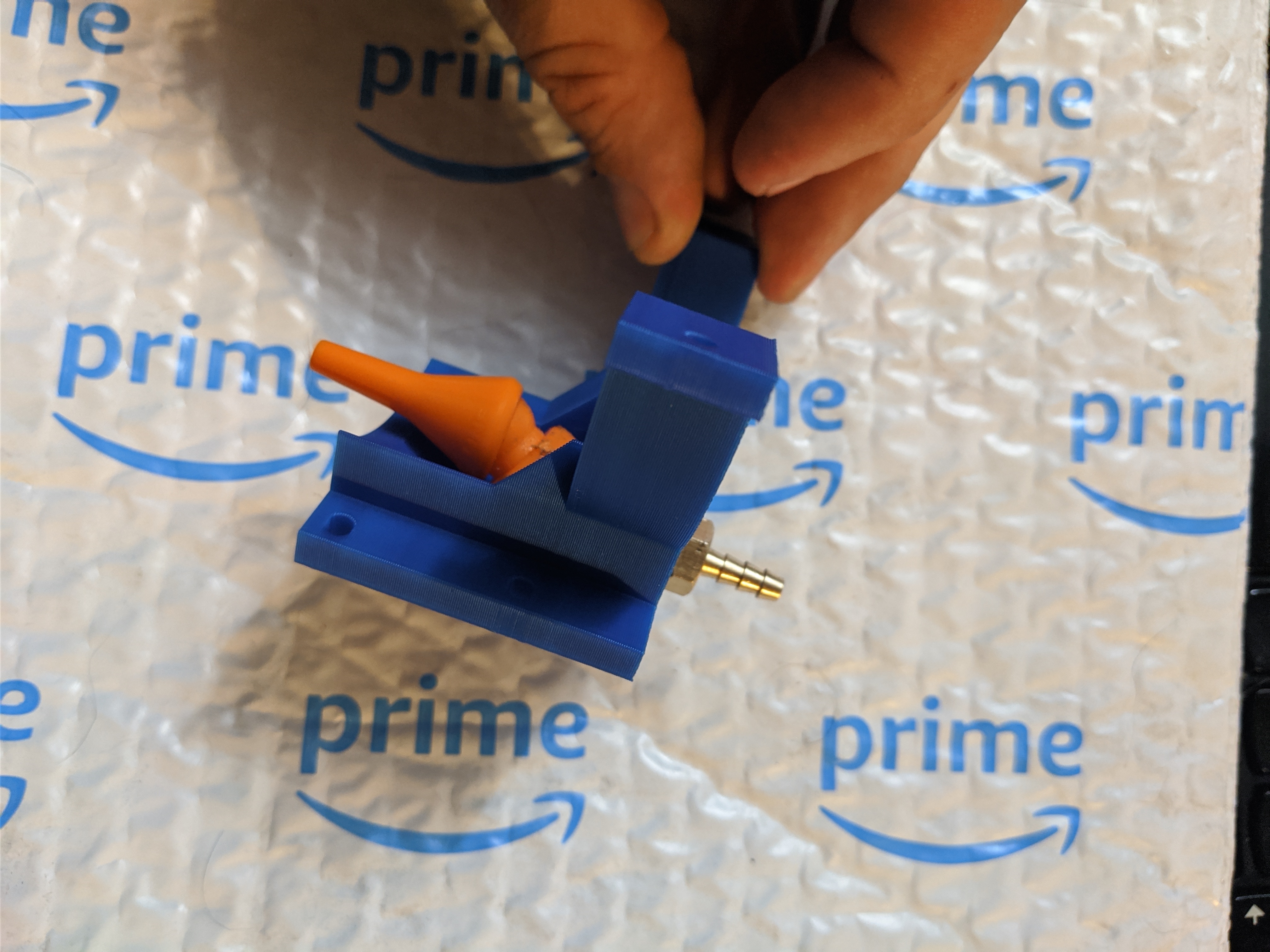

Mod #1 that I wanted was the air blast I saw someone do for the dw660 as part of the mount. That way the nozzle is always pointing where I want when Z changes. I went with a locline nozzle/fitting so I could pivot it and change the nozzle type when I want.

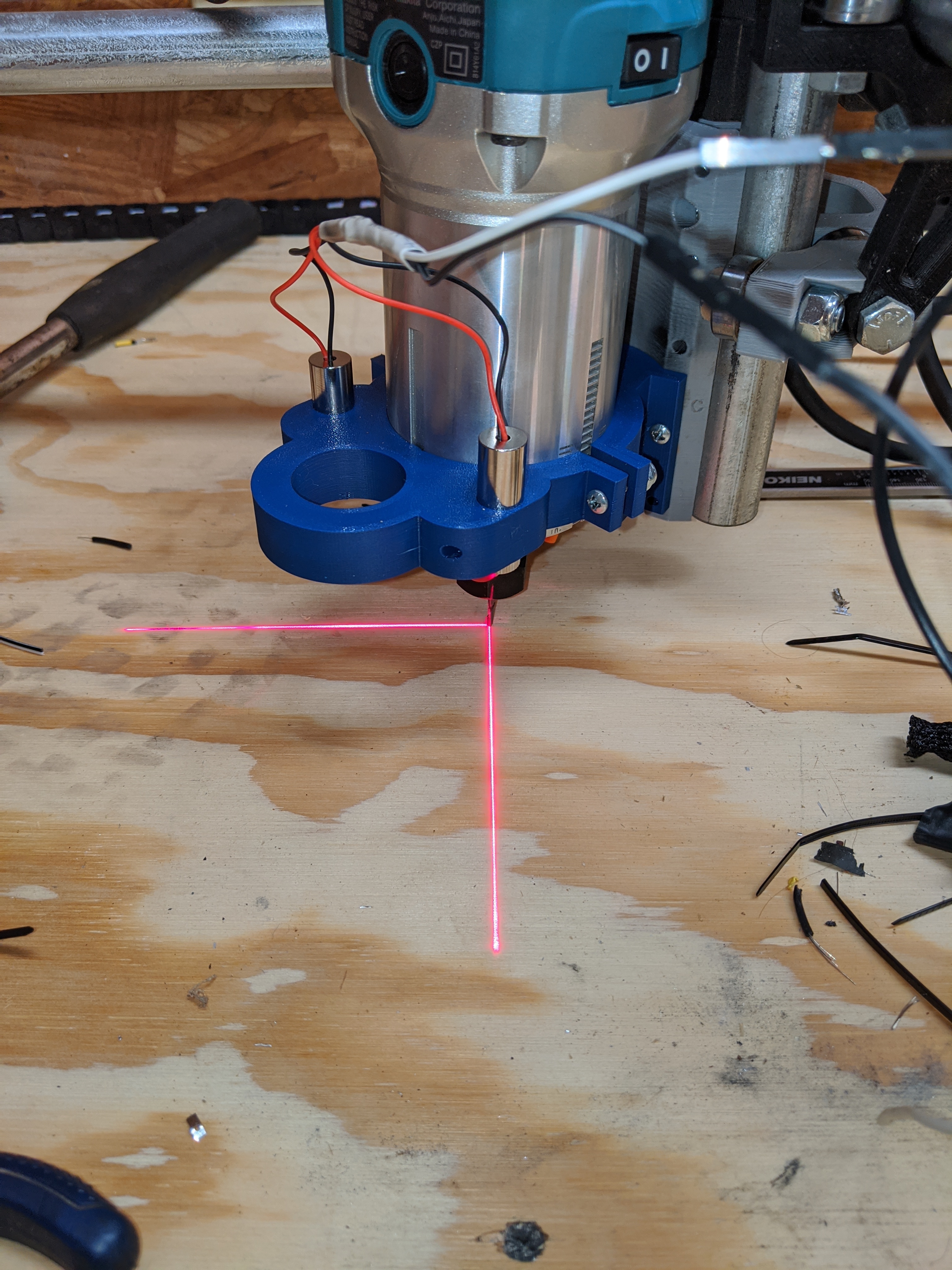

Mod #2 was crosshair lasers. I’m not expecting <=1mm accuracy out of these but it does help me place stock pieces more squarely/accurately when I need to move away from my (unfinished) brackets. I also wanted them done in a way that they’re accurate at any height, so I modeled them in to the mount.
Mod #3 is somehow permanently attaching one end of the Z probe (see the extra white wire coming out of the makita body). My dad found a bearing in the body that is press fit in to plastic. He figured out that you can just let it trap the end of some braided wire when you push the bearing in and that will conduct through the bearing, down the shaft and to the bit. No more alligator clipping the bit! I have some concerns over this being “noisy” or failing over time with tool wear but so far it seems rock solid.

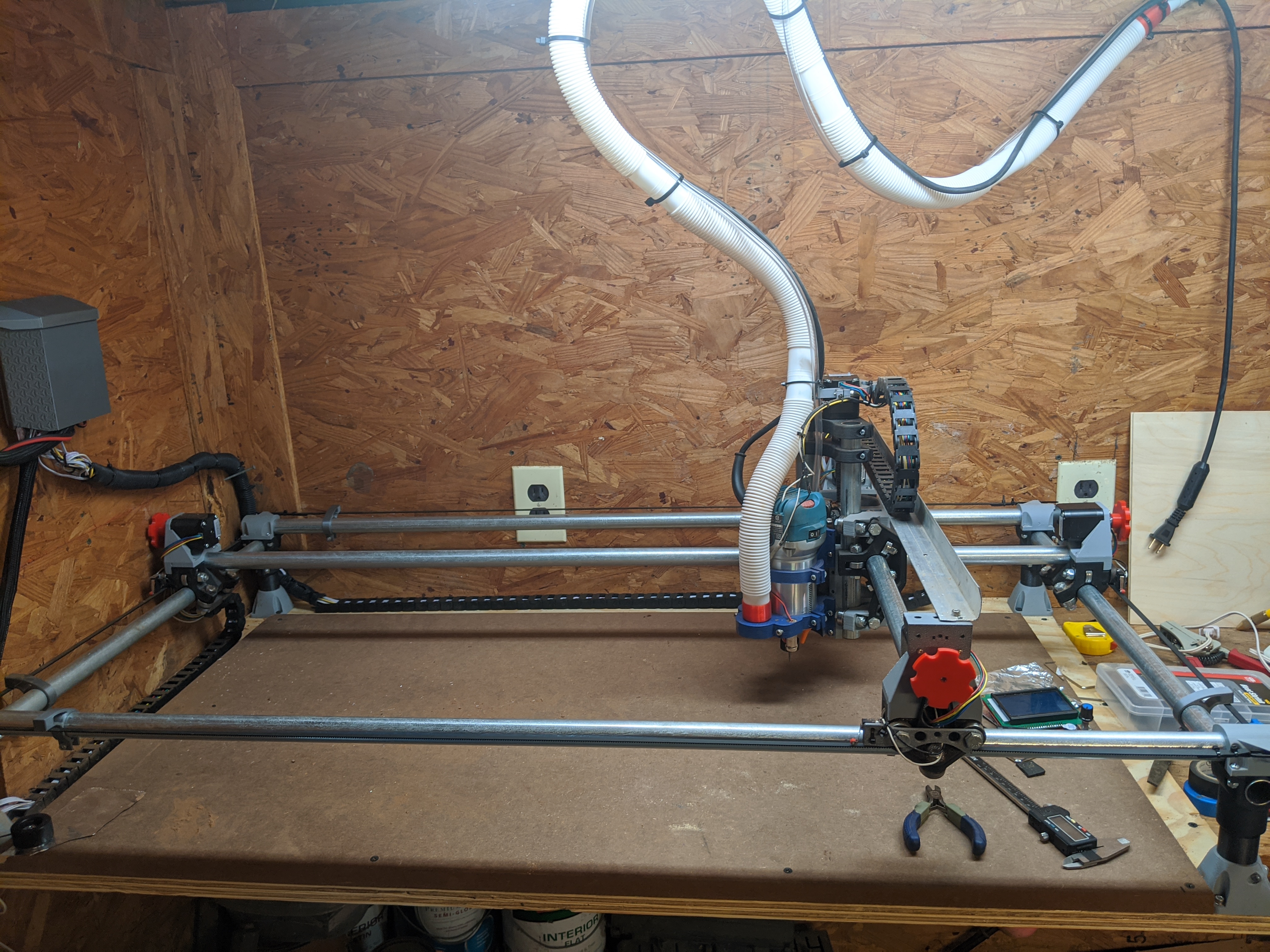

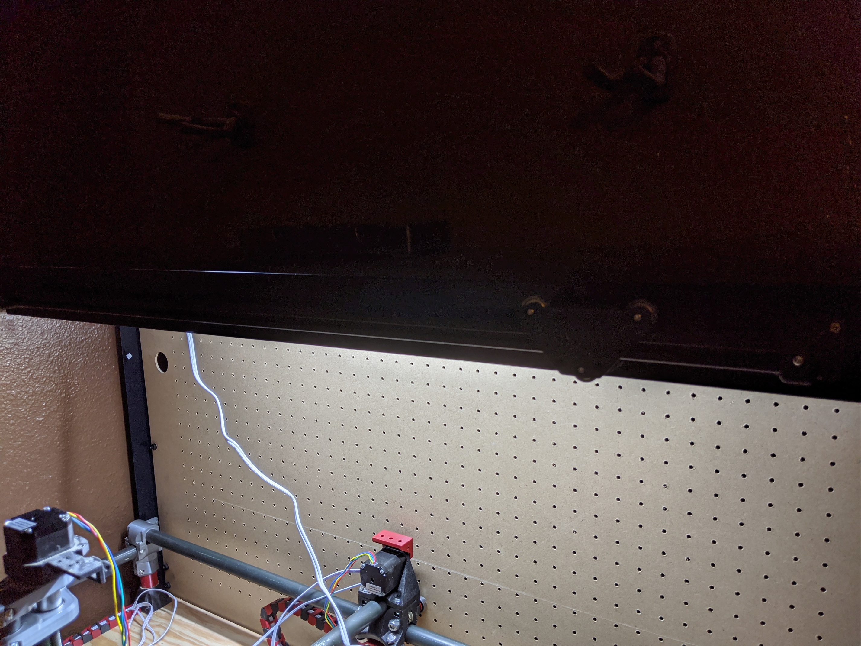

That worked better than I expected. On one, it hangs from the ceiling, on the other it attaches to the table (pic later on in post). It is to attach my vacuum, air and router power lines to. This way I don’t have to leave a ton of slack in those lines for the gantry to move around and it keeps them where I want them. So far it feels really smooth.

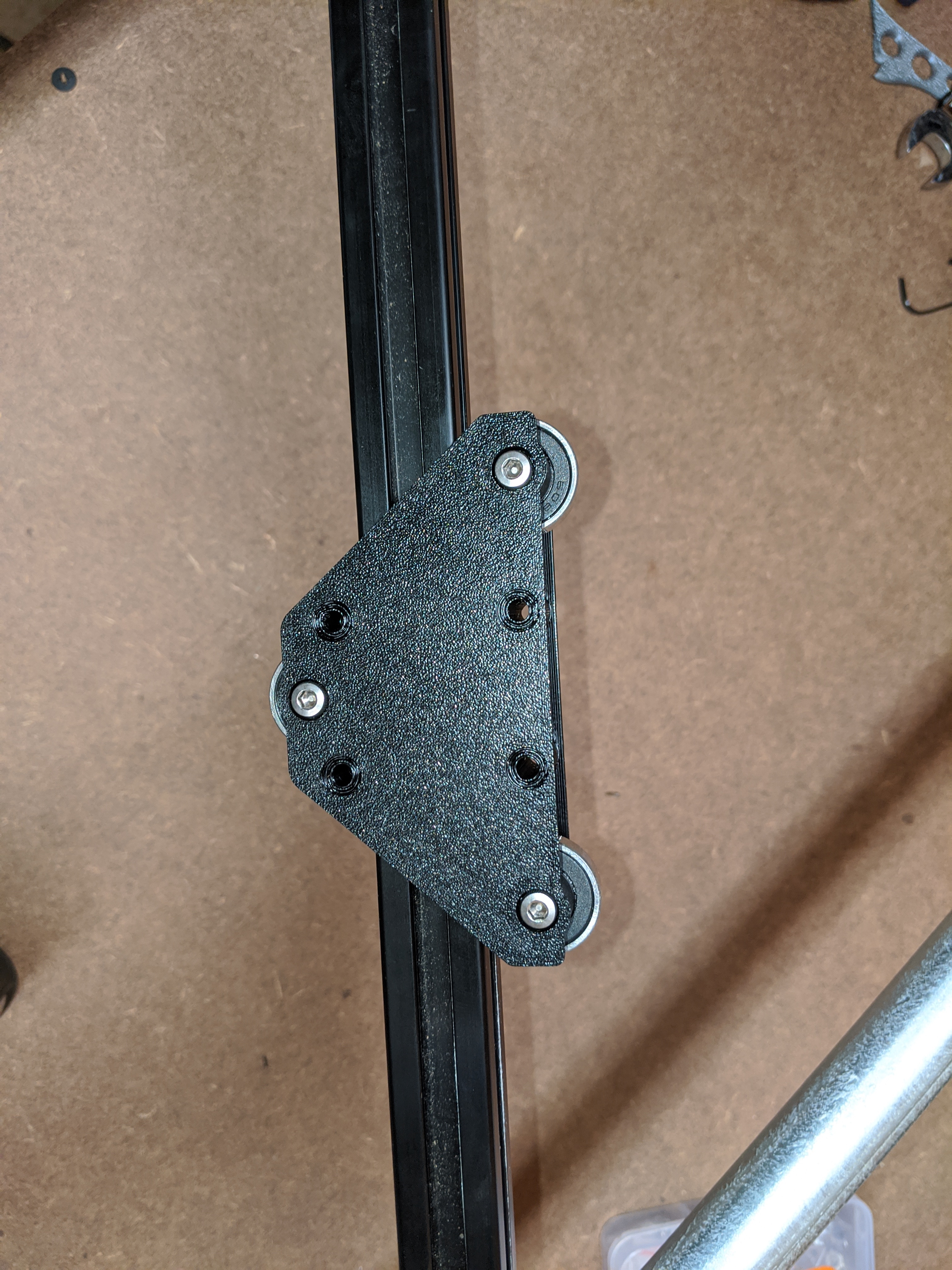

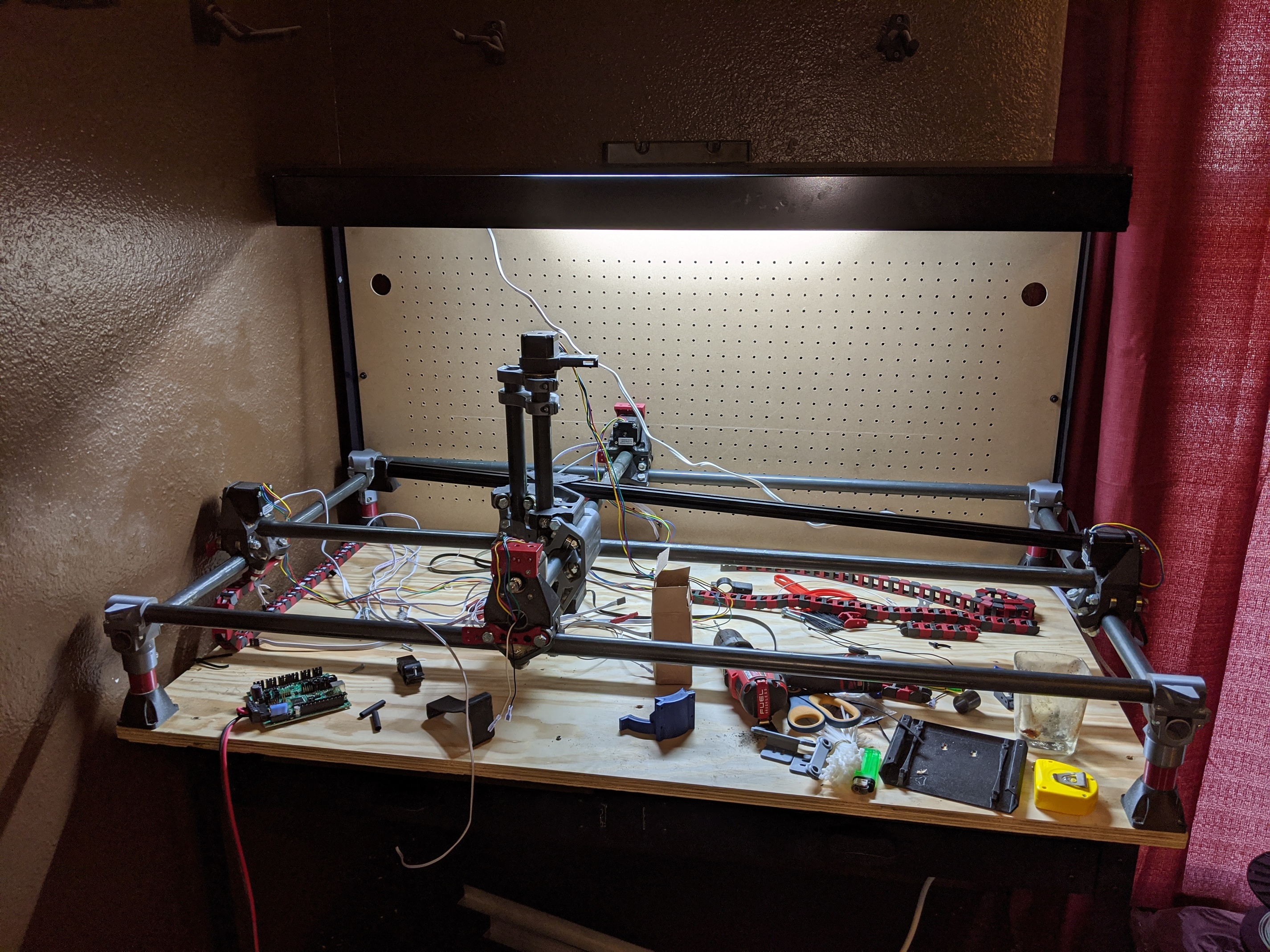

Early in the process of the second rebuild, going on a harbor freight workbench (99 bucks!). It is what determined the shape/size of the rebuilds quite a bit. I’m happy with it so far. I hung over the front a couple inches. There are some flaws in the build in that pic (roller plates are upside down for one). I need to stop working on these when its late.

Air assist made a huge difference for me. Before, I was limited to about .3ish DOC before I’d start gumming up my bit. After, I can do 1mm easily, 4+mm on adaptive/trichoidal.

https://www.amazon.com/gp/product/B07888H37R was the specific line lasers I went with. I can’t give any good reason for it, I’m sure there are a ton, but in case it helps. I think they’ll be pretty nice for positioning stock. Glad you liked it! I can’t even remember where I saw something that made me want them anymore lol
Mostly complete shop mpcnc. I need to edit my top mount a bit so instead of sticking up above the backplate it stretches down so I can put two more screws in it. It has a hole for the air hose to pass through to the bottom mount and its pretty far off too.
edit: just noticed in the pic that the hoses and power cord are attached to the z stepper. Don’t lynch me, I’ll snip it loose this weekend. I’m unsure how/why we did that. Part of the reason for the rail above it was to not need to do that.
