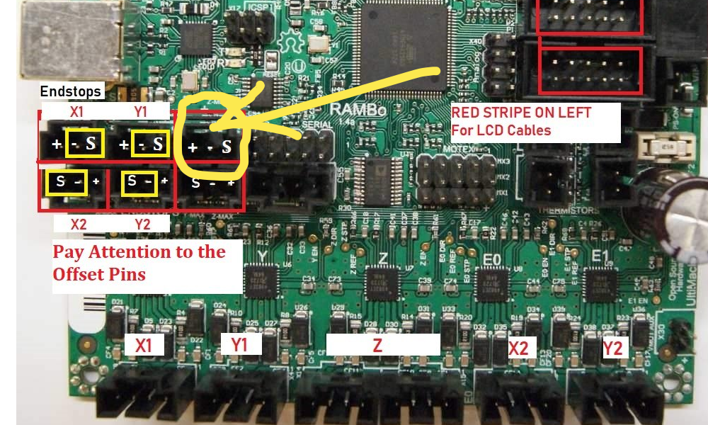

I received and built a MPCNC kit with dual end stop configuration. All is working great. I was wondering if there is an input that can be used on the board to home the Z axis. I have seen loads of YouTube videos about people using a metal plate and detecting when the tool touches it. These videos were not for MPCNC machines though.
Is this in the standard MPCNC version of firmware?Is there information on the Z axis homing techniques? Is there a method involving wires, clips and a metal plate that the Rambo 1.4 board supports?

Yup all of that will work. It is just an open endstop use the zmin port (-&S). Some fancy code for it on the basics page (Probing).
Is this where you should connect the Z probe?
There are three parts to the touch plate puzzle. First, is the touch plate itself. They are sold on Amazon and EBay and Ryan sells one in his store. I use and really like the one Ryan sells. And there are posts on the forum where people make them out of feeler gauges. It will make your life a whole like easier if you buy one that already has the Dupont connector soldered to the end. Most of the cheap touch plates on Amazon and EBay just have bare wires.
Second, is how to wire it. Ryan and Gian point the way. Just be very careful to wire it to the S and - pins and to avoid the + pin. Using the + pin can short power to ground and potentially damage the board.

Sorry Rob, I think you got caught by the fact that Trevor started this thread a few years ago, and Gian was piggybacking, asking for clarification.
Gian, yes, on the rambo, that is where you would wire it. Don’t touch the (+) pin, just the (-) and (S).
